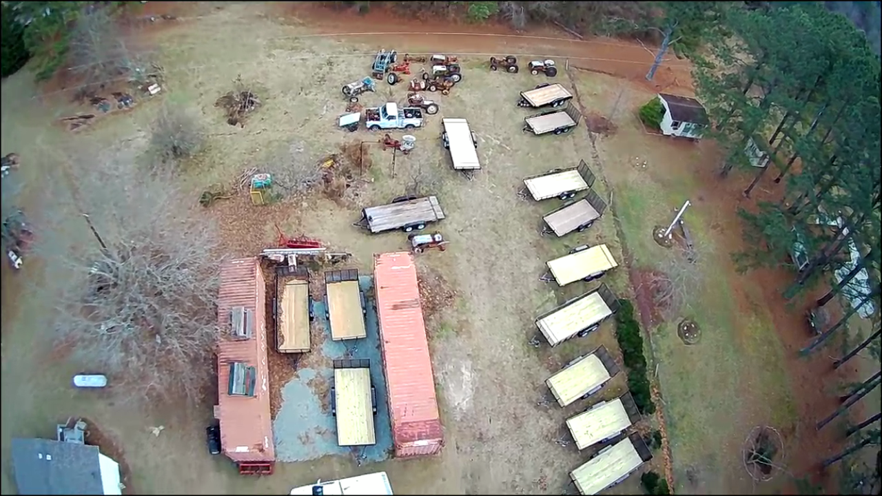

Get a High Cube roof is very high.....I got two 40 ft shipping containers Over 5 years ago HC high cube one half of container is my tool boxes other half is a 8 N ford tractor. An hour after they dropped it on the ground I had it blocked with my forklifts help and moved in all my tool boxes too and dropped in a few drop cords for power and a gas 20 LBS propane bottle with heater and presto instant work shop work with lights $2200 deliver from wilmington NC Tiger Direct .com A few days after I bought the first one they dropped the price a $100 so I had them bring another one USED of course new was like $5200 with $400 shipping..or so... My other containers has anywhere up to four ford in it at any given times ford 3000 ford two of the 8n's and a John Deere 1944 They are too hot to work in during the summer if left in the sun between 10 am and 5 pm ..... ZERO regrets on my shipping containers !!! Animal & Bug proof water proof very secure buy a heavy duty Master lock for one or both doors and privacy proof no one knows whats in it...

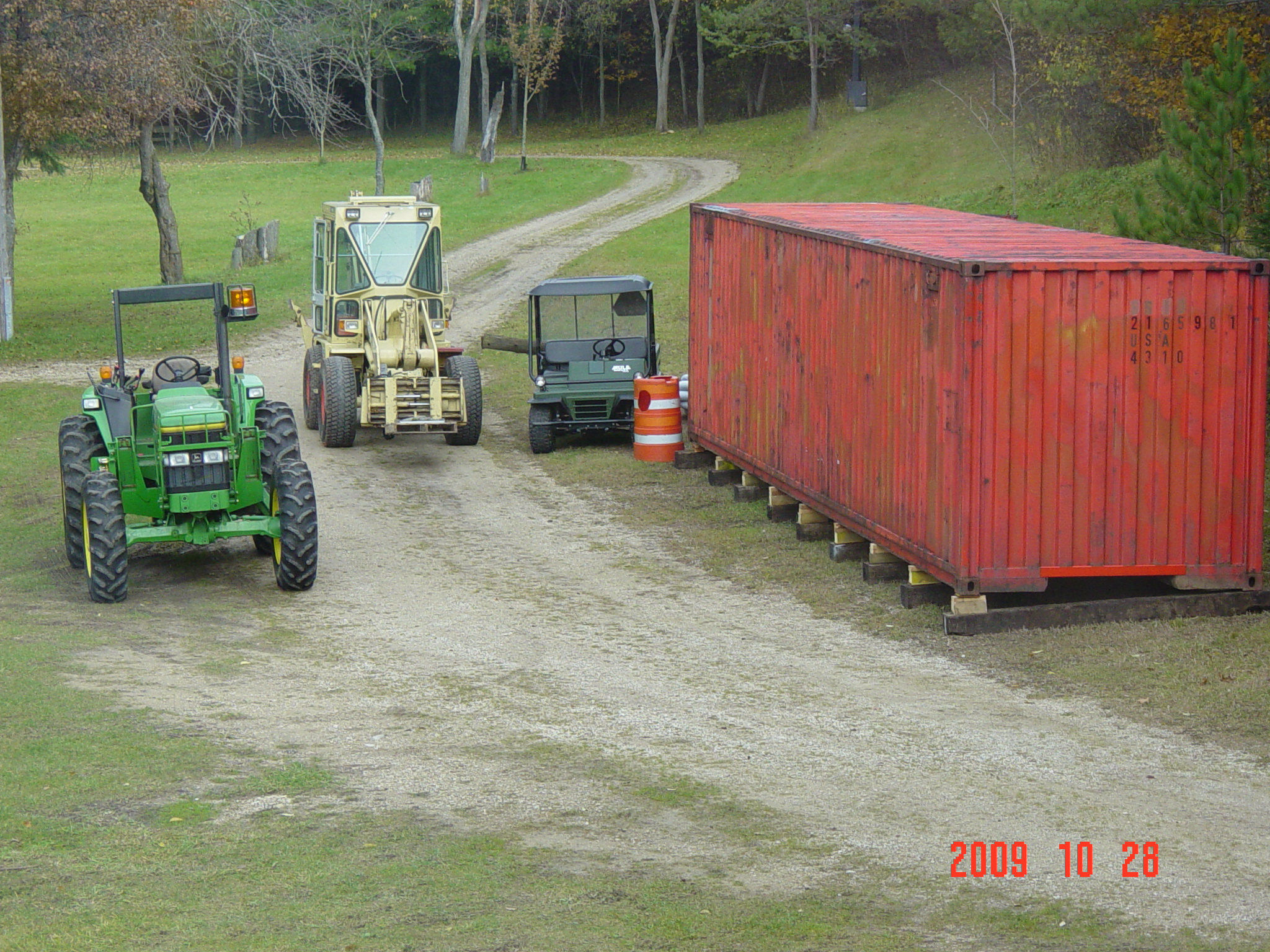

I worked for a retail company that used these for excess seasonal storage. I usually was the person to purchase and locate them on property.
If you get a good container that doesn't leak it will last for many years....painting the top with mobile home coating will reflect the heat and help keep it dry.
The only word of advice I can offer is put it on blocks to allow air flow beneath. If you set it flat on the ground it will sink. Not much, but enough to hamper door fitment create a depression in the ground that will trap water.
After that happens rainwater will collect and stay under the unit. When that starts your floor will begin to rot along with the steel structure holding it up.
Keep an eye on the humidity in the container. If the walls start to sweat you have a problem that you must take care of.
Setting it directly on the ground may seem very handy but it is a sure way to start the rust and rot issues.
