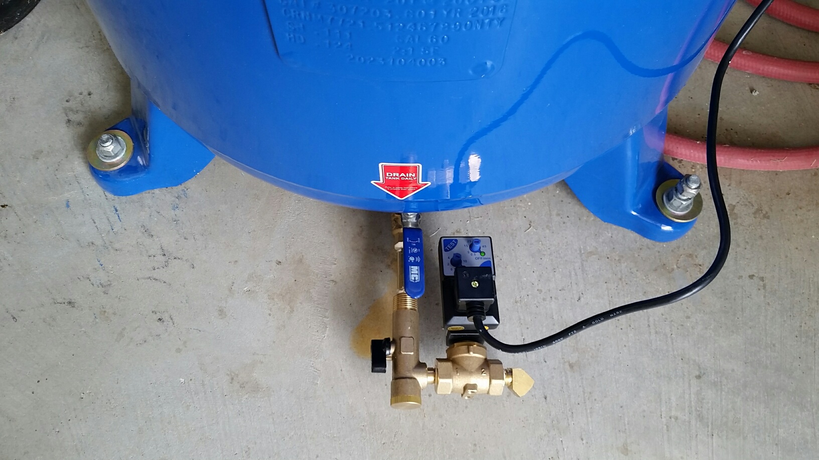

my biggest hurdle was the limited space under the compressor for the drain line plumbing.
Dear all compressor manufactures,
Spend an extra 25 cents and make the legs on your compressors taller.... if you expect the end user to drain the tank every day... make it easy!
I solved that problem on mine with a timed electric auto drain valve.
SPEEDAIRE Auto Drain Valve,Drain Size 1'/'4",4. gpm - 53DN44'|'53DN44 - Grainger
A pic of mine. I plugged the cord into a $5 power strip and secured it up high for an easy reach. I can let it run at the setting of my choice, or shut it off and on without having to crawl under it.
   / Shop Air Compressor set up questions? #100
^^^I've put in several and I believe money well spent... the oldest is circa 1995 and no issues.
