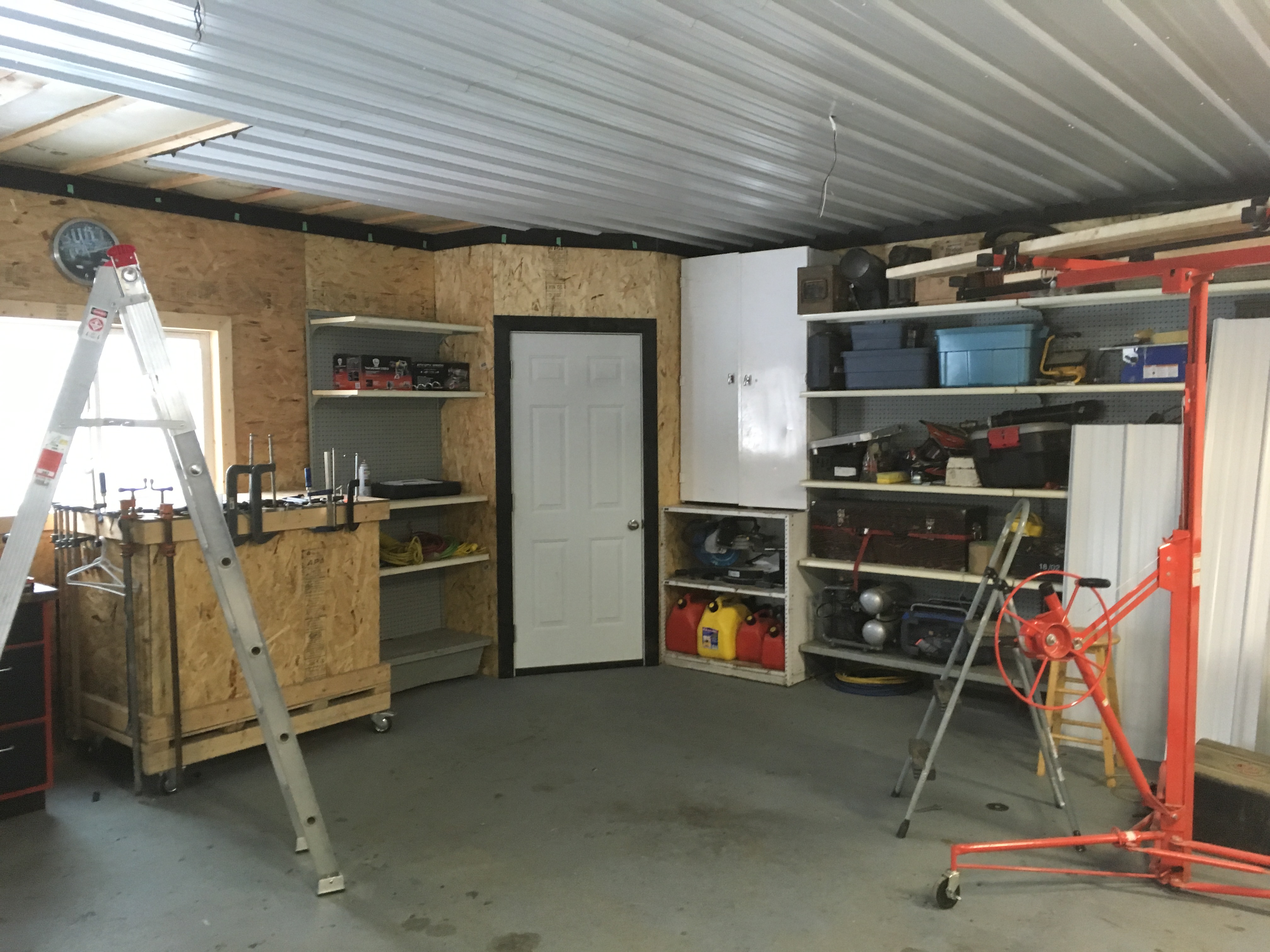

The RapidAir Maxline kit showed up. I went with this system because I couldn't justify the cost of copper. I didn't want to deal with rust in iron pipe. iron pipe would be about the same cost to install but twice the headache. PVC is a no-no and PEX isn't UV rated and I was concerned about operating it in the cold temps in my shop.
Here's a picture of the completed air compressor closet, and my almost complete metal ceiling.

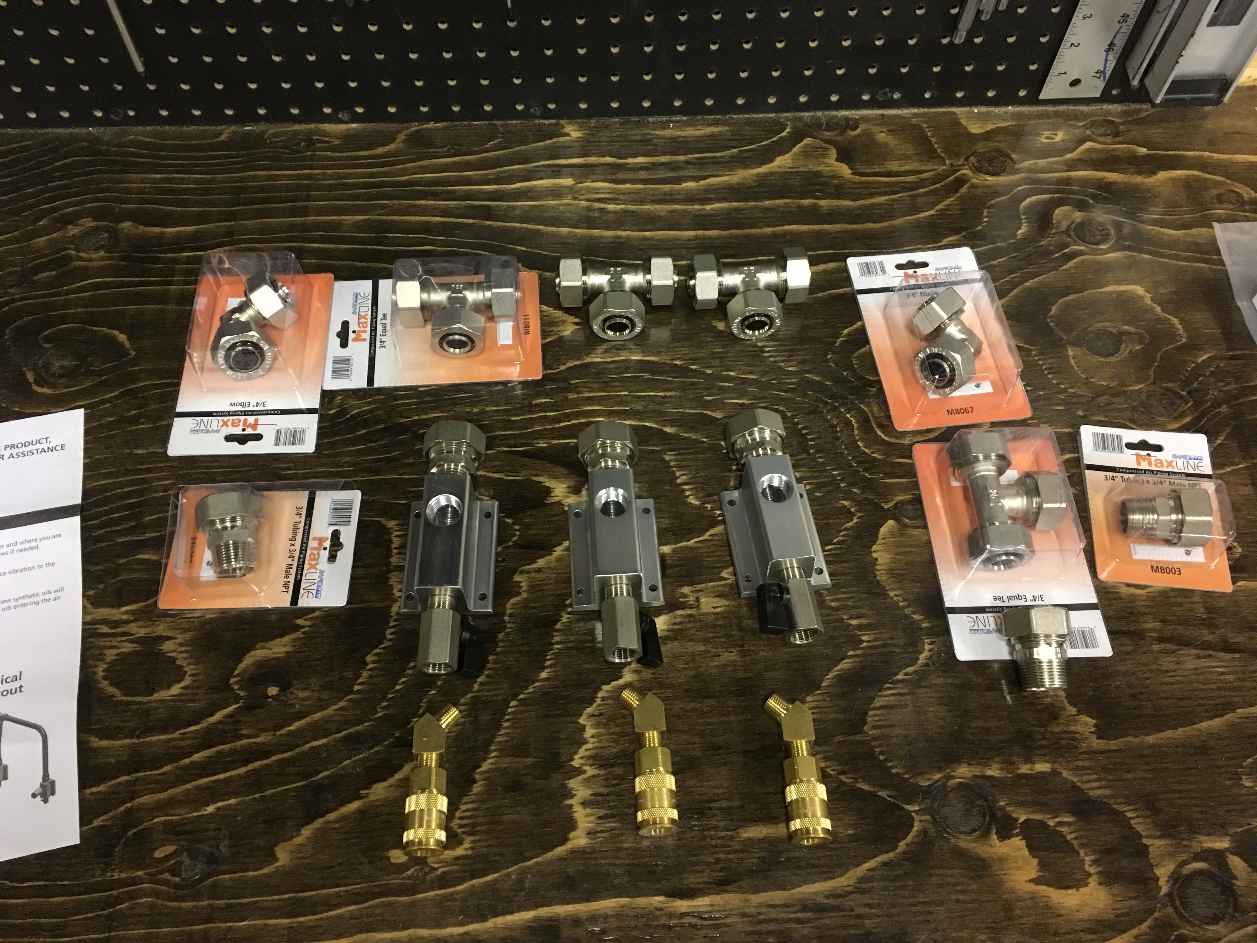

The first step was to lay out all the fittings.
I went with the 100' long 3/4" M7500 kit. but added a few fittings in order to create a 4th drop to a hose reel and to make the connection to the regulator a bit nicer.
I also used "universal" quick connects on everything. I also wanted a pressure gauge on one of my drops near the man door.

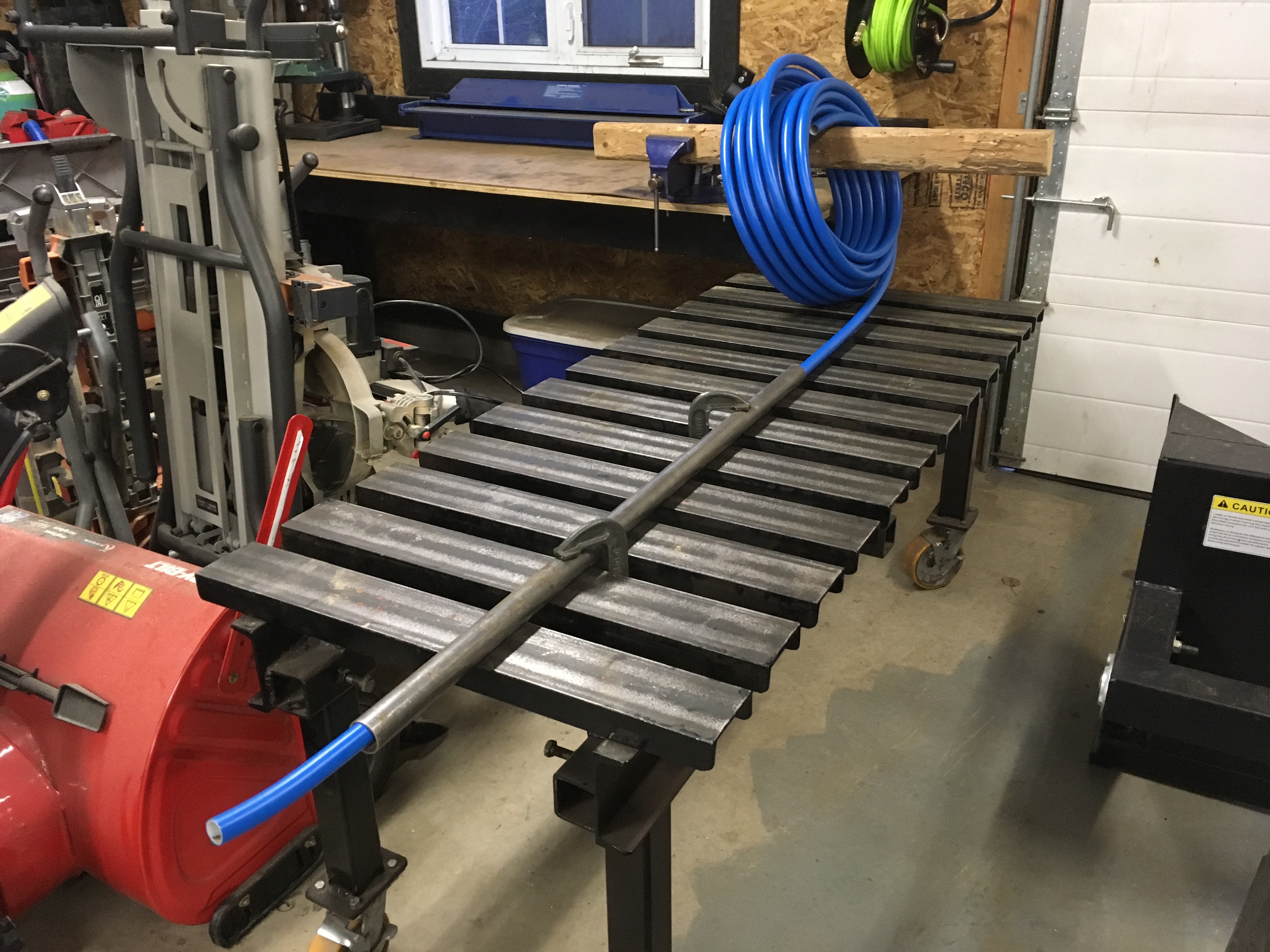

The tubing comes on a roll and is very stiff, but once you get it straight its stays.IMG_0407.JPG
That's my make shift tube straightener.

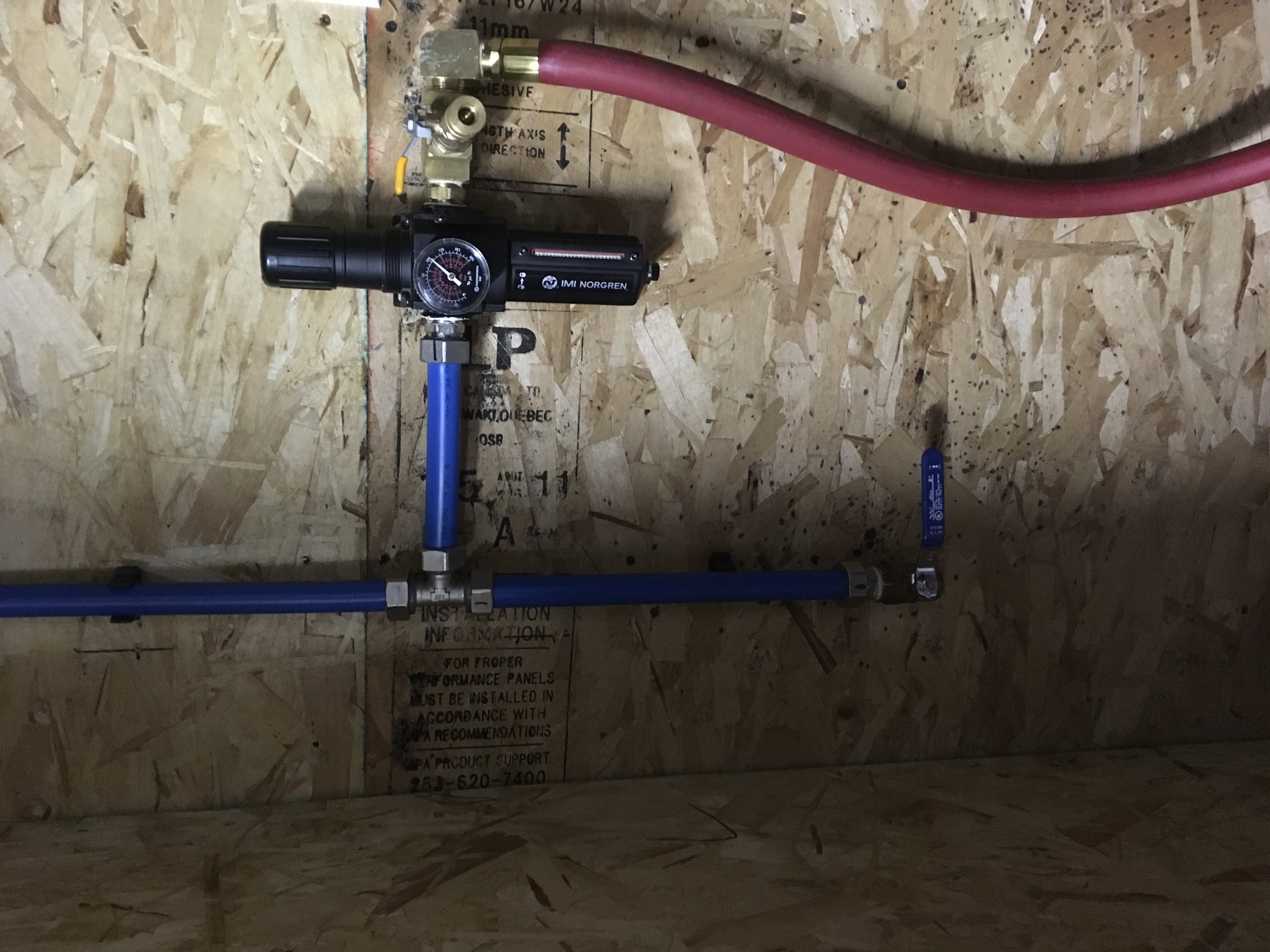

I sloped my main line down 1" every 10ft. each drop has a water drain valve on the bottom.
out of my regulator I used a TEE to run vertical up to the ceiling and down to my first main drain valve

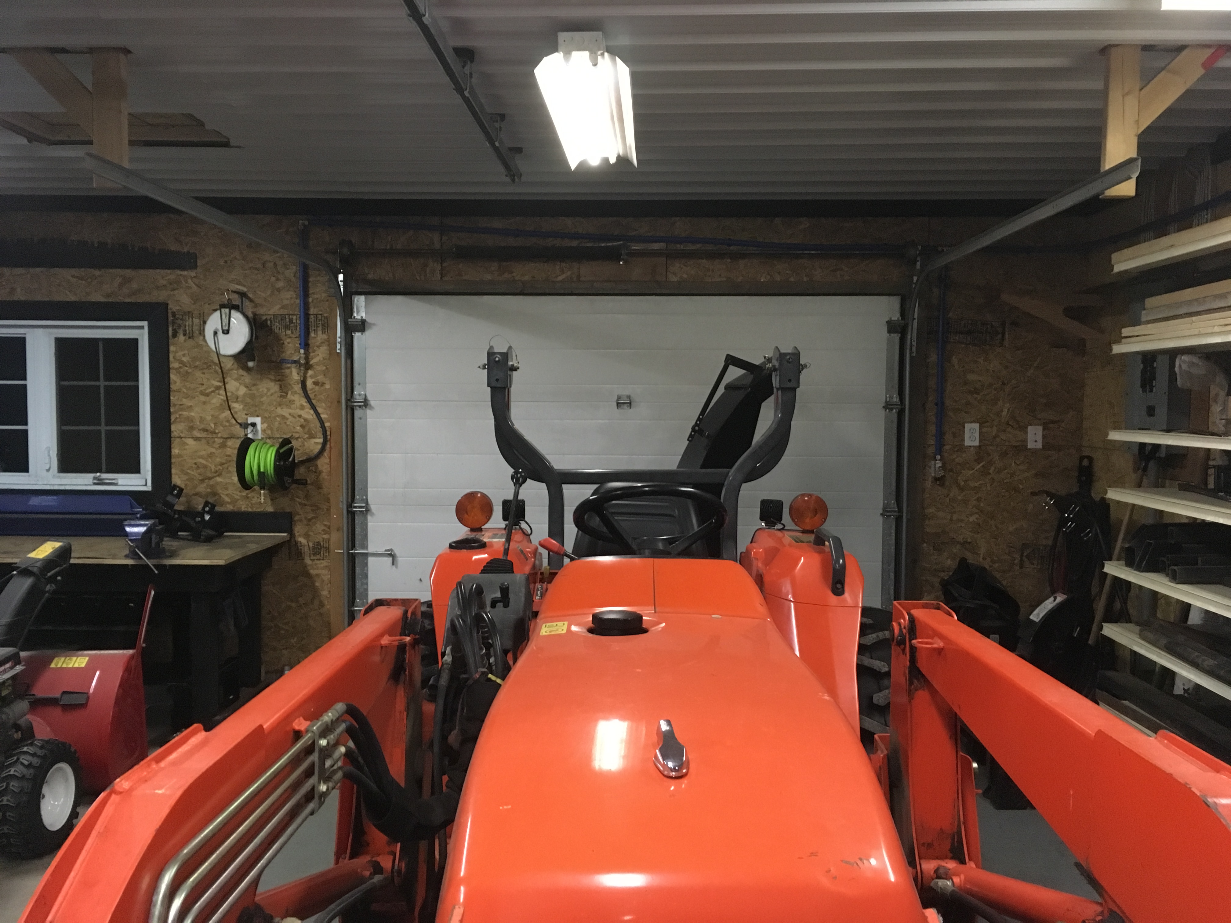

Once out of the compressor closet I did one drop over my work bench.

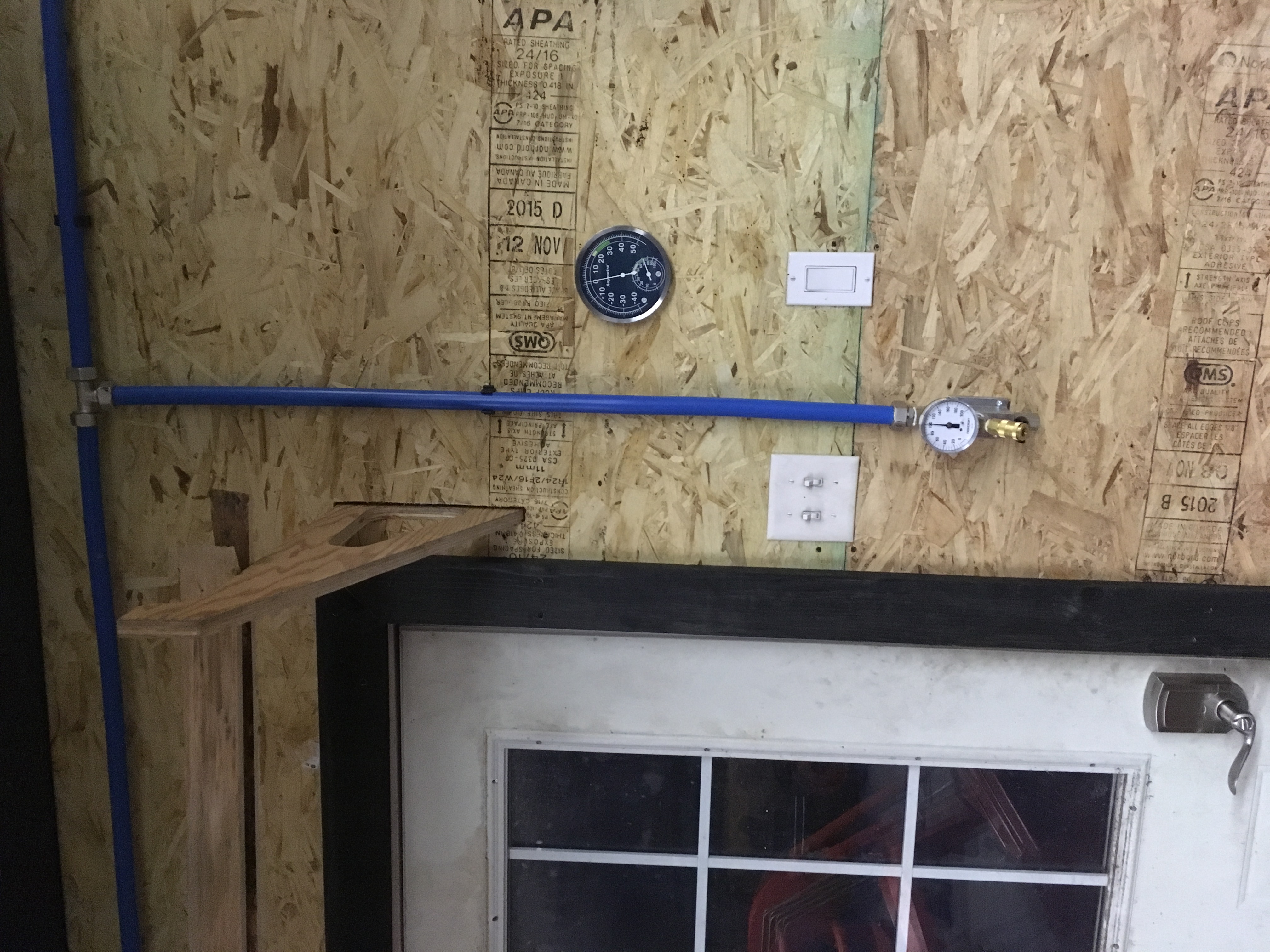

one drop beside my man door with a pressure gauge.
and then the "lowest" drop beside the garage door. and then up hill to the other side of the door where I installed a hose reel.
its been 5 days since I finished the air lines, and I haven't lost 1 psi of air pressure.
