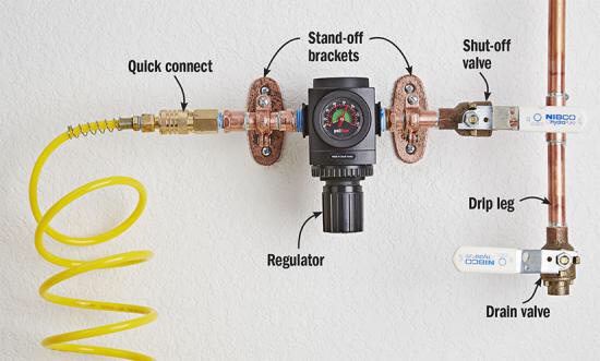

You really need some drops in air system, with drain valves, to occasionally expel water from system. Condensation is an issue here with our normal high humidity.
Plumb your shop for air | WOOD Magazine

My lines are routed overhead. Vertical drops to wall mounted connectors. Each connector uses a T with a drain valve in the bottom.
   / Shop Air Compressor set up questions? #76
This would be the ideal installation.

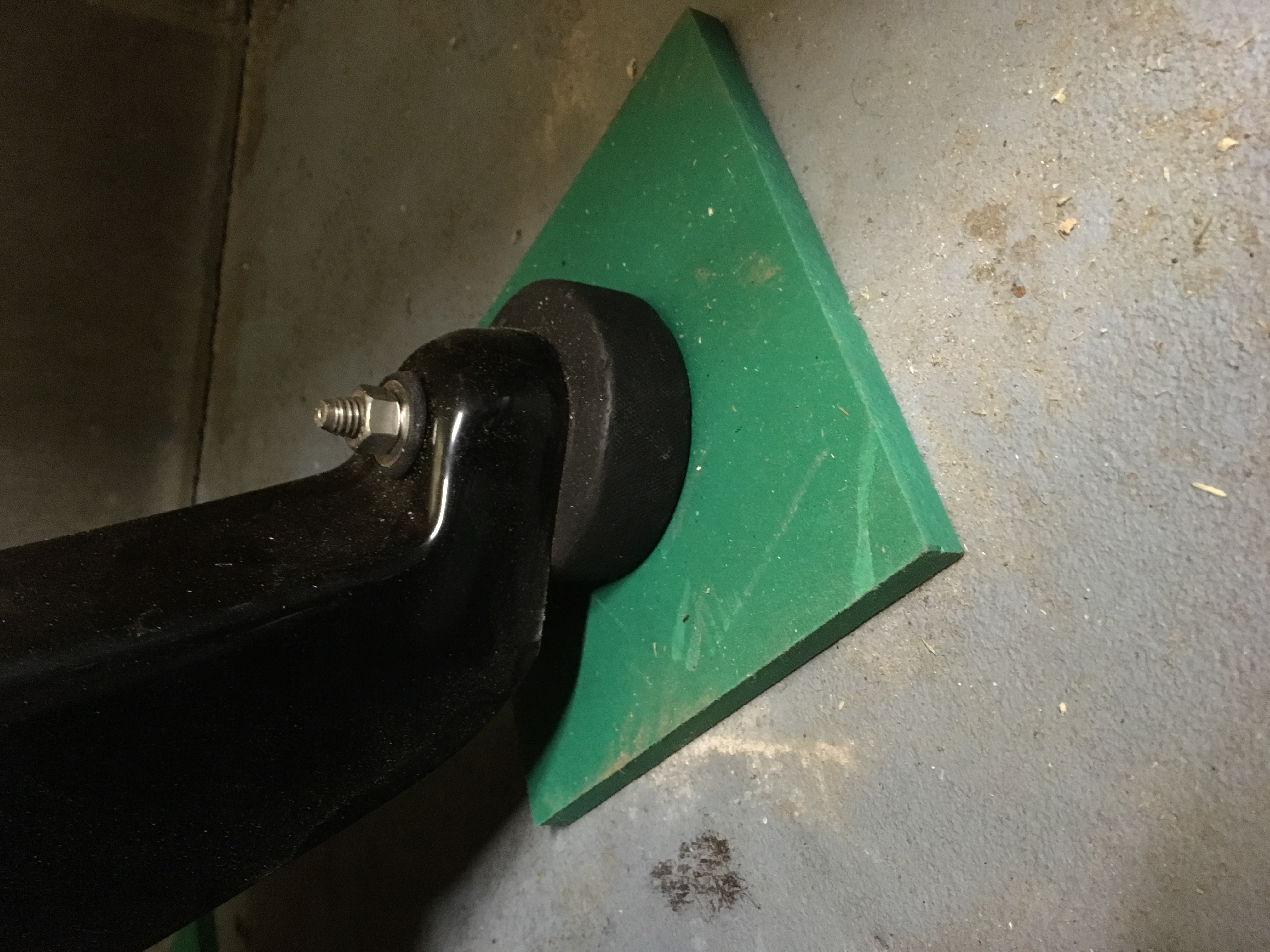

I got the compressor bolted down and wired in over the weekend.
I used 3/8" SS concrete anchors, with a vibration pad and hockey puck under the feet. I used 2 rubber washers on top of the feet under the SS washer and nut.
I used the hockey pucks for two reasons. 1st was height. I wanted a bit more space to plumb the drain valve. the second reason is the feet of my compressor are stamped sheet metal. I figured with constant vibration the sheet metal edge would slowly cut into the vibration pads, hockey pucks are a lot easier to come by in Canada when I need to replace them.
I'm now thinking about how to plumb the air lines and regulator.
I'm considering installing a quick connect before the regulator, to give me an un-regulated, full tank pressure, connection point.
I might use this point in the future to connect a 10ish gallon Air pig.
any thoughts?
   / Shop Air Compressor set up questions? #78
Definitely plumb an unregulated connection.
I'm enjoying following your progress.
