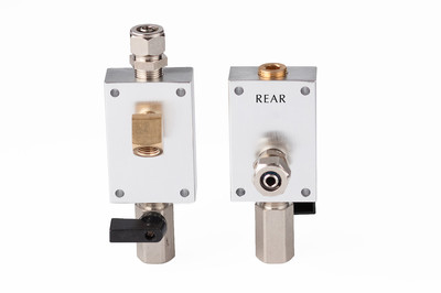

Create some low point drains. Feed your connector from a tee, and extend a leg downward to a valve. A cheaper way is to use a reducer to a larger pipe and cap it. The larger pipe will hold more water longer, and can be drained when you bring your system down.
KG,
Thanks for the suggestion. I noticed that one of the systems I was looking at had outlets with built in drain valves. This seems like it would solve the drainage question.
What do you think? Will this work for water drainage?
