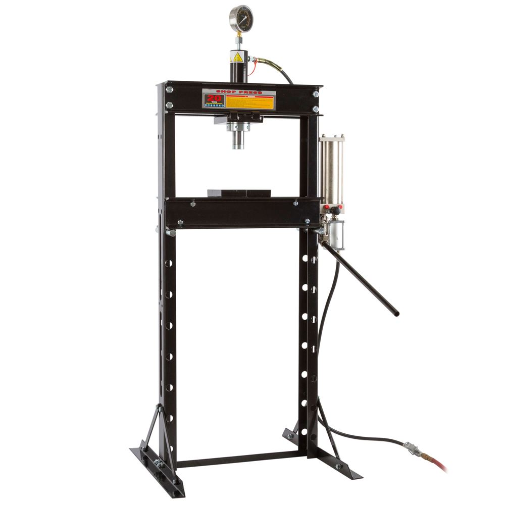

We replaced it with a 30 ton air over hydraulic. I beam is a little narrower but still able to fit the 3" od shafts. The way the piston mounts is much more stabil as well.

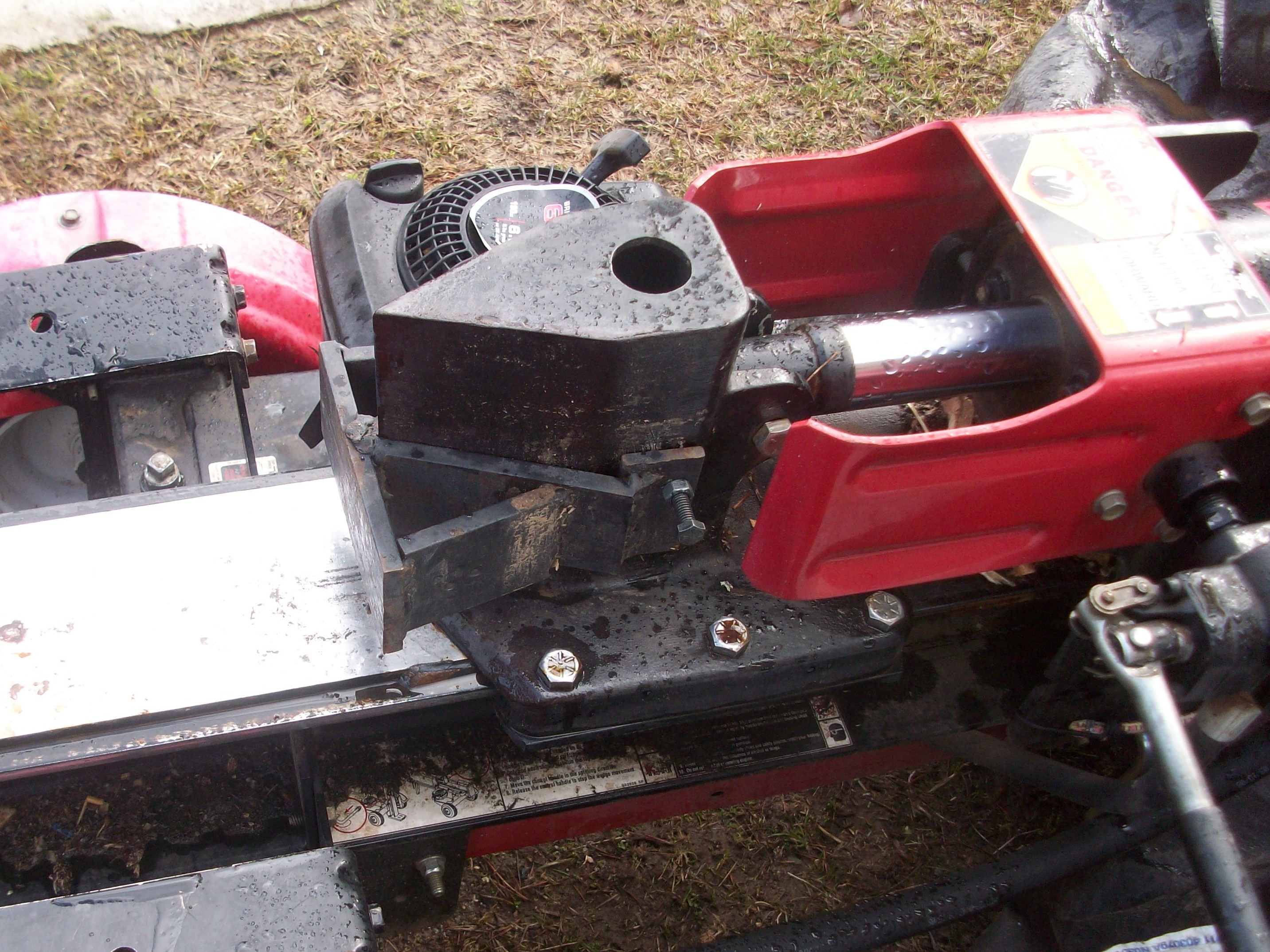

Still use my splitter for pressing- in addition to the new press.
about a week ago decided to straighten a bumper pull utility trailer's axle that I built out of an old boat trailer.
It was much easier to use the log splitter with add on push plate and a rail road rail for the axle to sit against for pressing the bend out of it caused by PO using the axle as a (jack) point.
The log splitters work great -but a deft hand is needed due to the hydraulics being under engine power.
It can be easy to (overdue) it in just a second -even feathering the spool valve :D

The Harbor Freight 20 ton goes on sale with a coupon for $149 four or five times each year. Wait for the sale and get the 20 ton.

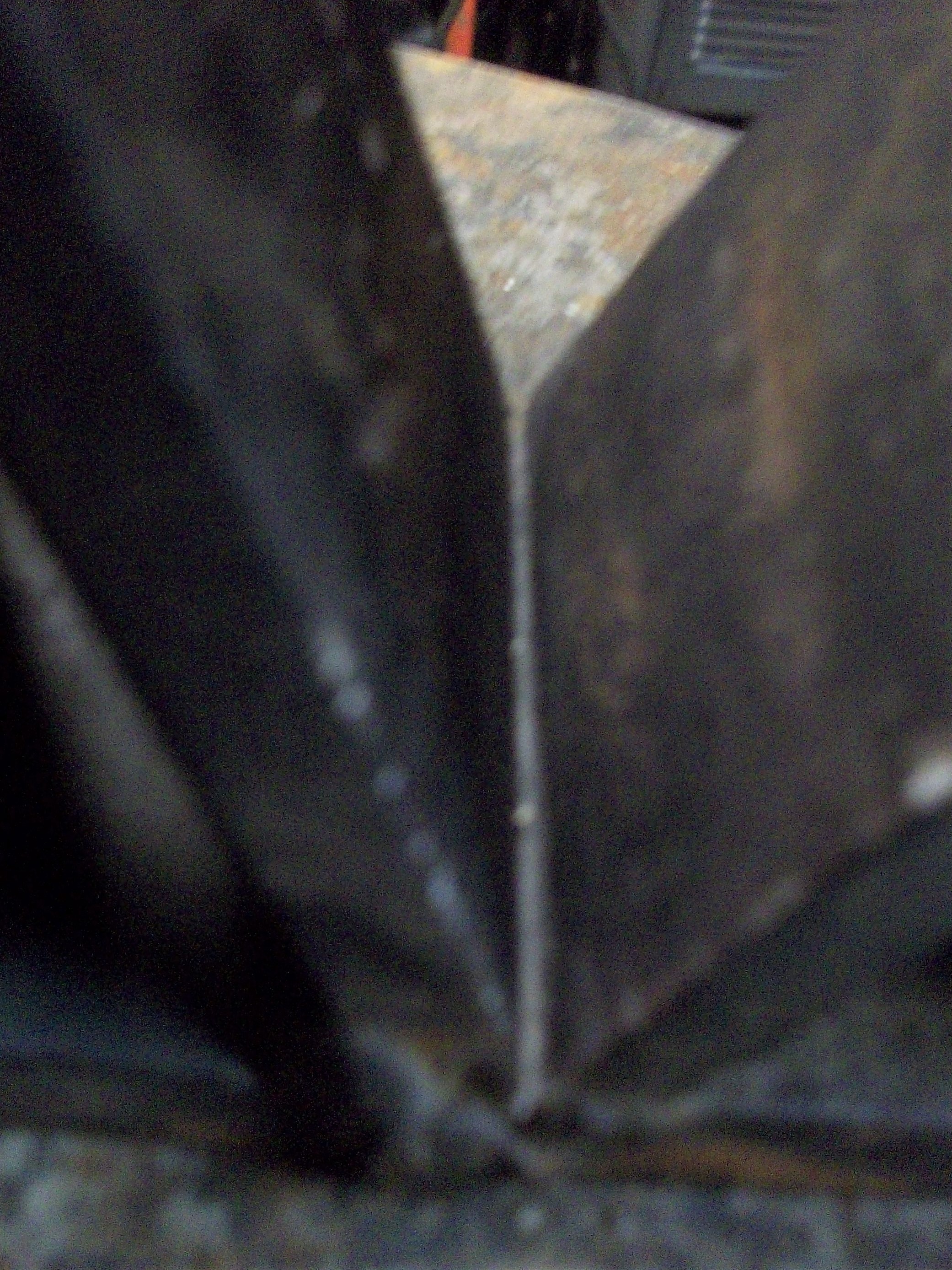

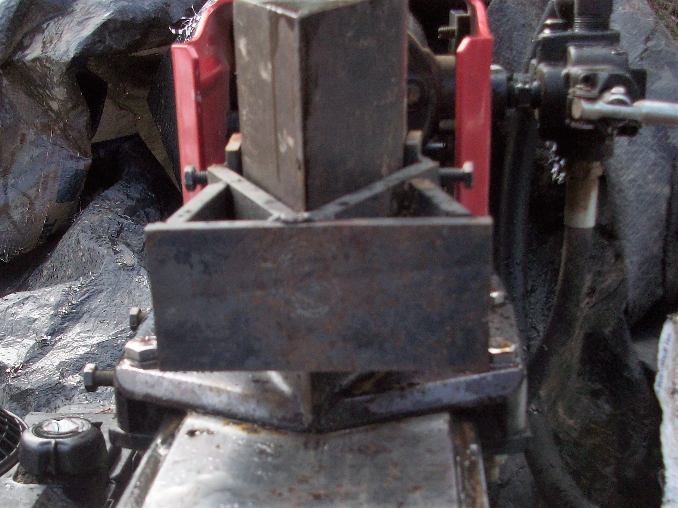

yeah i was a bit embarrassed at the quality of my work-
the old HF mig was giving me some feeding problems when i welded it up years ago.
also the design could be better to minimize the chance of pressure put on the splitter blades edge, I maxxed out the splitter on some bushings that were stuck and IIRC it did dull the edge that day.
mine just grips the wedge by compression of the 5/16 bolts and lock nuts
anyway here are the pics again
also the inside - used a bi-metal blade and saws all to give a little clearance to the wedge edge
the old HF mig was giving me some feeding problems when i welded it up.
View attachment 548047View attachment 548048
Thanks looks fine - sticks together and that's what counts.
