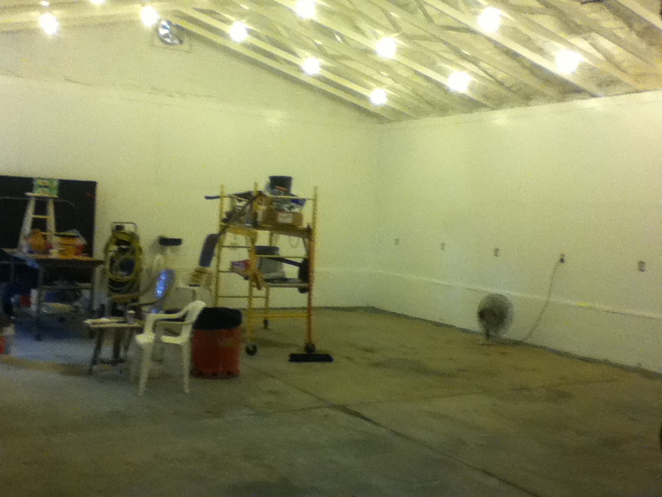

OSB looks horrible and like you bought the cheapest of the cheap. Painted plywood is better. Tin is good but looks like heck after getting hit a while. You lean something against it and the thin modern stuff is already dented. They make plastic and fiberglass panels for barns, some very comprehensive systems, but I worry a bit about fire rating. I've burned fiberglass and you might think a plane went down!
Guess I better empty the shop and tear it all out. Sure looks cheap to me too.
P.S. painted plywood looks much worse.

If the keyword is "inexpensive" then OSB is always going to be your best choice. Rip a sheet in half and you can cover 16 linear feet for less then $10. Nothing else will even come close.
If appearance is a consideration, look into Smart Siding. It's a higher grade OSB then the normal construction stuff and the appearance side has a wood grain stamped into it that looks like T1-11 siding, but a lot nicer.
Or advantech - that stuff is not like the OSB of old.
When I get that far, I'm going to buy 12"x12" porcelain tile, and do the bottom 4' of the walls with them.
HD has them for a buck a piece, all the time.
Seems like they would break real easily if you run into them with something.

I am currently building a garage. I did this to be able to clean the floor.KIMG2295.jpg

Decision Made: I'm going with plywood.
Lots of great suggestions. I really like the Puck Board idea, but not easy to source. 3/4" plywood sanded on one side and painted is the way I'm going.
It will be 1/2" off the concrete floor to avoid direct contact and minimize moisture. I will also paint the plywood front, back, and all edges to seal it.
