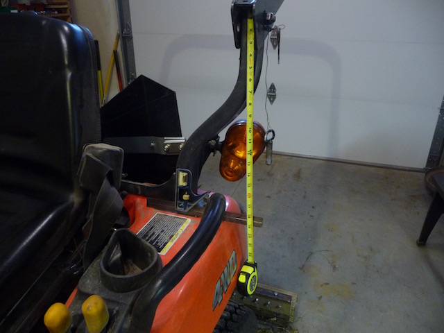

I started this thread and just now realized I never did a completion post. Sorry about that. I do not have a welder so I cut three inches(?) off the bottom and redrilled the holes. So you can get it shorter by either method; cut the top and reweld or cut off the bottom and redrill. I am glad I did and I don't think I have lowered it since I shortened it. And I do wear my seat belt at all times now.
Doug in SW IA

Sorry it took me a while to get around to pictures. But it really doesn't look and different, other than being shorter.
I did have some minor alignment issues that a little file and grinding work took care of. But keep in mind that I did this with it on the tractor and I used wooden blocks as my drill guide. If I were to do it again I would probably remove it from the tractor and use my greatly improved drill press. I have absolutely no reservations about the safety issues. My modification was pretty minor. Now that my ROPS is shortened I leave it up all the time and I wear my seatbelt every time. So overall my safety level has gone up.
Doug in SW IA
