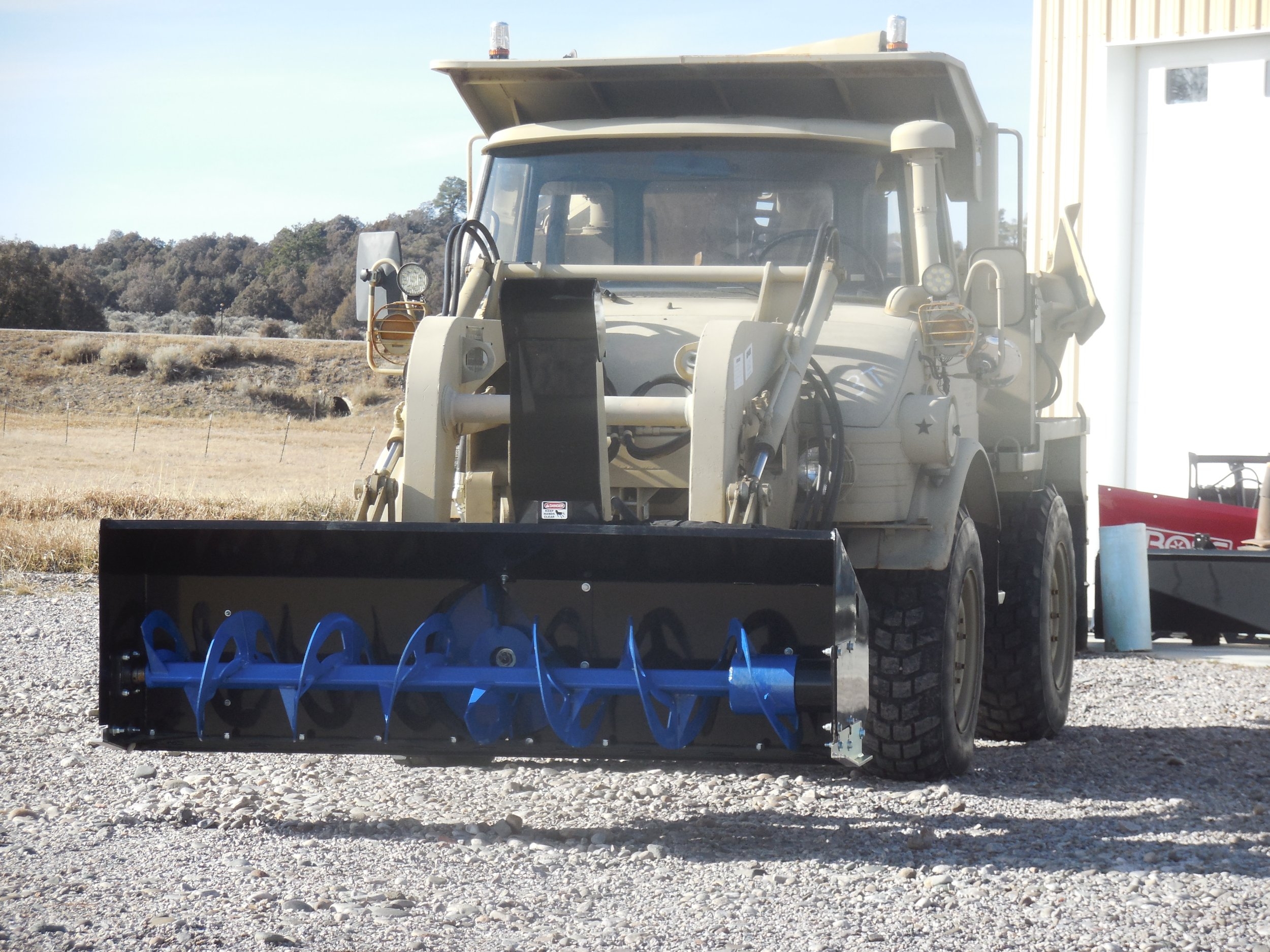

Why settle for a "mini-Unimog" when the real ones can be quite affordable?
Okay, I paid $16K for this one, but it came with all the hydraulic tools, which was nice. Then another 4 or 5K for the snowblower. And I had to convert the loader to SSQA, but that was affordable.
Anyway, it works well, and the heated windshield is a plus when running the snowblower. And getting unstuck would be easy with the Case 580 backhoe on the rear.
Anyway, it works well, and the heated windshield is a plus when running the snowblower. And getting unstuck would be easy with the Case 580 backhoe on the rear. View attachment 826927
I've wanted a unimog for many years. I almost went this route but talked myself out of it.
Very nice set up
