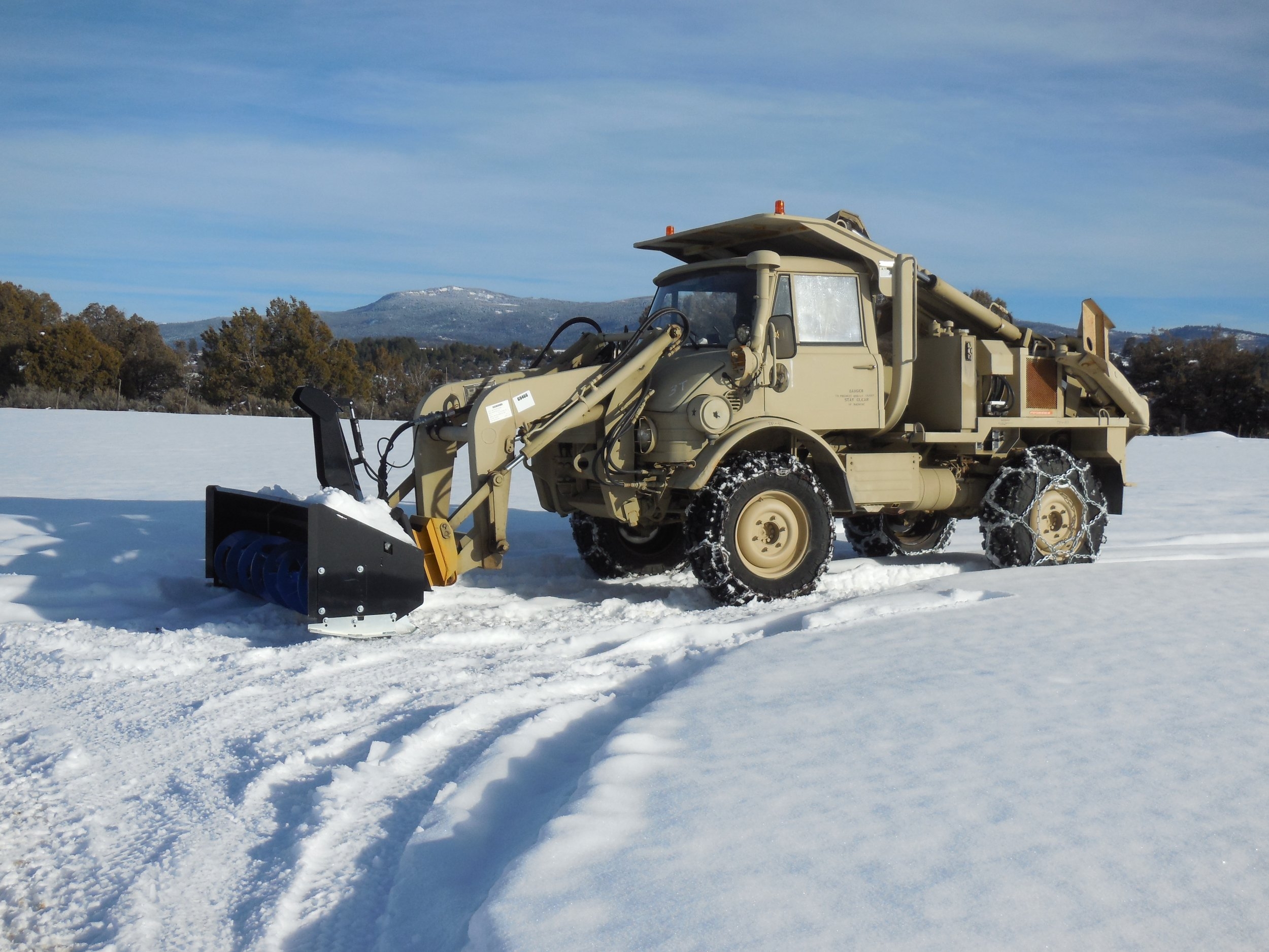

I've wanted a unimog for many years. I almost went this route but talked myself out of it.
Very nice set up
Thanks. You probably shouldn't have talked yourself out of getting one, though. They're fun and quite capable.

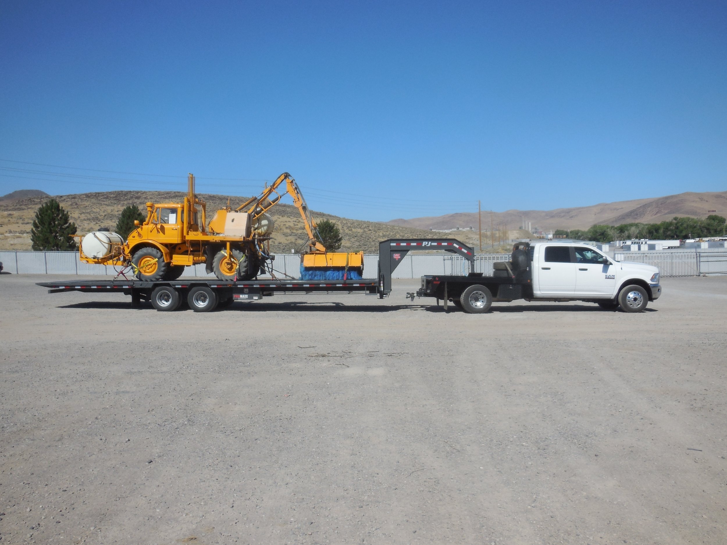

That was the first one I bought, but I suspect that the one tacticalturnip referred to is one I bought later, for parts, which turned out to be better mechanically than the one with the snowblower.
Better yet, that "parts car" was only $5K.

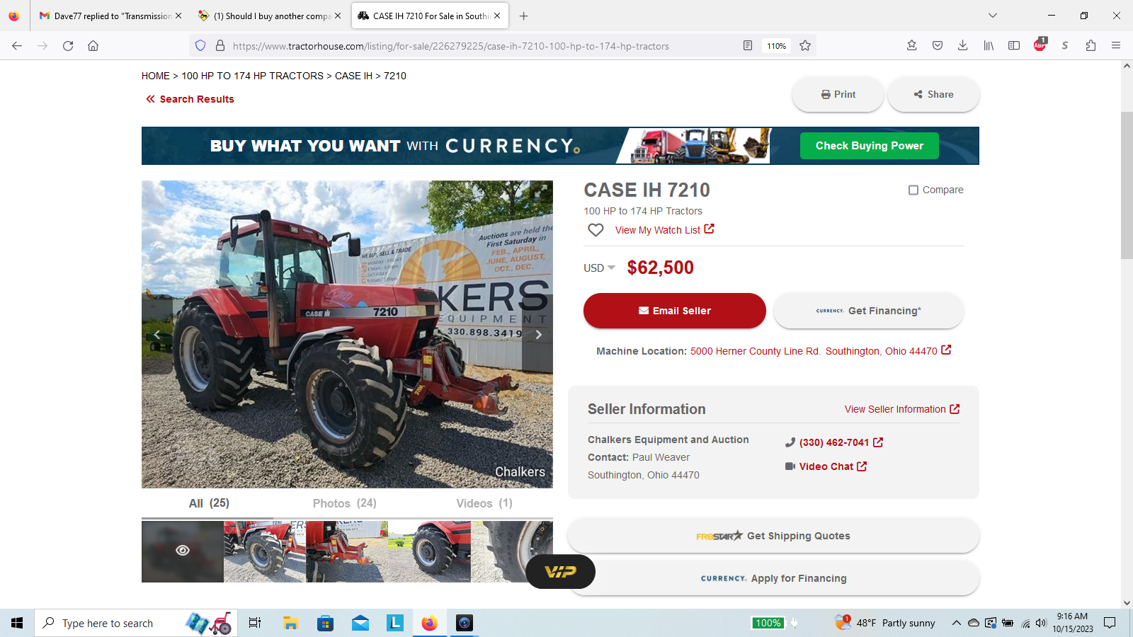

Now this if it had a front pto or the rear to front pto drive would make a snow eating beast;

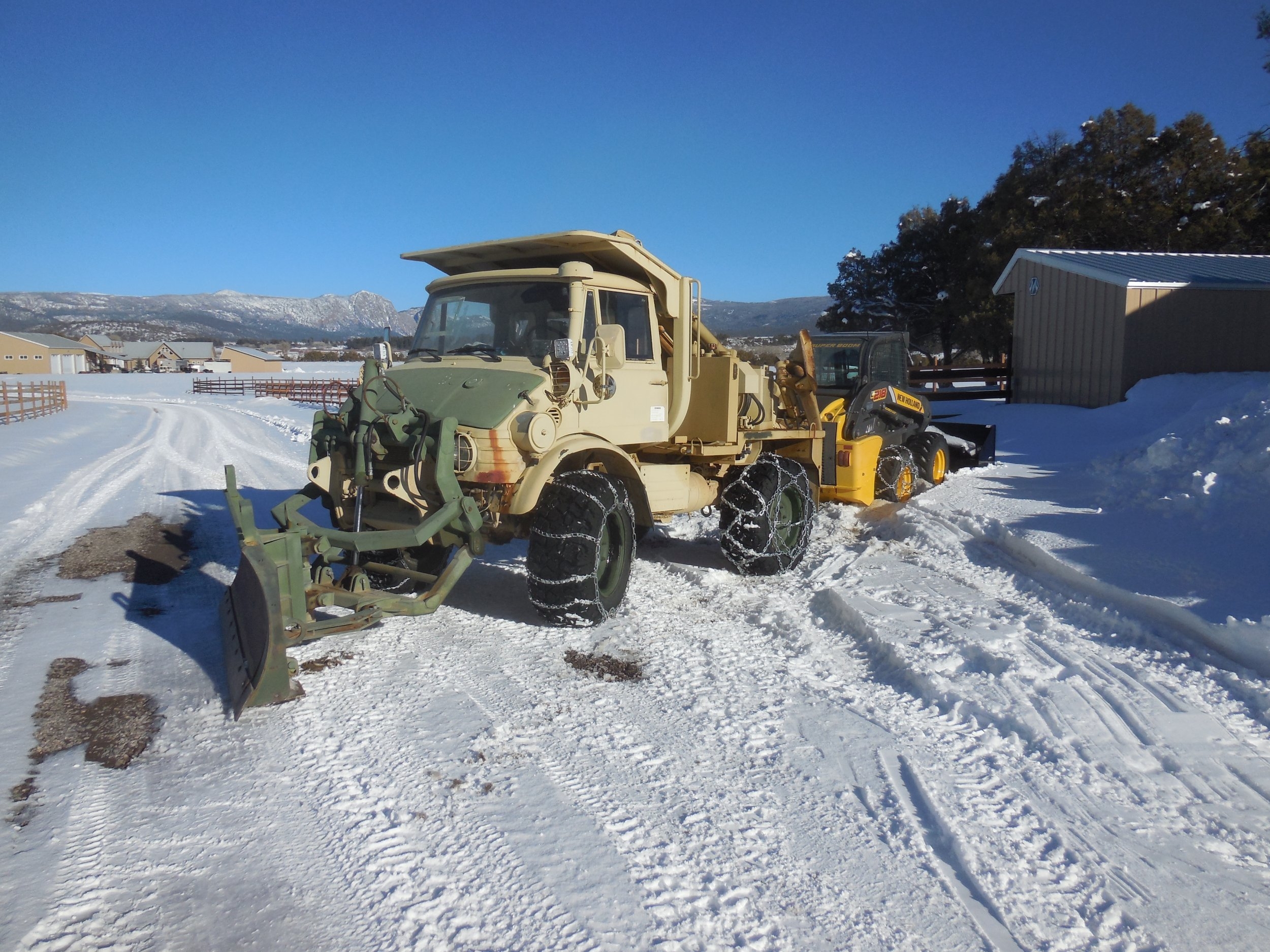

Ha! It's only a 1/4 mile, and practically flat.
But there are other places near buildings and such where it's useful, plus I occasionally clear parts of the "horse roads".
My main reason for using a snowblower is to be able to put the snow up to 60 feet away, where it won't be in the way, and on the (slight) downhill side so the spring runoff doesn't affect the driveway, buildings, etc.
Ended up getting a used skid steer, which is what that snowblower is intended for, but that's really a love/hate machine. Mostly hate.
Visibility is crappy, it's miserable to get in and out of, and the minuscule ground clearance makes it very easy to get stuck. Okay, the latter is mostly driver error, and at least I have Unimogs to pull it out with.
On the positive side, in the winter it doesn't tear everything up when turning.

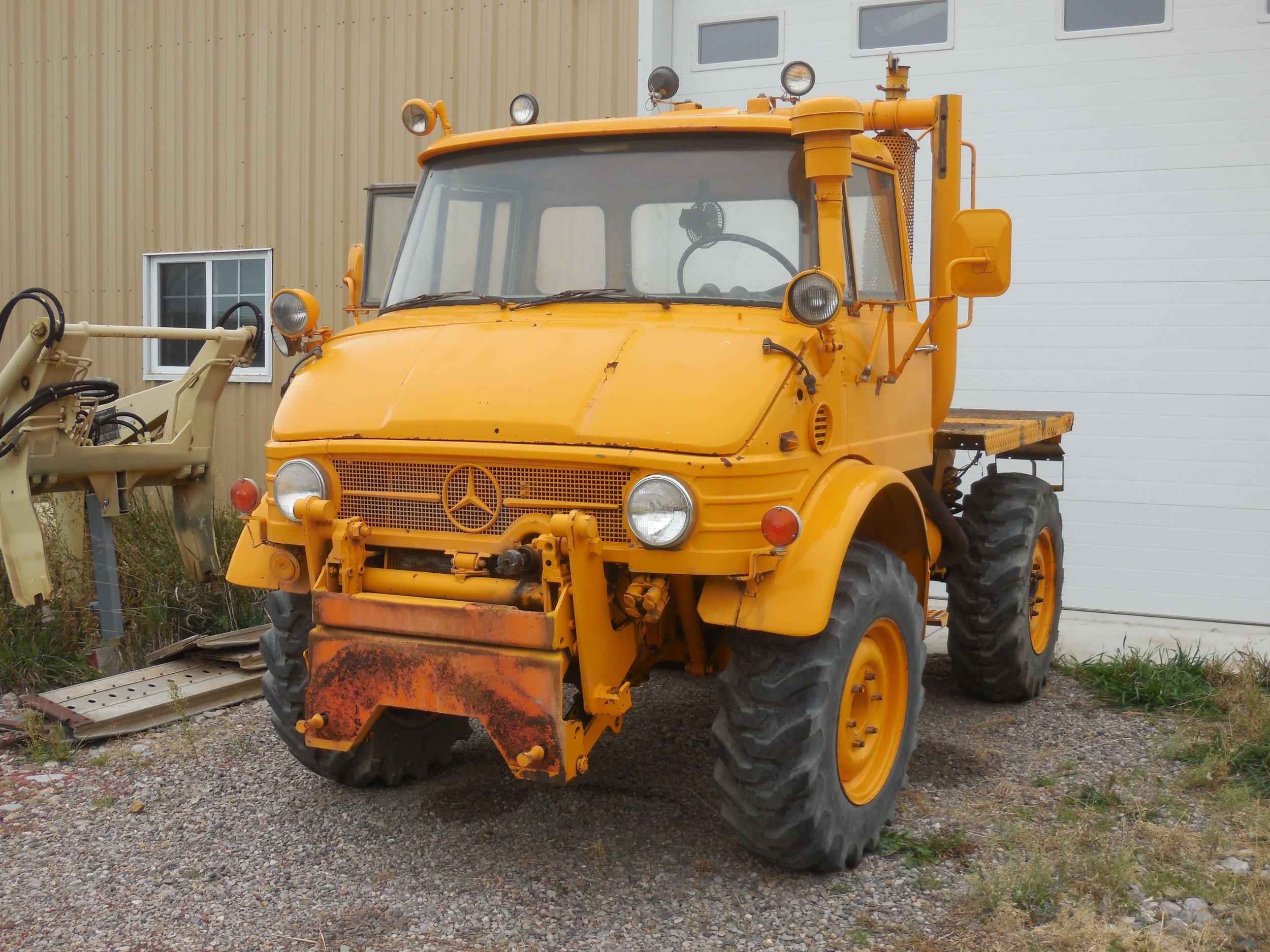

1. No, they're not nice to drive on paved roads like a car. But then, neither is a tractor.
2. Parts aren't any issue, yet anyway. There are a few places just here in the USA that do nothing but sell parts for them.
3. Agree. Most tractor tasks a proper Unimog will do better.
4. Yes, they do lack touch screens, auto headlights, rain sensing wipers, and many other modern things. Instead, there are fully functional levers, switches, and buttons.
5. Depending on what you buy, they don't depreciate any more. If anything they seem to go up in value. The ex-military ones with a loader/backhoe, for example, cost about half of a comparable backhoe, and has maybe 10 to 25% as many hours on them.
There are, of course, newer models with passenger pampering cabs and accoutrements, but those do cost as much as a really nice tractor, if not more.
But for tractor use, the MB4/94 is a better candidate, especially when optioned with front and rear hydraulics, PTOs in both ends, and the so-called work gears (2,000:1 reduction), plus a rear 3-point. There was a mind blowing amount of options available, many of which were farming specific.
I picked this one up for $7K, and everything worked just fine on it. That the (rubber) tires were old didn't bother me, as they were bias ply with plenty of tread.

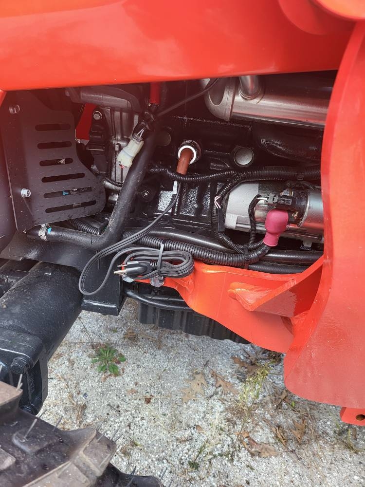

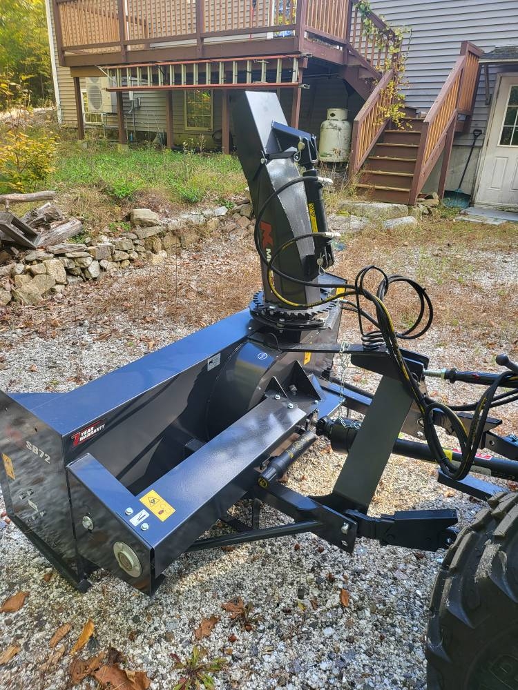

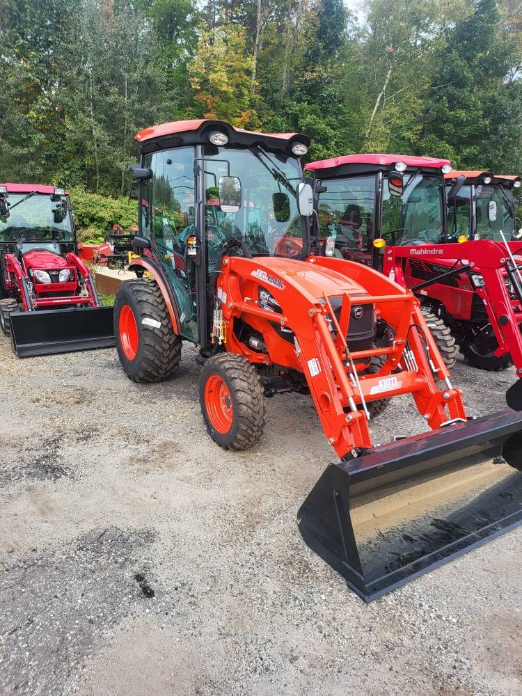

Thanks for all of the advice guys. My tractor got delivered Thursday. So far I love it and the snowblower is awesome.
