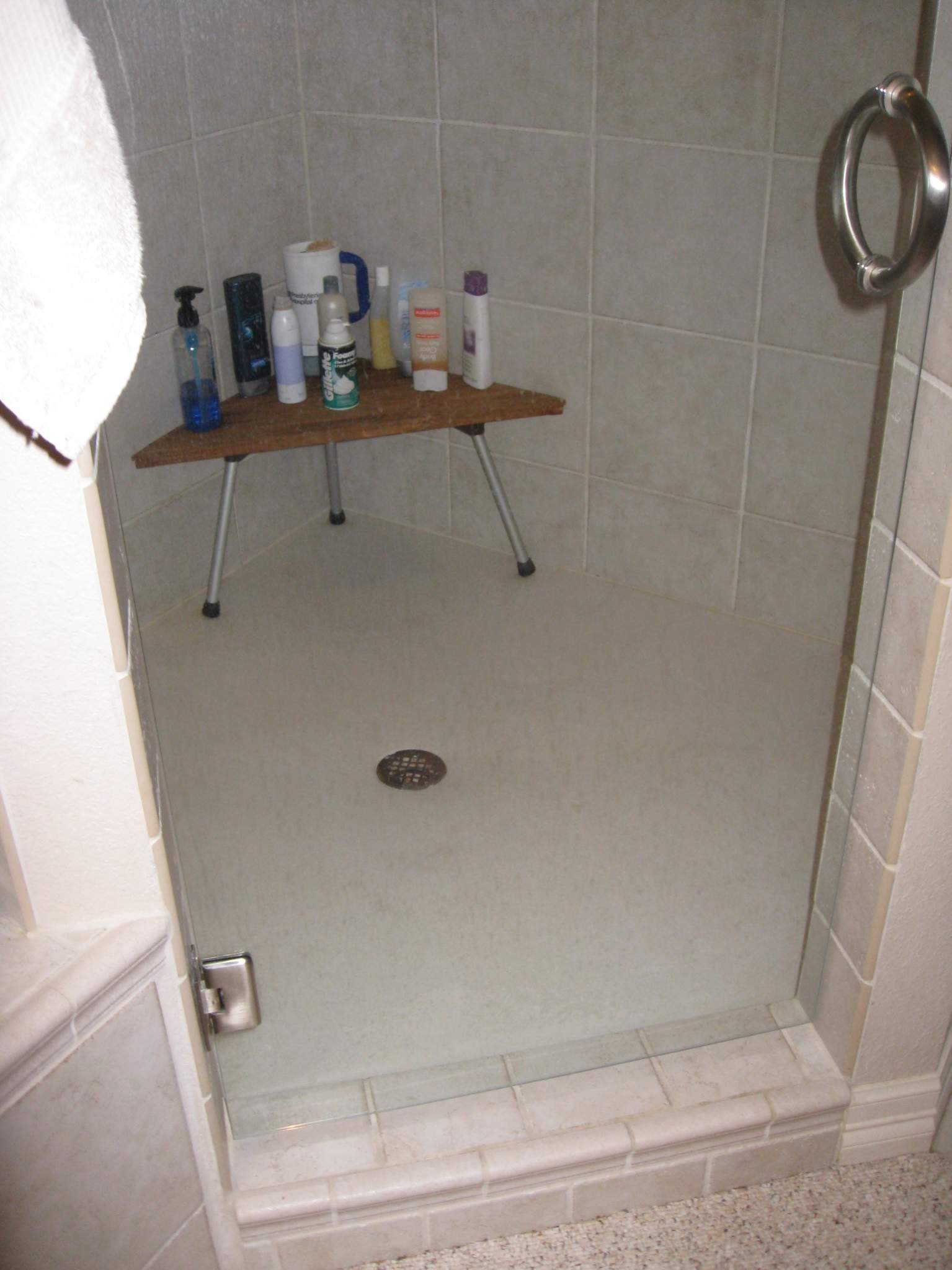

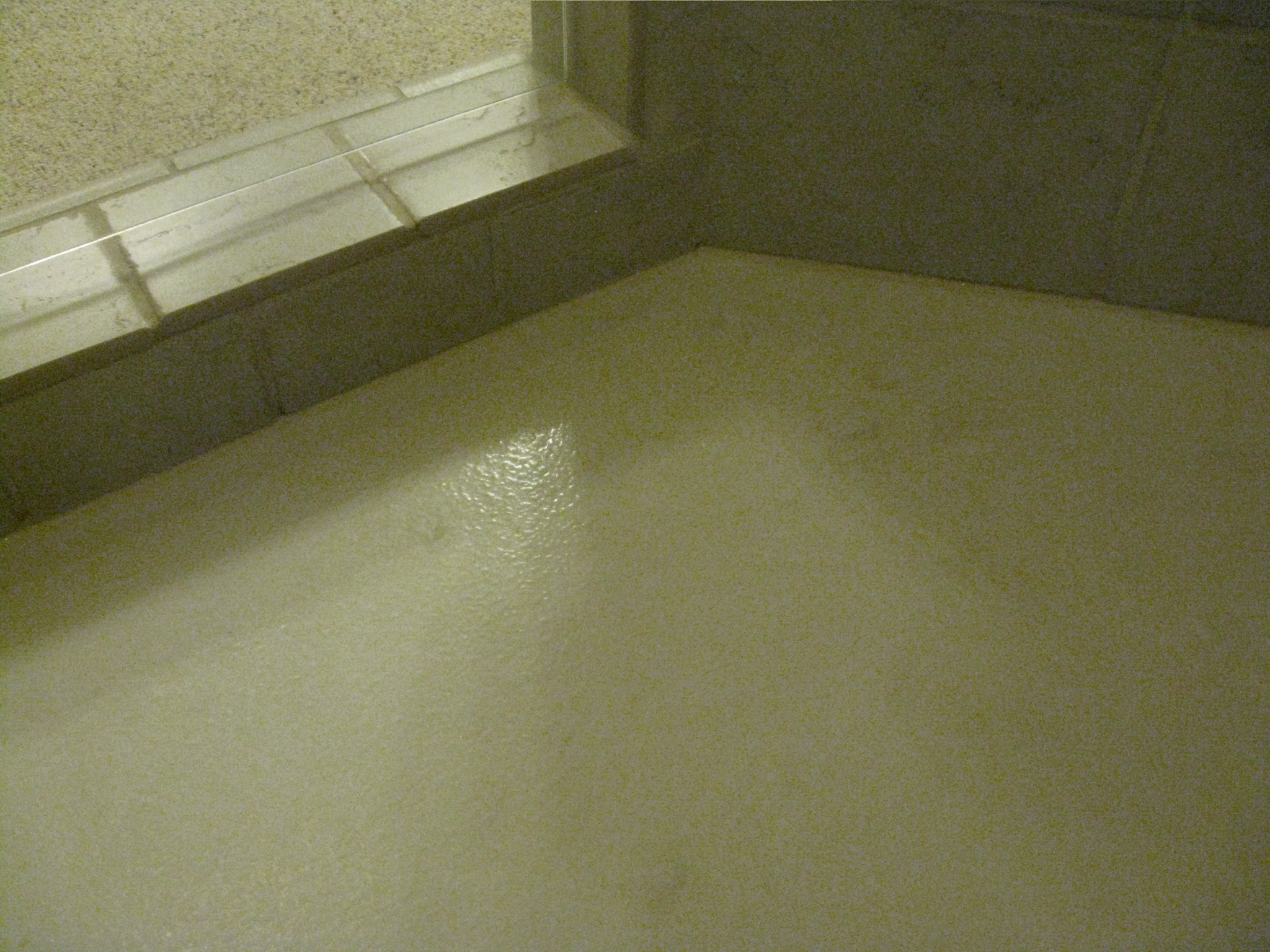

Gomez,
I did a bath remodel and had a cast cultured marble shower pan built by a local company. The same companies that will do custom cultured countertops and tubs will do shower pans. I don't have the price on-hand, but it was very reasonable, considering the time saved and quality of the product. They came out and measured my shower pan (custom sized 54" x 54") and about a week later delivered and installed the pan. It was mixed to my selected color (Mine is a full color blend, with virtually no swirl) and has a textured finish. It has a fiberglass flange that runs about 6"- 9" up the wall. The wall tiles go over that flange.
I can't imagine using anything else. We have no grout or seams on the floor, everything is properly sloped and the drain connection is simple with no chances of leaks. Leave about a 1/8" to 3/16" gap between the tile and the pan so you allow expansion (customary for anytime a tiled surface meets another surface). Caulk this gap with 100% silicone colored caulk.
I'm planning another bath remodel and will use the exact same thing. It's a huge timesaver and a much superior way of doing a shower pan.
