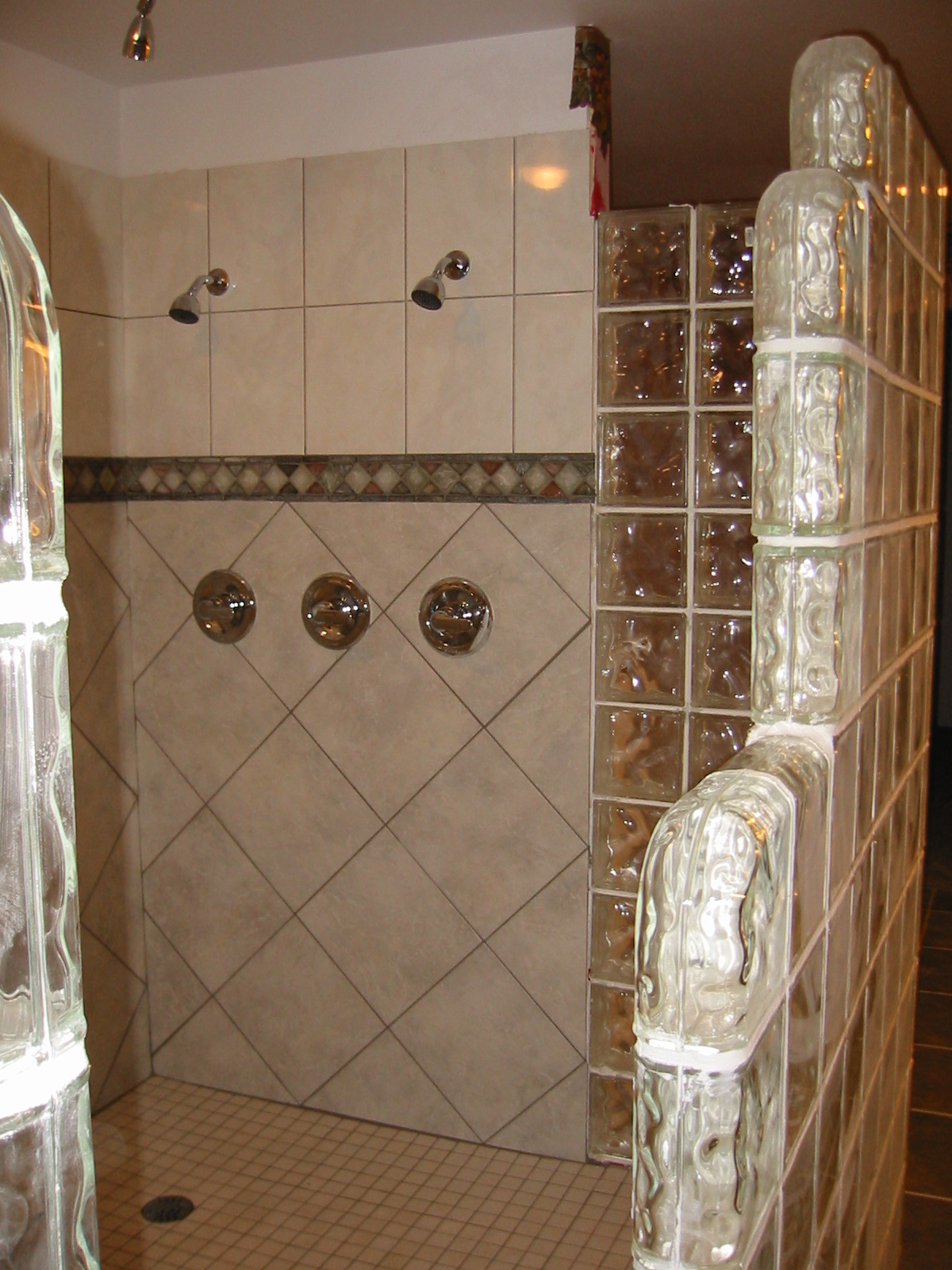

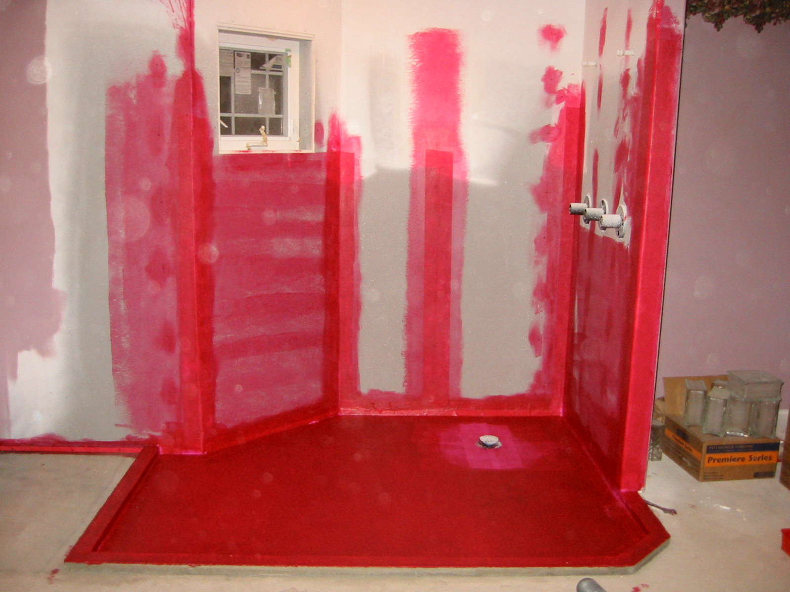

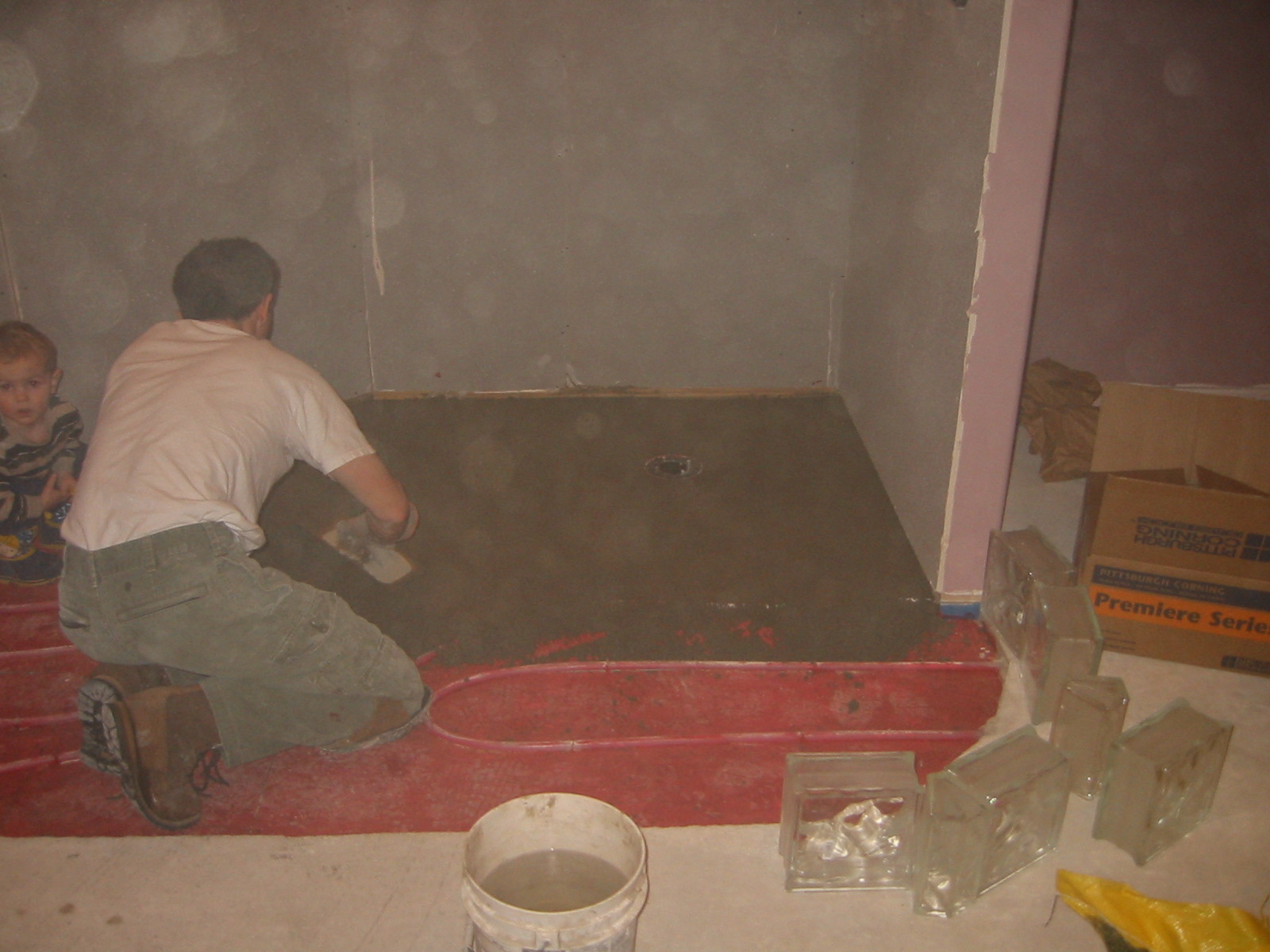

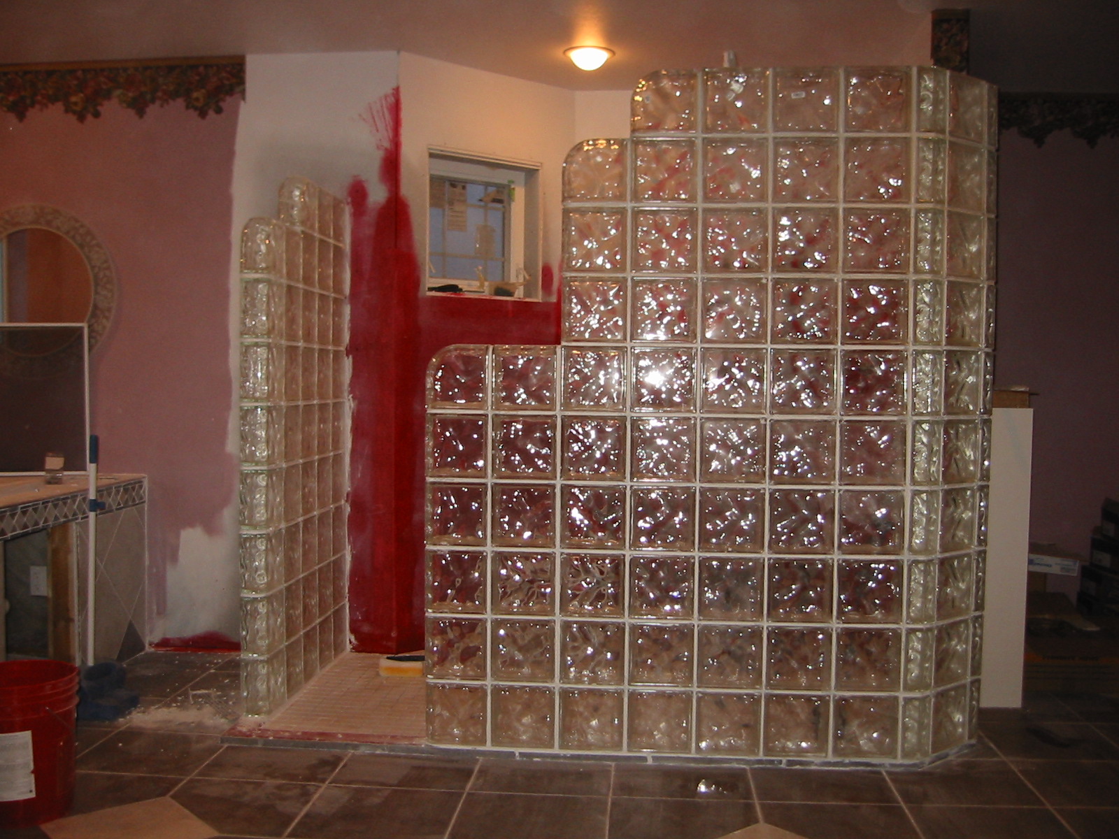

I have built several showers over the years using various technologies from mud base, to membrane to preformed. As an amateur I would use the shluter system. The other reason for products like these to emerge is to reduce the skill required to do a good job -- good tradesmen are expensive for a reason:eek::eek:. A good mud base is a work of art and unless you really need custom dimensions, probably not worth the learning curve -- JMHO
/ Shower Pan Suggetions #7
Not real sure about these other systems, I used "Red Guard" and a "dry pack" (very dry pre-mix concrete) base.
It was actually a lot easier than I thought and fairly inexpensive. The "Red Guard" is amazing stuff!!

Dave 1949: Red Guard is a membrane, that is very tough, after you roll or paint it on, it sets up like rubber. For extra strength in the corners and around the drain I embed some special fabric. The Red guard it self is kinda expensive, but not when you compare it to buying rubber membranes, glue, etc.

Most people that have never poured shower bases mix their mud much too wet. You don't so much pour and trowel it as you dump it, pack it, then carve it. Some guys put the membrane right on the deck, others pour part of the base to give it slope to the drain then install the membrane, then pour another layer of mud. There are many ways to achieve good results as long as the (base) membrane turns up the walls and the cement board overlaps it. The wall membrane some have mentioned really isn't needed. It doesn't hurt anything though.
