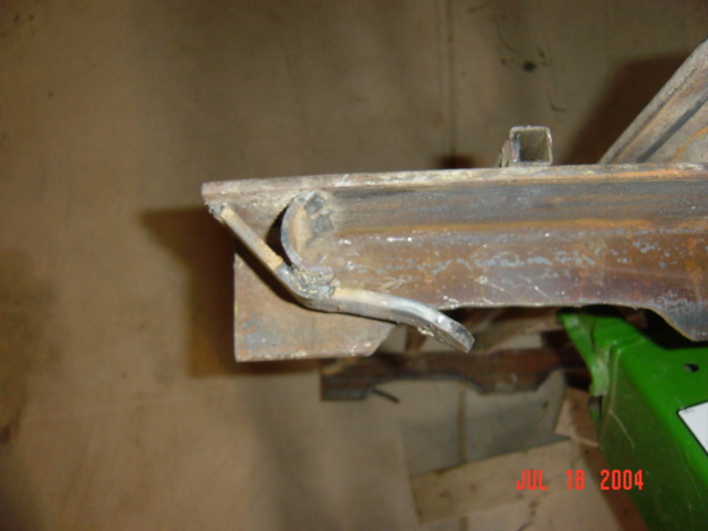

Where did you get the lower pins that are on the frame of the scoop? The pins that lock the scoop to the loader frame?
/ Shrub Bucket
#30
I machined the pins from solid bar stock on my lathe. It was pretty easy to do - just cut the stock to length, face each end nice and flat, cut a taper on one side, and drill a hole in the right place.
Some think I'm a bit crazy for spending money on things like machine tools, and in truth I don't really use them all that much, but when I need them it sure is nice to have them!

BGL990, could you post the dimensions of the frame that mounts to the FEL. I am looking into turning a snowplow that I have for an old truck into one that I can use on a JD 430 FEL. I would really appreciate them. Thanks.
/ Shrub Bucket
#33
I'll get the exact dimensions tonight (hopefully I remember! /forums/images/graemlins/tongue.gif) but from memory, the actual frame was built out of 2x4 steel with horizontal sections 48" long and vertical pieces 9" long set between the horizontals (making 17" total frame height). The lower pins ended up almost exactly flush with the ends of the 48" pieces. I don't remember the width between upper brackets or their height from the pins.
Stay tuned ....

OK, here's what I measured:
Bottom pins center to center = 46.75"
Top brackets center to center = 40.25"
Bottom pin center line to highest point on underside of top bracket = 15"
I don't know what the official dimensions are for a 430/460 loader attachment, but these work for me. There is a wee bit of slop, especially in the top brackets, so these measurements are probably not exactly to spec, but they should work OK.

Hey BGL990 did you ever try your shrub scoop out. Wife wants me to dig up some small spruce trees and this should would make things quicker if it works.
Thanks
/ Shrub Bucket
#36
Yes, I've used it 3 or 4 times. It can work quite well if the soil isn't too hard. I tried it in some hard clay and my machine just isn't heavy enough to drive it very far into the ground. In softer soil, however, just raise the front of the tractor off the ground with it and use the bucket curl to gently rock the scoop back and forth. It sinks right in.
