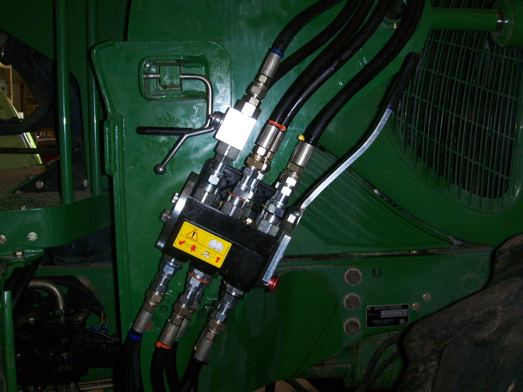

Here's the one on my tractor

/ Single Point Connection for 440R Loader #6
Do all six hoses connect using the single lever?
Yes! I have both my tractors equipped with one, both are 3 function (6 hoses), set up for a grapple. The 245 loader on the 2030 has another hose from the relief valve return to sump, that is a separate quick coupler, I have to remember to couple/uncouple. Super easy to couple or uncouple.

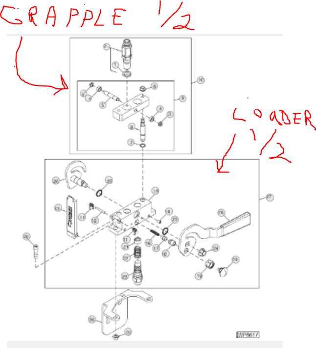

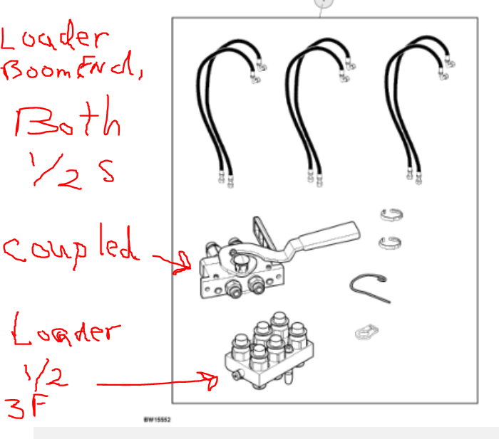

/ Single Point Connection for 440R Loader #7
The only way I would NOT add the single point for $125 is if it's just the loader 1/2 at the boom end for a 3rd function. And does not have the grapple 1/2 included.
