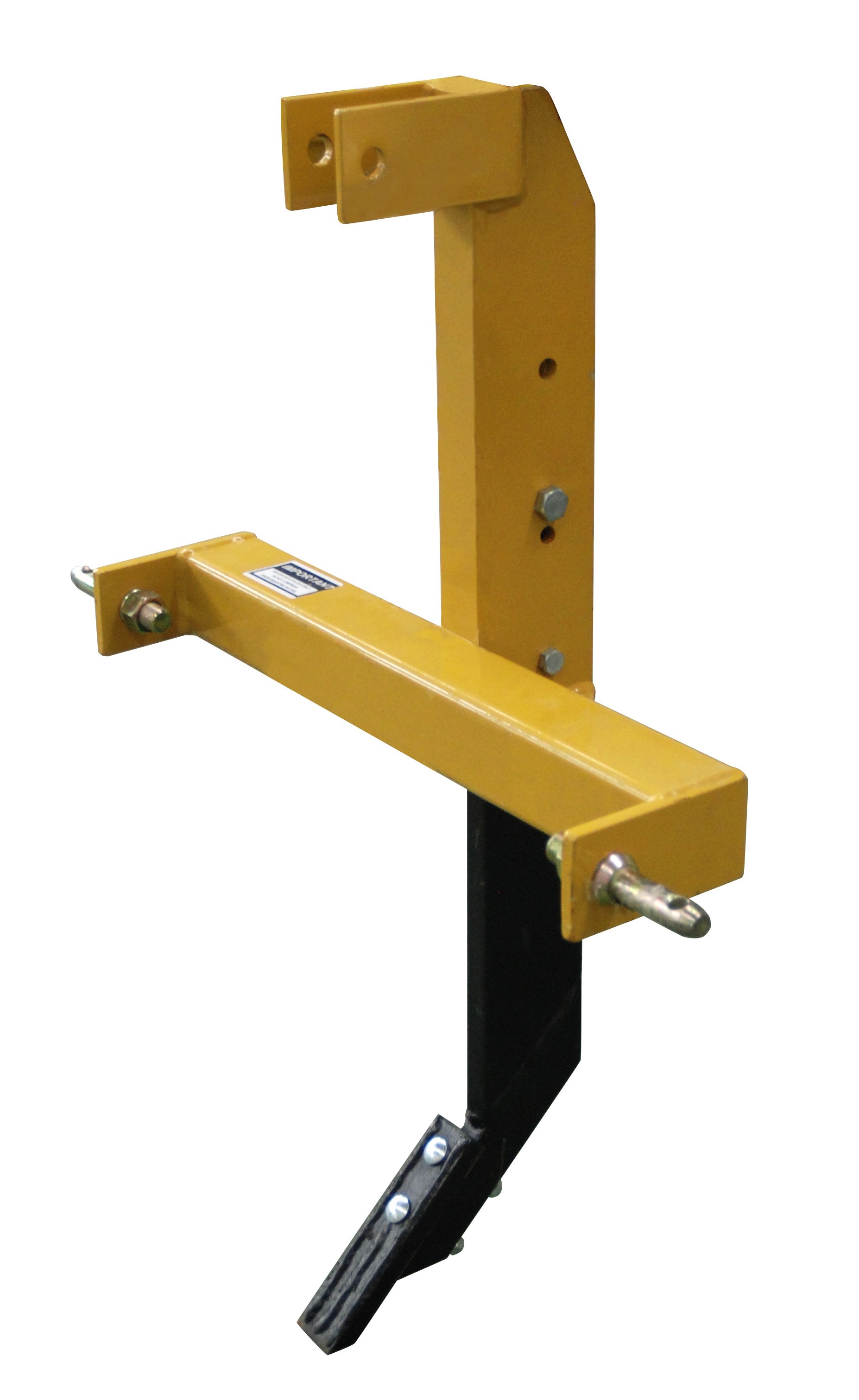

Thanks for the reply conditions are Sandy with some gravel thinking 24 inches will be too deep I looked at tractor supply Company and do like their design simplicity but would like to make it more rugged.
Here is a pic of a simple ripper that I could tackle.
   / Single tine ripper #8
Well you may get farther along that I thought but I wouldn't have a prayer in clay.
I would just use that as a starting point. I also wouldn't rely just on a weld to hold onto the side of the tube. If you can get the metal to push into the cross bar by putting the vertical portion in front of the cross bar it will be much stronger. If you want to add gusset plates or something then thats different. If you have a welder and a way to cut steel, I think it could be a fun project.
Awesome, tine in front and gussets are great suggestions, thanks. I'm a hobby welder with lots of stock around. I think I would like to have the tine depth adjustable, although I guess that will be achieved with raising and lowering the 3 point hitch.
