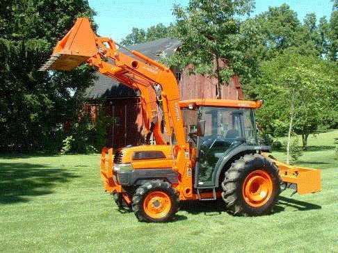

I'm buying my first tractor for the 20 acres we recently purchased.
I will be mowing around the house and buildings (3 acres) I have planted brome to start a pasture on the remaining acreage. I also have to maintain the area around a 2 acre pond. The property is mostly level crop land.
I also need to build the drive way (750').
Here are the attachments I thought I might need:
Finish Mower
Brush Hog
FEL
Box Blade
I've been looking at the Kubota L4330 and L5030 and the JD 4120 and 4320. Since my wife will be helping with the mowing I thought I would get the HST.
I don't want to spend any more than I need to but don't want to buy too small of a tractor for this work.
Your suggestions would be appreciated.

I think you are on the right track with looking at the HST transmissions. I would probably look at tractors 40hp to 45hp. I'm sure there are folks here with 20 acres and an L5030 but that seems a bit bigger than necessary. You are obviously looking at Kubota and Deere given your choices. I had a chance to play with a 4120 at the local Deere store and found it to be a very well designed well engineered tractor, I really liked it. The Kubota L4330 is also an excellent machine, well made and reliable.
I would suggest you and your wife BOTH sit on the tractors, the safe tractor is the one that is more comfortable to you. Hopefully you can both agree on the machine. Also check out the dealership, make sure you are comfortable with the dealer and that they have a good established reputation in the area.

I don't think that you could go wrong with the Deere or the Kubota. You'll love the hydro transmission. I have a 7 foot Woods box blade on the rear, loaded tires, and 300 lbs of cast weights on each rear of my L4330. I use my loader alot so the extra weigh really helps. I would stronly recommend a toothbar and quick attach forks for the FEL. Good Luck!
