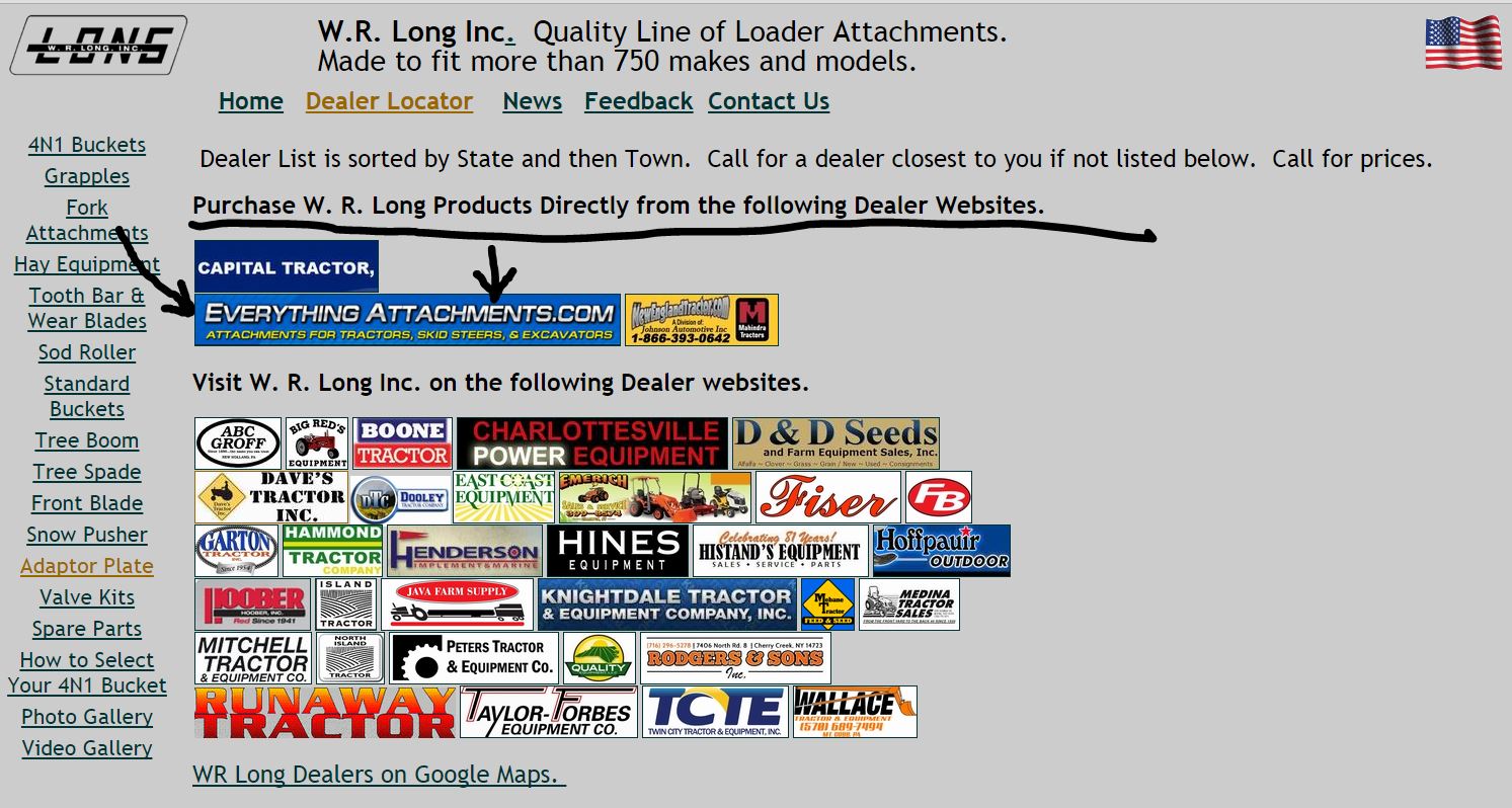

Call EA they are a dealer: WR Long Attachments For Sale Online!

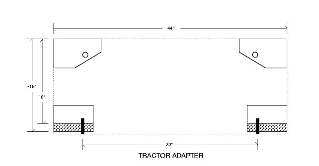

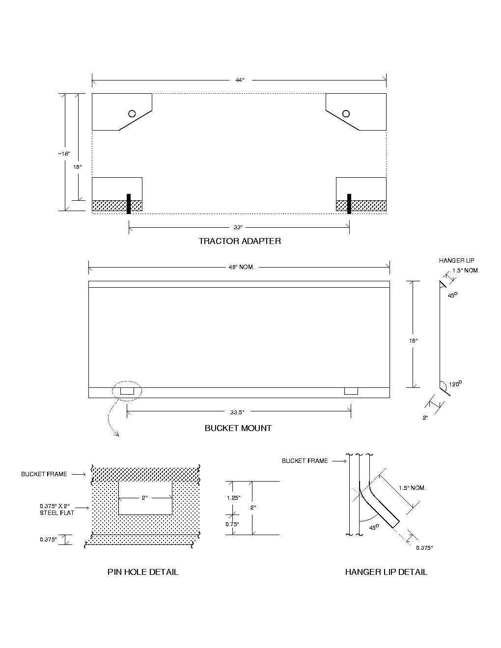

Does anyone have a link to the actual dimensions of the SSQA on the loader side? i can find the plate info easy and back engineer it sure but i'd rather be right the first go, and 2hrs of searching has not reviled a useful source.
I refuse to pay that kind of money for something i can simply build from trimmings under my bench.
Thanks all.
/ Skid steer quick attach adapter #88
Thanks all.
This drawing gives the needed dimensions:
