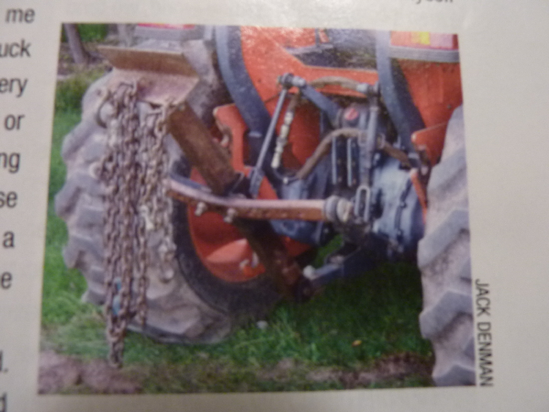

Our property is not flat, so I was leery of skidding tongs on the 3 point.
I've been using a grapple on front end, and this Small Wood Lot Tools - Timber Maintenance, Pre-commercial Thinning, Firewood, Fuel Reduction skidding tong set up. The skidding tongs are safe because you adjust the lower chain length to drag the log with your draw bar, so the 3 point only lifts the log up off the ground.
I've skidded over 100 logs from 16' to 60' long. Just back up, lower the 3 point and drive off. Rarely have to get off of the tractor to hook or unhook.
Patrick
That thing looks simple enough to make if you can figure out the geometry of the moving pieces...

Why not pull with the 3 point hitch?
I think it really depends on what tractor you have...
It's not easy to lift the front of mine, I pull on the top pully on my skidding winch all the time and the front stays down, even with heavy pulls.
