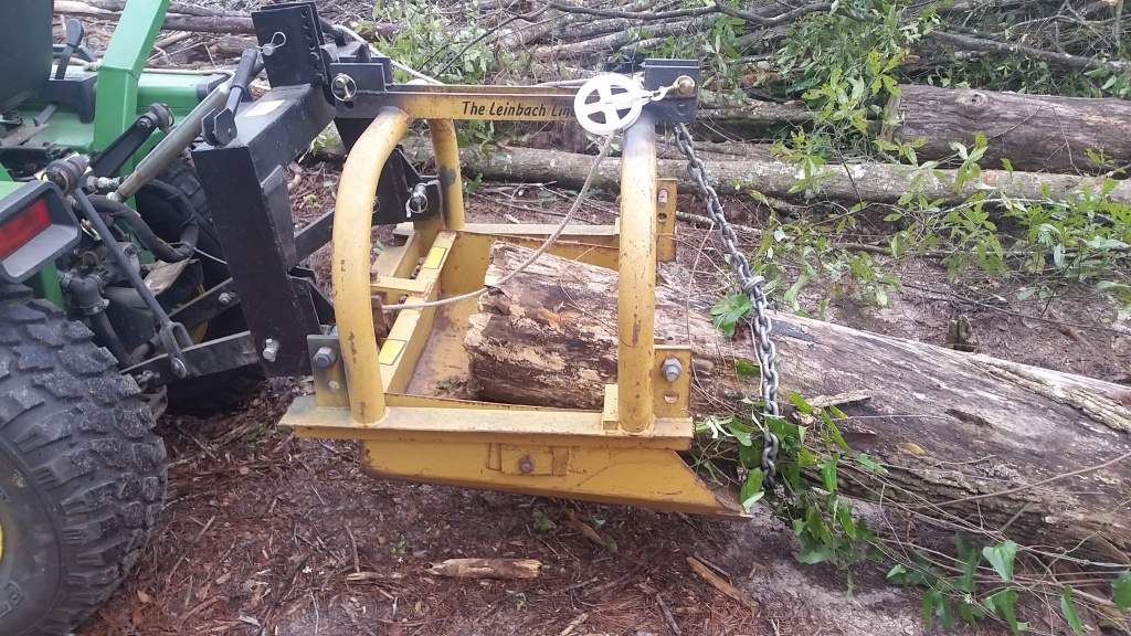

I have skidded a lot of logs from the bush using a 3pt receiver hitch similar to the picture in post #2, and a hook at the top link attachment point to hold the lifting chain..
You ALWAYS, ALWAYS skid with another chain to the tractor draw bar..
Our old woodsman neighbor estimated some of the logs were about the weight of the tractor.. Again... ALWAYS pull with the draw bar.. Only lift with the 3 point..

Why not pull with the 3 point hitch?
Pulling from drawbar keeps both ends of log in the dirt. All of log in dirt actually, chain saw gets more dull, log more likely to snag a root or stump, log pulls harder, rear of tractor has less weight/traction to pull log.
I agree that you shouldn’t pull with 3 point (or 2 point) hitch with connection point raised higher than axle or tractor can do a backflip. I can see that when pulling with a boom pole, it’s almost impossible to pull from below axle, and flip danger increases.
...but aren’t tractor’s made for pulling with the 3 point hitch (plows for example)?
You missed the portion of LIFT WITH THE 3PH
The reason for pulling low is to keep all 4 tires on the ground.
Go find a farmer that has large ground engaging equipment (disc, land planes or others) these have hydraulic lift systems and are pulled by a drawbar not the 3PH.
You may still need front ballast pulling low, but you have at least kept the downward pulling force low.

I always used a back blade on the 3 point turn your blade backwards hook your chain to the rear of the blade.mine had factory holes where you adjust the angle of the blade I used one of those holes with a clevis .you dont have to worry about flipping over backwards if the log catches something if your blade is a foot off the ground while skidding your front end will only raise about six inches before the blade will come down and hit the ground and once you get a few pulled out you can shove them out of the way with the blade being turned around backwards. I strongly recommend never skid a log off the draw bar or any kind of implement that wont cone down to contact the ground stopping you from going over backwards because it will happen in a split second you won't be fast enough to push in the clutch to stop it from going over I used this method for thirty years without one having a close call going over backwards
The only issue with your reasoning process is that few compact and utility size tractors have any down pressure on the 3PH, so when you tip the tractor for the rear blade to contact the ground, the blade may slow your tip or may not. This is the very reason that so many people think a trailer mover is a great item and find themselves in trouble when they have light tongue weight or a unsecured load shifts rearward.
Just go out to your empty 3PH and lift upward, most folks are shocked at how easily it lifts!
