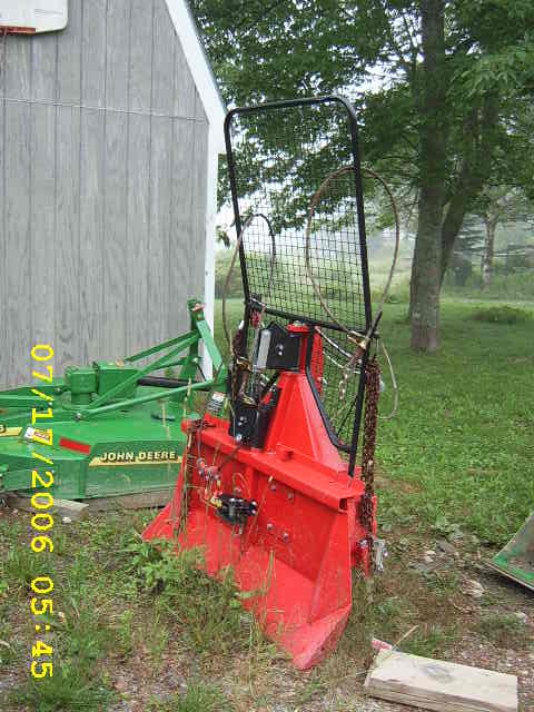

Hi catvet,
If you are sure about the hydraulics route for your PT: Tajfun is making hydraulic models of logging winches also... and yes, they (all hydraulic ones) are a lot more expensive, but save you modification costs.
Here is a picture of mine--a 40a (4 ton model). Mine is regular PTO one, and I liked the model & price (~3k) well enough to opt for it over Farmi & Fraansgaard.

Thanks for the ideas. I'm thinking you are correct about mounting the winch to the front end. My thought is to get a logging arch to pull the logs out so I can minimize damage to the woods. I figured a hitch receiver on the back of the tractor would take care of that.
Yes it is the TimberKing 1220 mill.
Jerry
