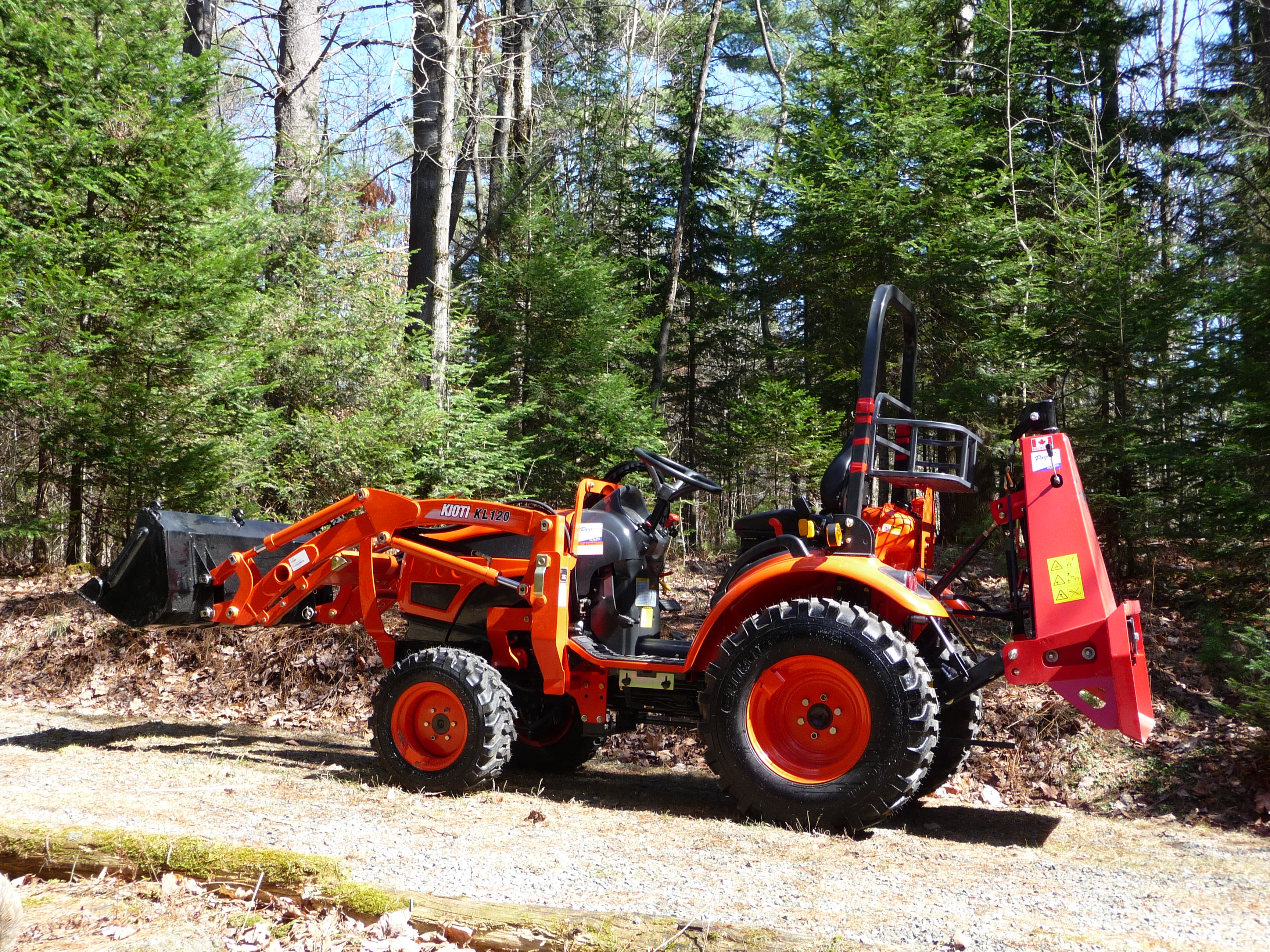

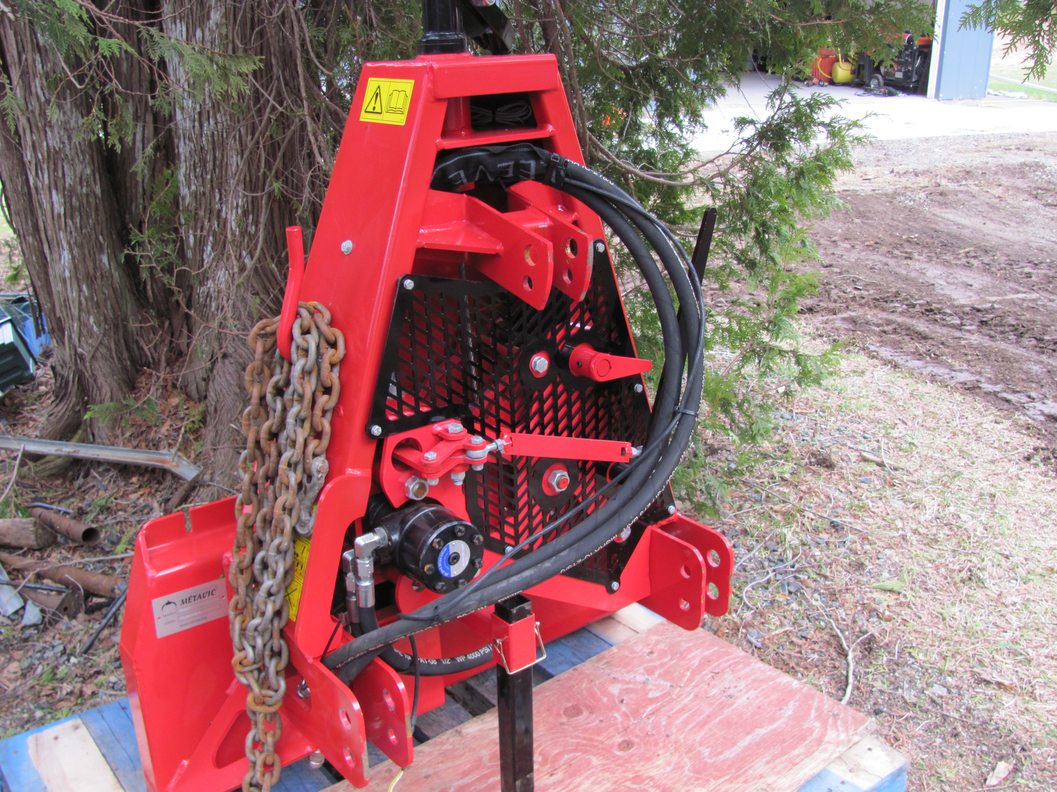

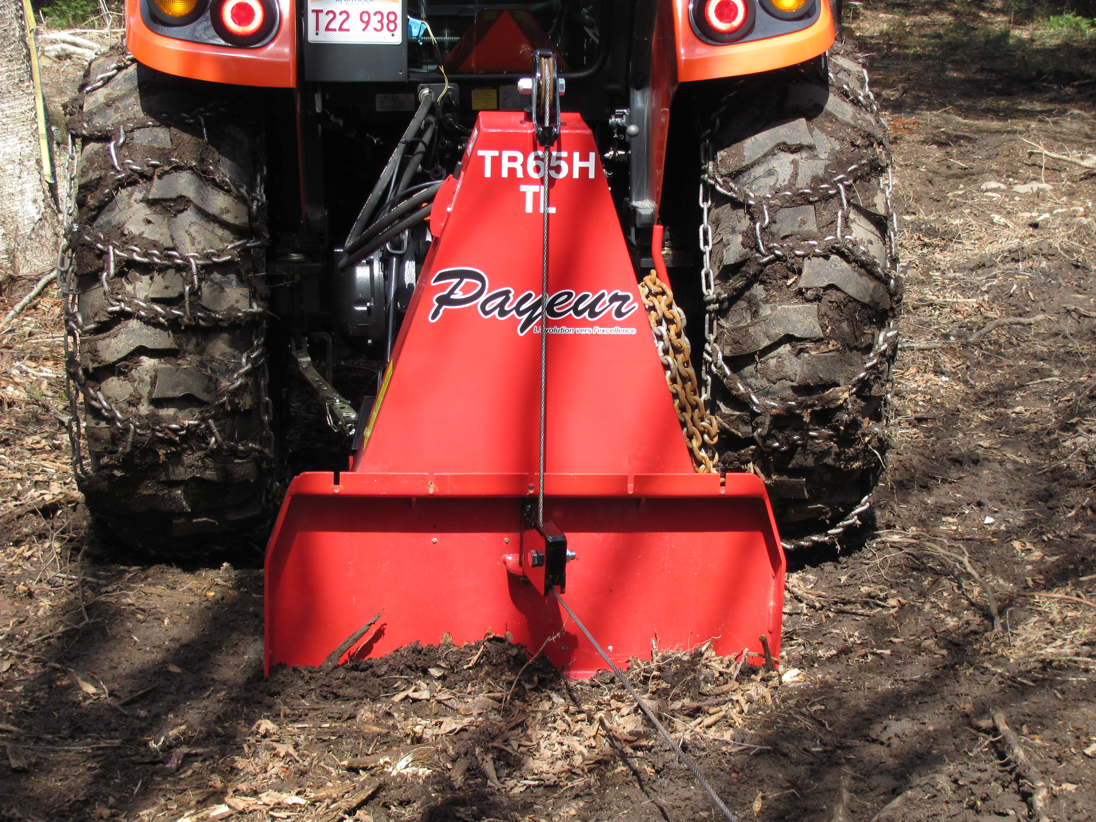

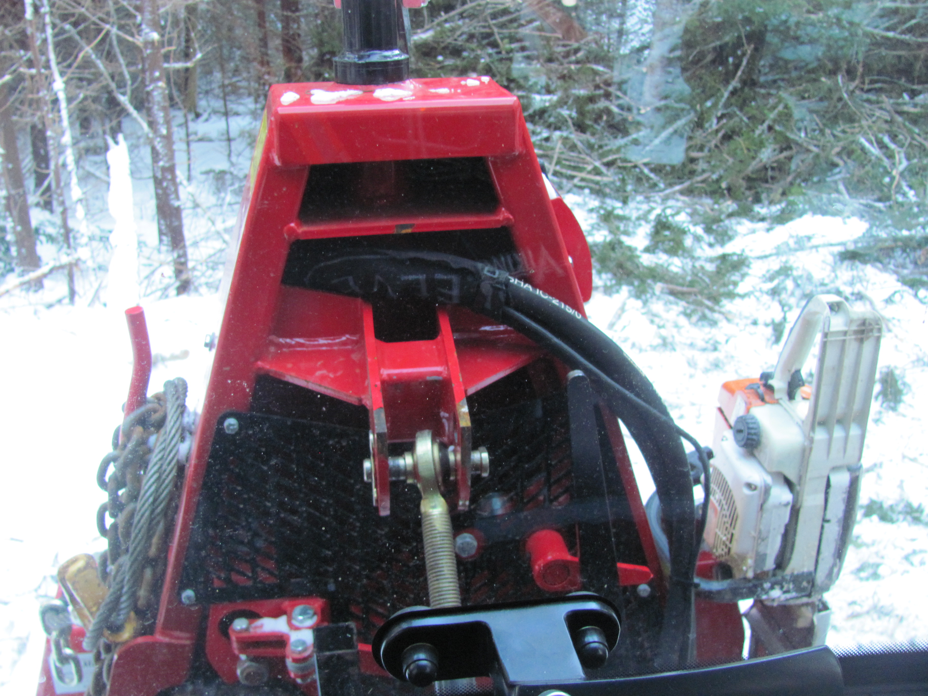

My hydraulic driven logging winch has a max speed of 2.4 feet per sec., about half speed of a comparable pto driven winch.
And I intend to use it this afternoon. I usually run the tractor at 1500 rpm while using the winch.
