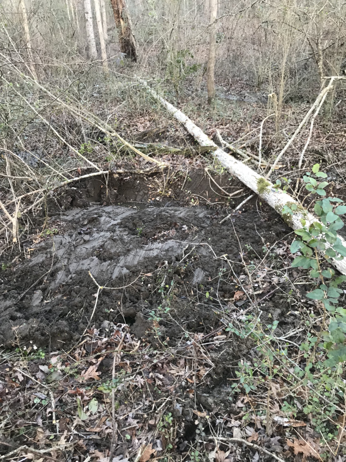

What size tree does it take 9000 lbs to move? (I realize it's going to vary with terrain)
It takes a lot of power to move them when they sink in the ground when they hit. IMG_1098.JPG My 15000 pound winch struggled to break this one free from that hole. Edit that picture is misleading. There was a 40 foot long 25” butt diameter white oak there. I had to cut the smaller tree to get it out.
