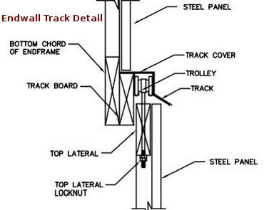

I am about to start construction on a 30'x40' pole barn. I'm trying to get all my ducks in a row before I begin. I think I've got a handle on everything but the door details. I plan to use a 12' wide sliding door (2 6' panels). The plan is to make the two door panels out of steel tubing and cover (siding not decided yet). I'm not sure how the track attaches to the building. It seems like I would need a slot cut in the siding panels for the track to protrude through.
My thinking is to use a 2" x 12" header then nail a 2" x 4" to this to mount the track on. Would the siding just butt to the 2" x 4" and attach to the 2" x 12" then use a piece of trim to cover the track?
Does anybody have a picture of how the metal panels meet the upper door track? I have searched on the site and can't find anything that shows exactly what I need to see.

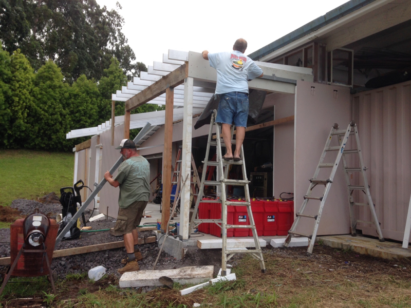

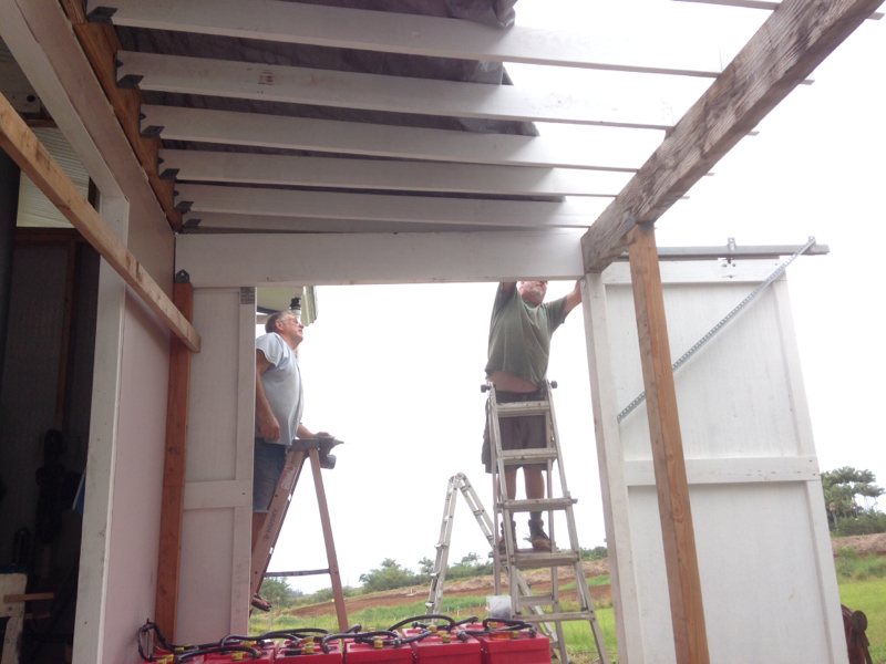

Not sure if this will give you what you want to know, but maybe a help. This is a set of doors I removed from there original location and repurposed as a sliding wall so to speak. Gives me great access to my batteries from outside. Not an exact fit, but does the job without wasting the material. They actually fit the opening perfectly, just the slide area is a bit different, about 6 inches short one side and no wall the other.
These are 2 sliding doors I made using 2x6s and 4x9 Hardie panel. Track is galvanized, each section is 8ft. Track has hangars that just bolted to the header. I did have to fashion a brace to support the non wall end. Doors are actually rather heavy.
David Sent from my iPad Air using TractorByNet

I don't have metal siding, but my wood exterior siding is contiguous from roof to ground to the side of the door and to the top of the door at the door opening. On the inside I have support 2x12s (I think) fastened structurally. I then lag bolt through the siding to a track that the sliding door hangs from. The attached is not my diagram, but seems to depict what needs to be done.
