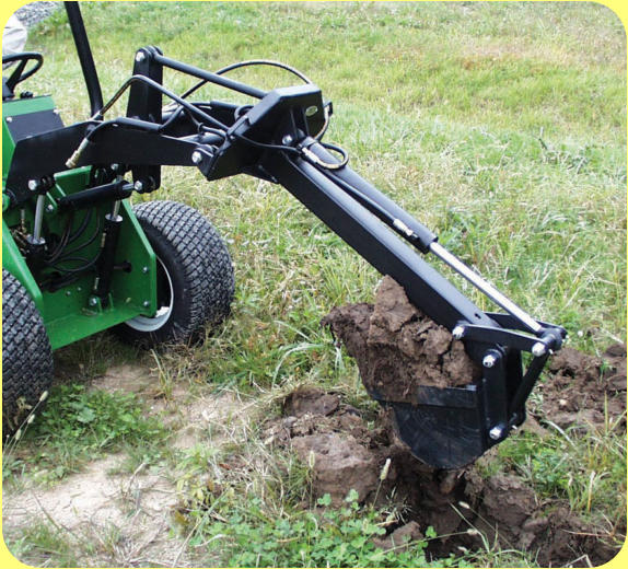

Respecting this is the PT forum you should consider getting a backhoe too. Also with your stated needs take a look at the Kubota BX-25 series with a Backhoe and Thumb for those rocks, building walls, digging trenches, and the occasional digging for plantings. Your usage is very similar to what I use my machine for here in NH where we grow new rocks every spring, and I use the BH to pick and hold logs for cutting and more.

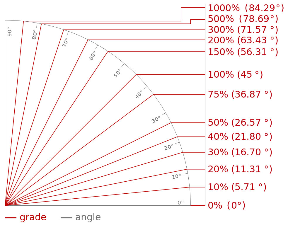

My PT422 will do a 20 degree slope which is more than 20%. If you go more than that the engine will not get enough oil.

A 20% slope is only an 11.3 degree angle. A PT425 with a bucket full of stone could go up that without issue. Pulling a trailer is a different story.
