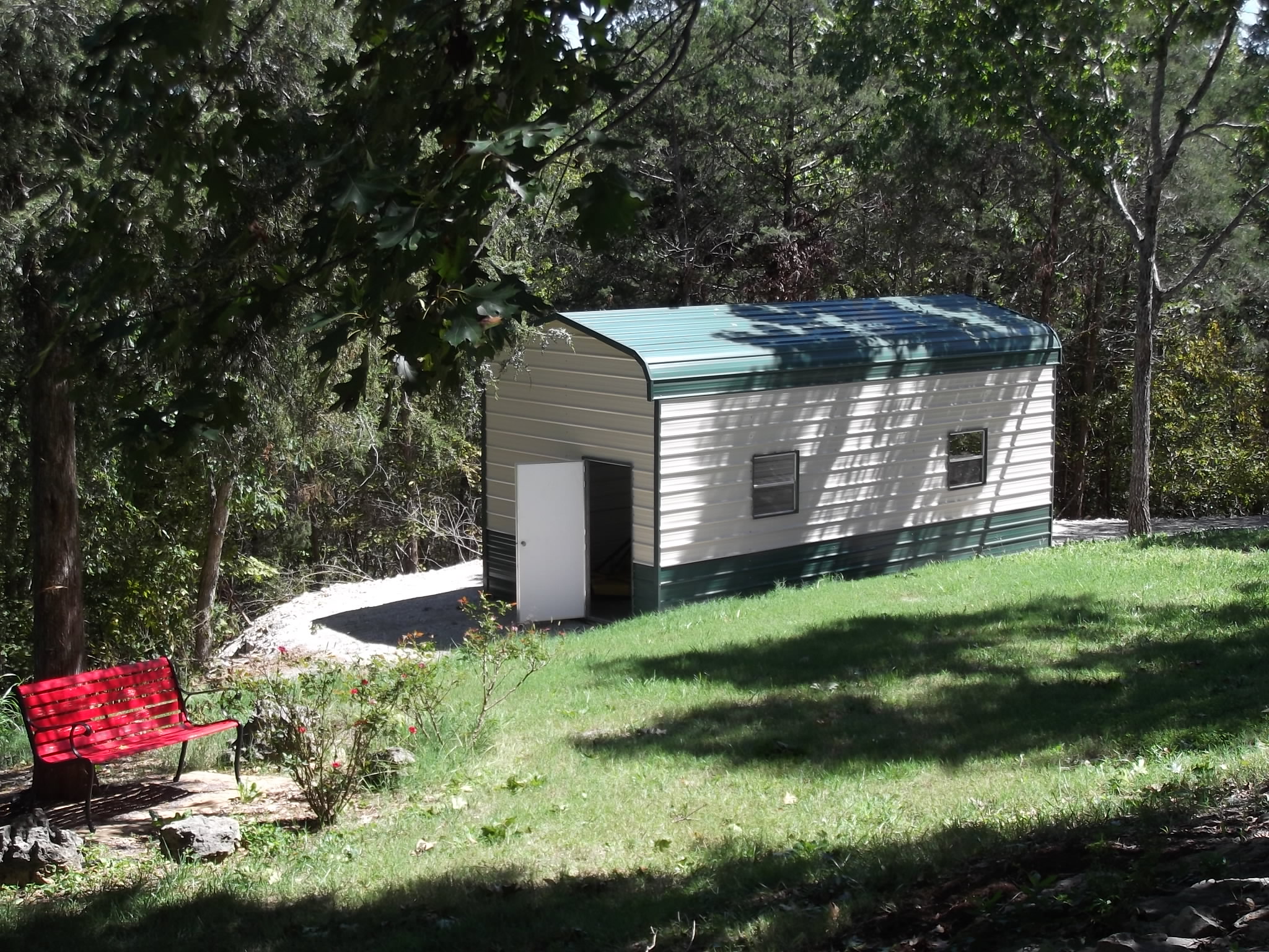

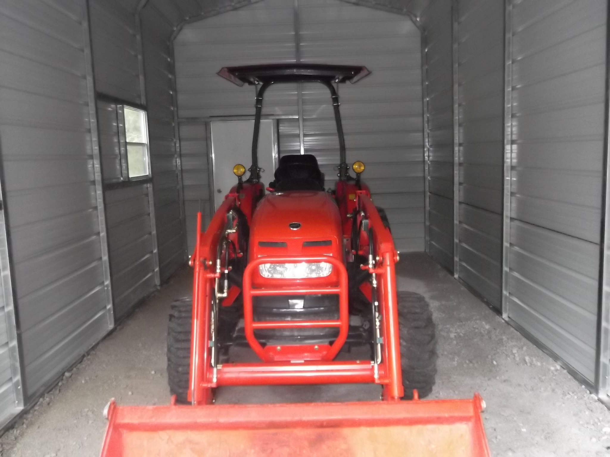

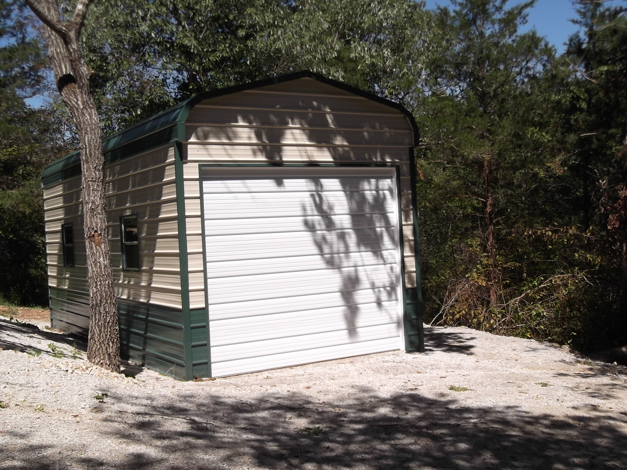

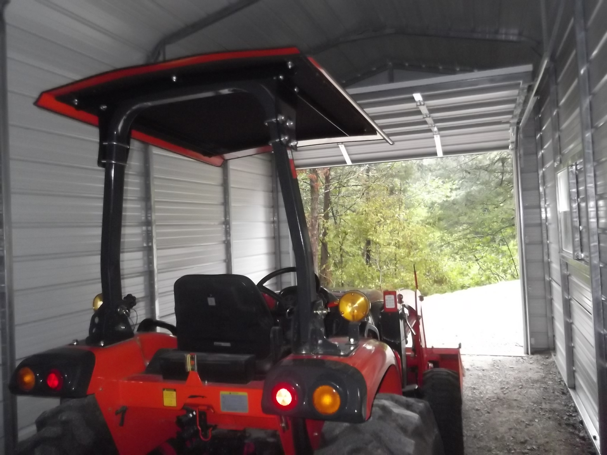

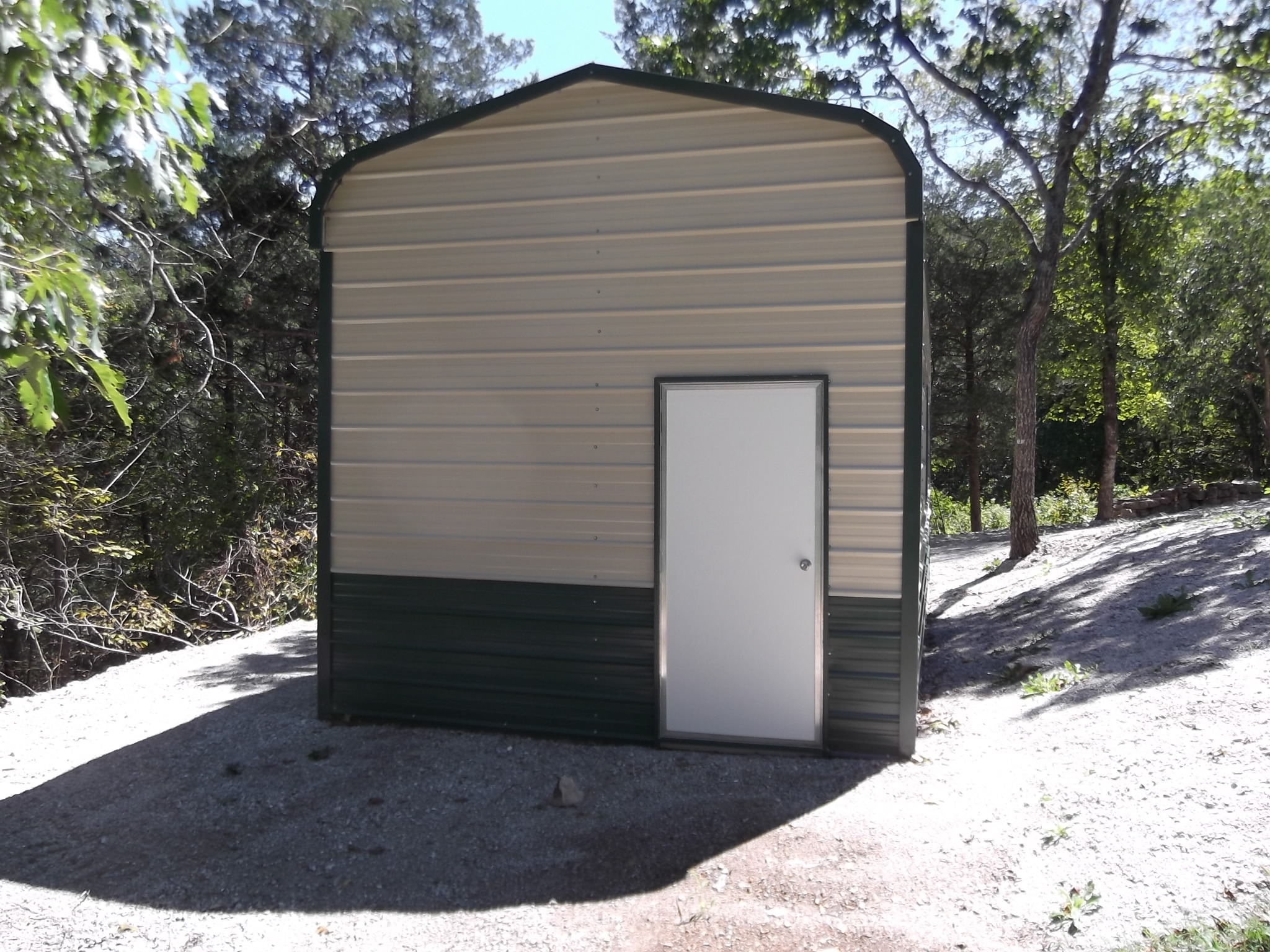

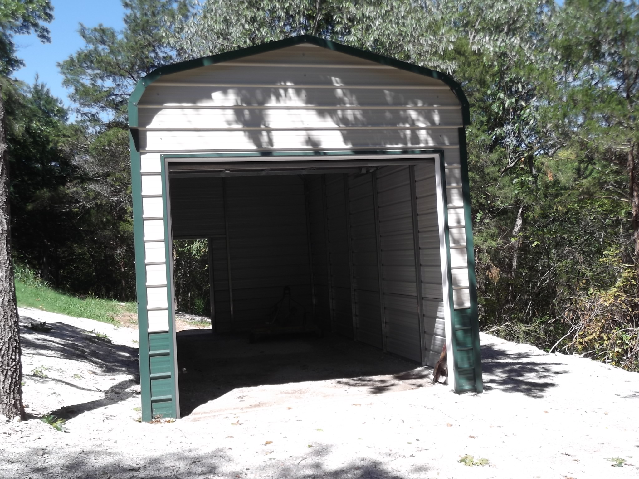

This is what I have. It is gravel, This barn was about $5000. built in a day. It is a Carolina Carport. It is 14x30. I wish it was wider.

One little nugget of info. Make sure if you build a metal barn with a gravel floor, you put in a lot of roof ventilation. If not it will rain inside your barn from condensation. I retrofitted ventilation in the ends of mine and it stopped about 95 percent of the condensation, but roof vents put in at the time time of installation would have been better. The day/night heating cooling cycles is what causes the "rain". I am sure a concrete floor with vapor barrier would have helped a bunch, but I could not afford the concrete. It took a lot of money to even build the gravel pad being on a bad slope like mine was.
So to sum up, concrete would be better, but gravel will work. Put in lots of ventilation and all will be well. My tractor has enjoyed its little "kioti den" for some time now. It keeps the weather and the sun off of my investment.
