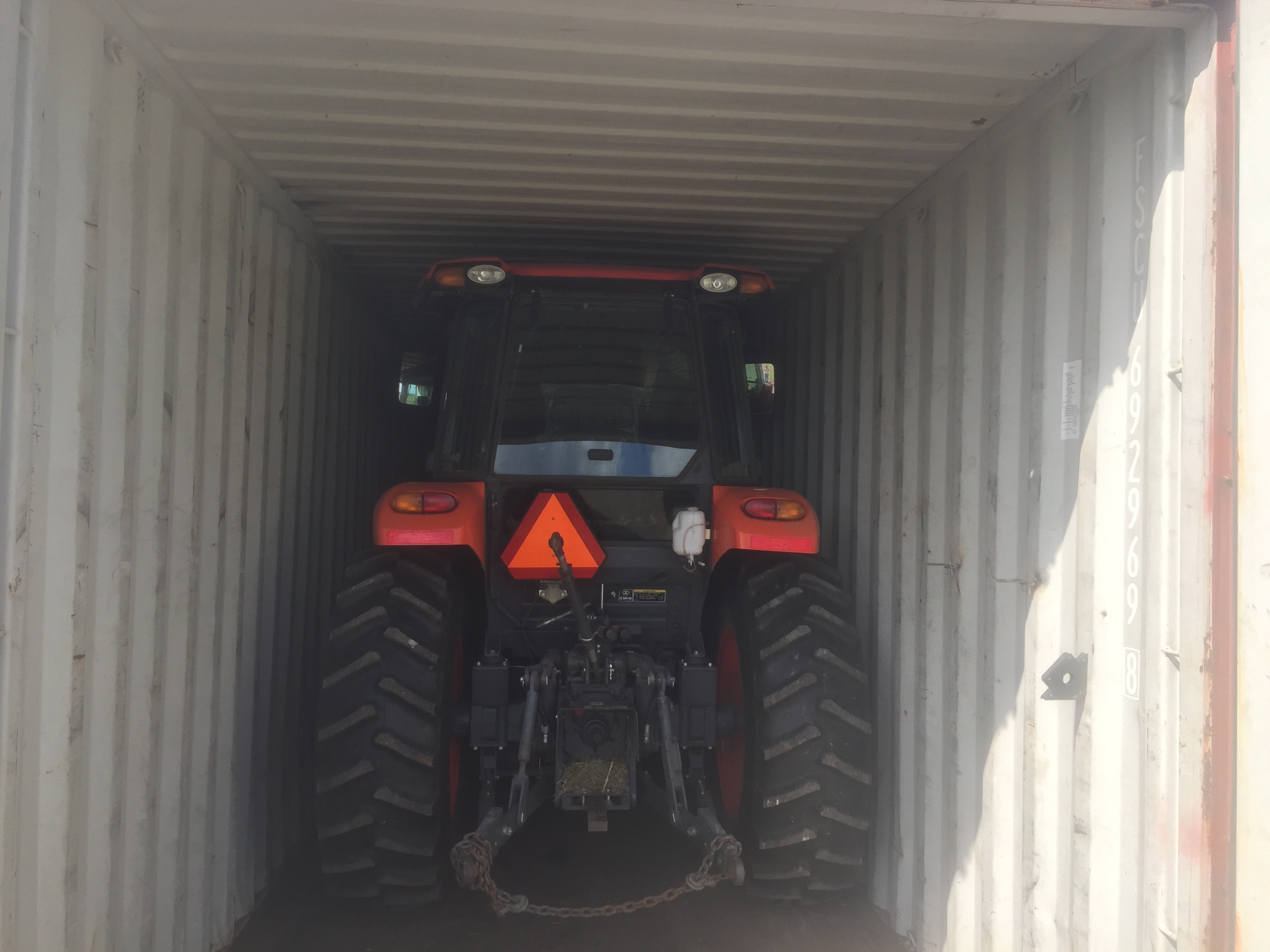

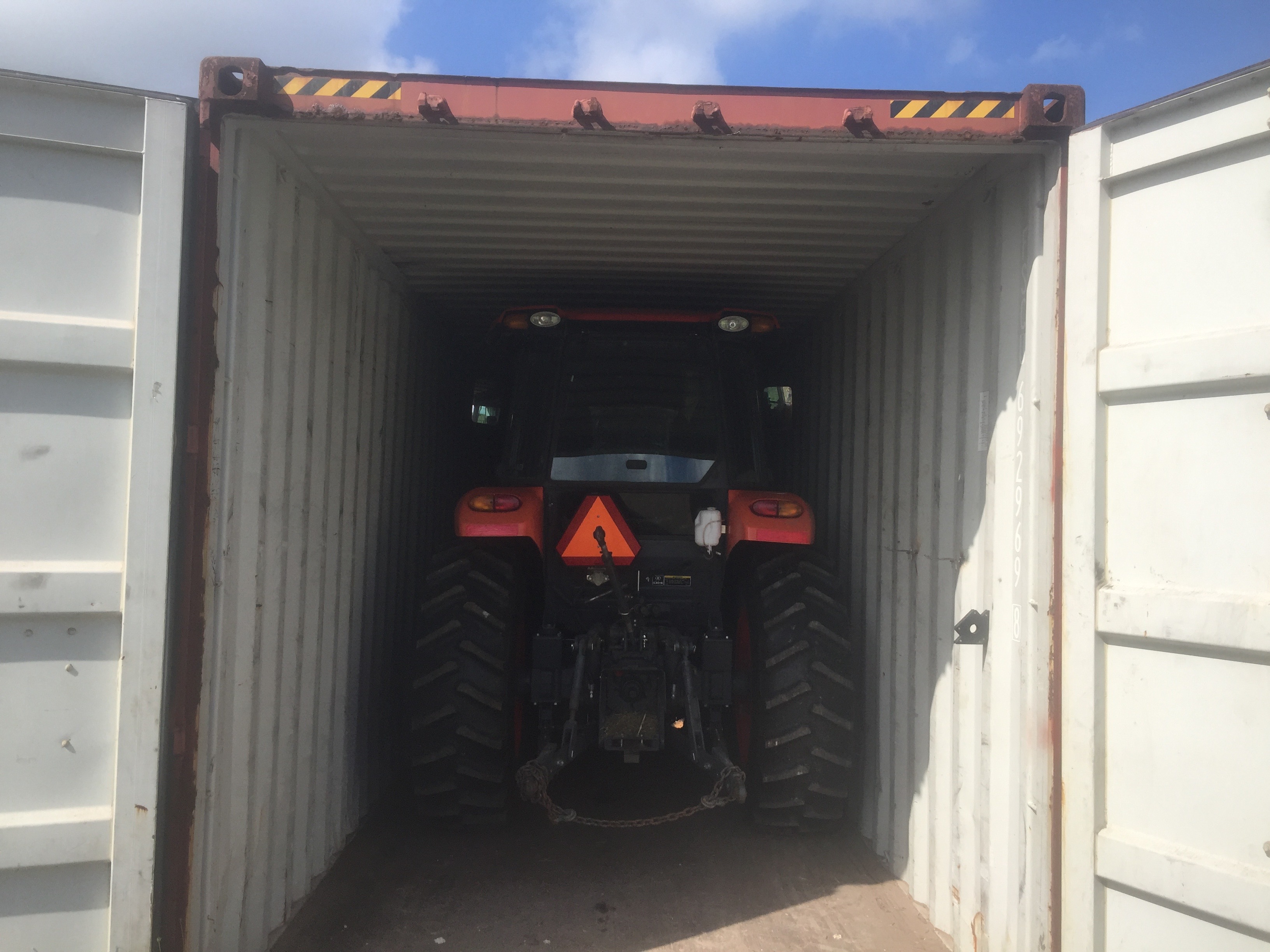

My solution was a 20' shipping container for my 29hp Kubota w/ loader and mower. Secure, dry, bulletproof. Make sure you put down a plastic vapor barrier. If you need more width, bolt/weld a couple together and cut out the walls w/ a "hot wrench". If you need a door at the front end, or a window or two, cut 'em out. If you need a wider door, making a pair shouldn't be too tough (slider or hinged). You should be able to pick up a good one for less than $2K.

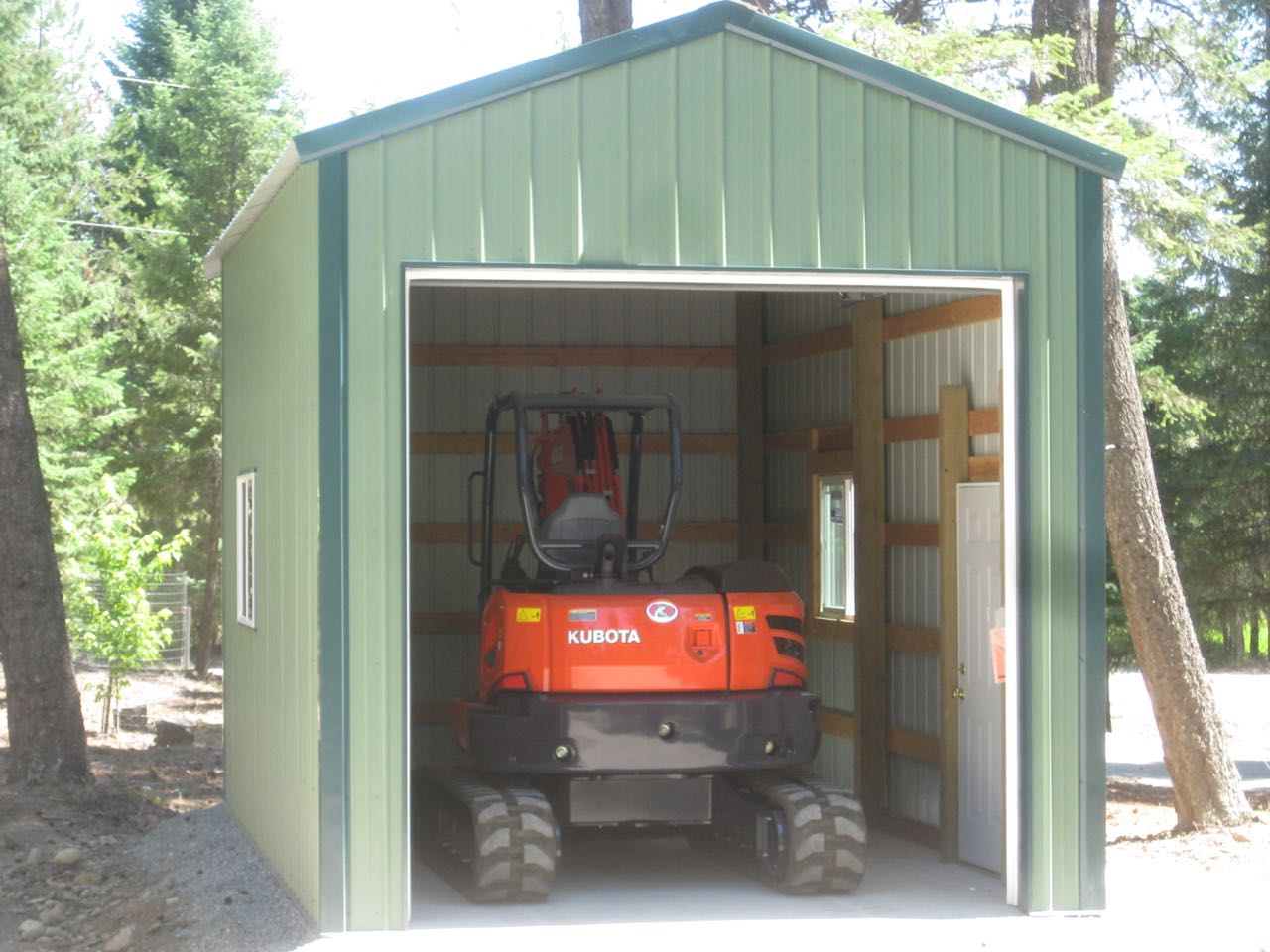

I had a small 12'x22' pole barn with 10'x10' door and 12' high walls built recently for my mini ex. I have more than enough room in my garage/shop for both the tractor and mini ex and attachments but it only has a 8' high door so the mini ex wouldn't fit.

Nothing Better!!! plus the tractor will still look showroom new whet it's time to sell. The sun and elements does a lot of damage to equipment. You can also move the " barn" if you sell the property .

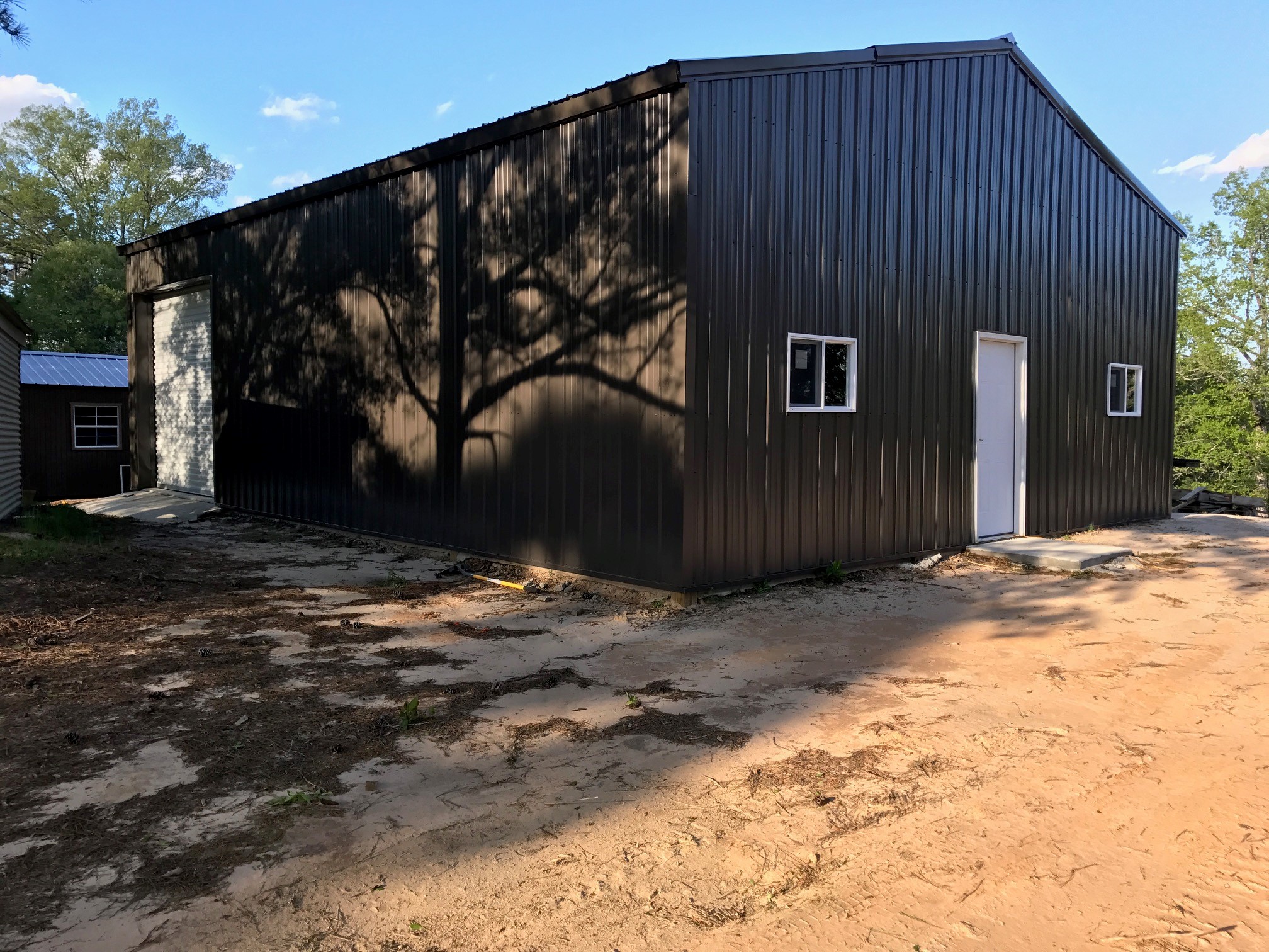

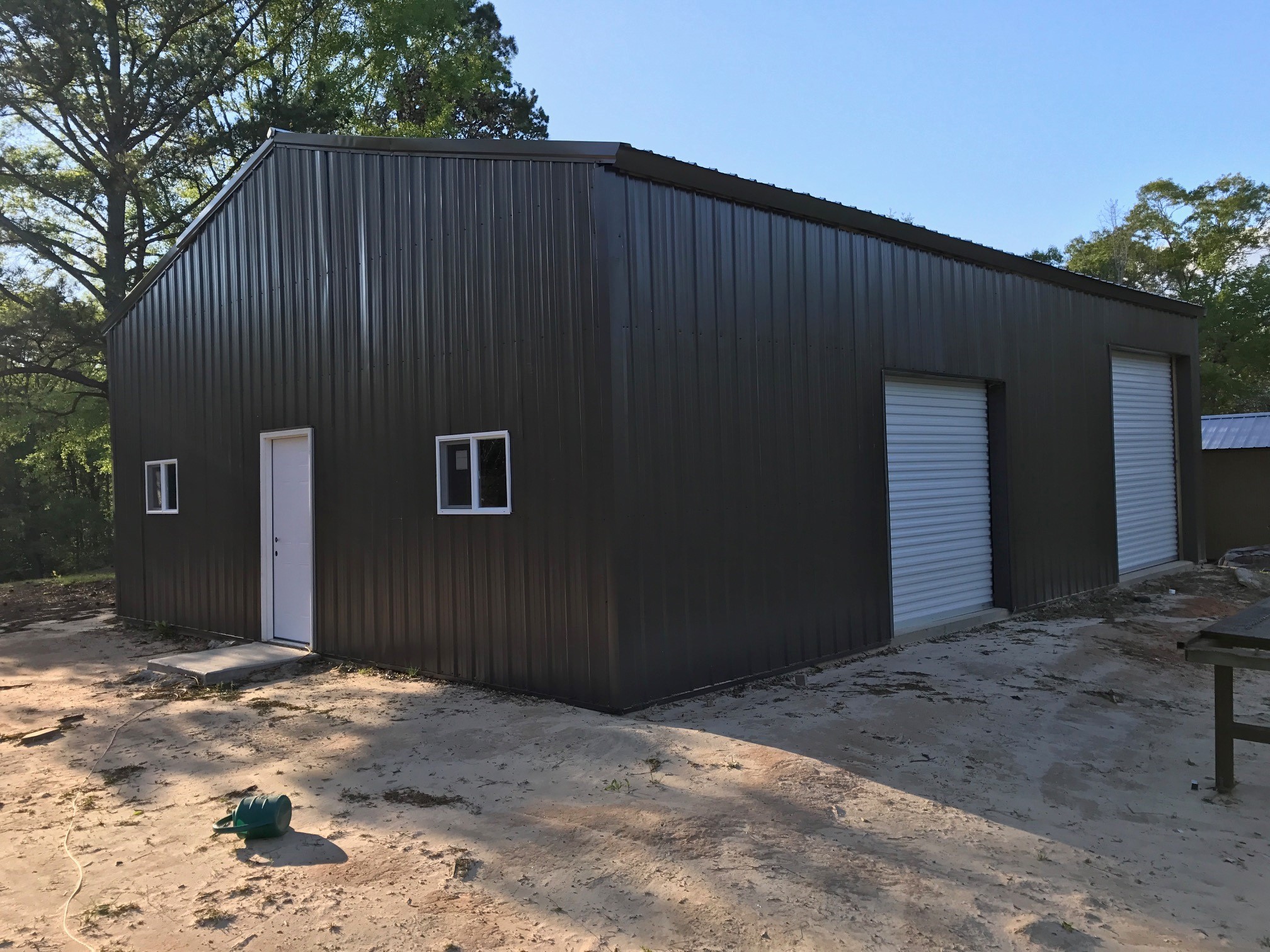

Shop pic 1.jpgShop pic 2.jpgThere is no question you can save several thousand by building yourself. I built a 30x40x12 with 2 10x10 roll up doors and one 8x10 roll up door on a 4" slab for 10k. The cheapest kit for the same size with slab was around 17.5k and that was only with one 10x10 roll up door.

You are VERY fortunate (and have a nice barn). For that cost / size where I live, I could do the floor and one door!

Thank you! Now if I can just ever get time to do anything with the interior. Trying to build a shop and renovate my house at the same time šŸ˜‚.
