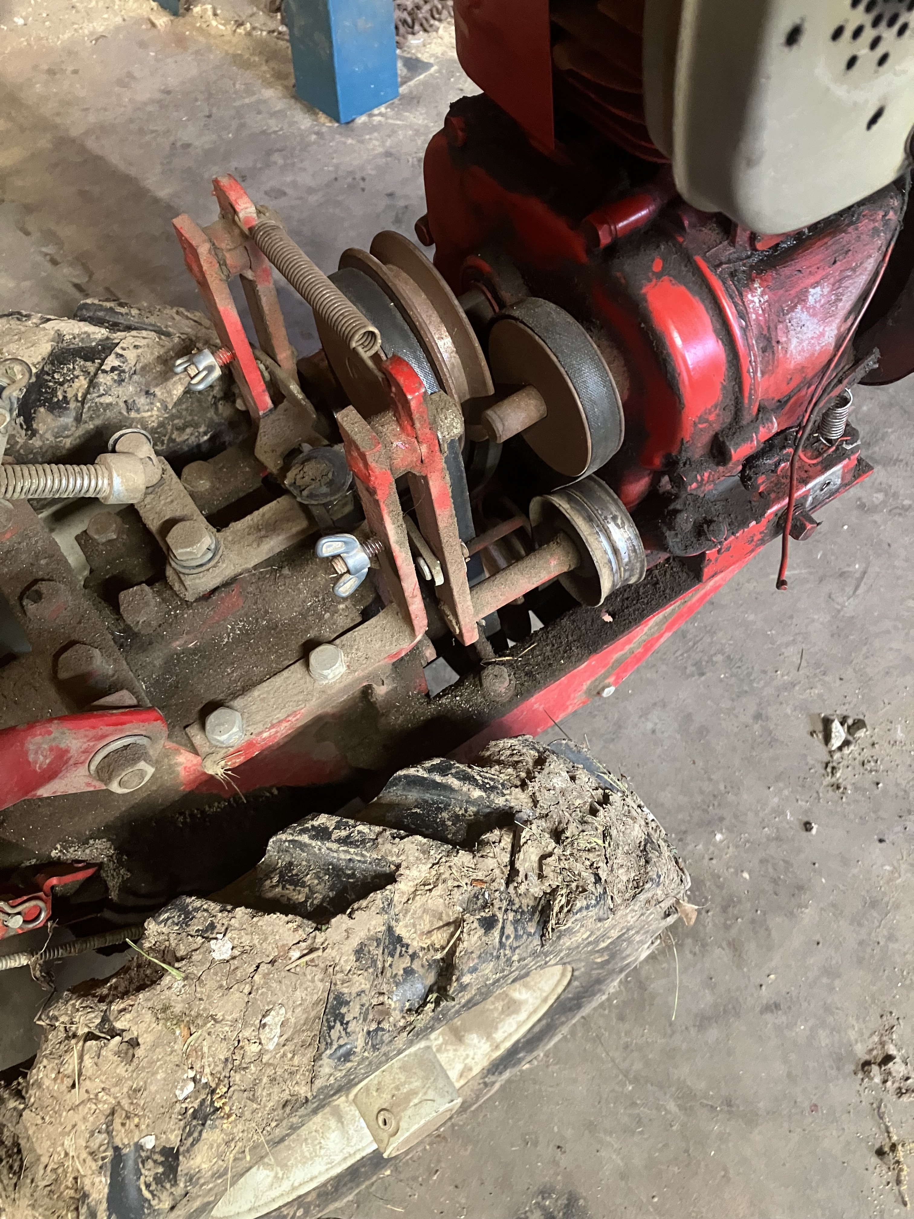

We threw in the towel on this tiller for now. He got the gas tank lined and cleaned out and I think the carb is ok but I’m not 100% sure. The spark plug turned out to be bad. It runs now but very poorly. The mixture screw does nothing, you can remove it from the carb completely and it doesn’t run worse or better. My friend sent a video to someone he knows that used to work at a lawn mower place that closed down recently. He is suppose to get a shop open in the fall, we’ll see. He thinks it’s a problem with the valves.
Looking at the engine number it was made in 2001 so it shouldn’t have points.
Correction, he wrote down 01 for the year, but I bet the 0 is an 8 so it was made in 1981.
/ Small engine with points? #27
Here is a picture of it. The larger pulley on the right part of the engine case is part of the reverse setup. I’m not sure but I don’t think it’s a powered shaft but it does go into the engine. The main drive shaft has two pulleys and the belt can be swapped for slightly higher or lower ground speed.
If the pulley to the top right hand side spins freely without the belt, I would think it is just an idler pulley. Would be great to have this tiller running because there is still a lot of garden weeding season ahead.

I’ve messed with it some more. We put a diaphragm in the carb. It starts a runs sort of. If you turn the tines on it dies after a few seconds. Eventually it wouldn’t run at all. We got new gaskets that go under the carb and above the gas tank but it’s still leaking there. We think that might be making it run poorly. We are going to try some gasket sealer.
/ Small engine with points? #29
Did the owner leave ethanol gas sitting in it?
There are a couple of Pony repower videos on youtube, but the ones I checked werent able to get the reverse to work.
Maybe more importantly, there are other videos saying the carb is likely the culprit when these wont start or run badly. They pull fuel from tanks under the carb so a leak could mean it isnt able to draw fuel up into the carb like it needs.

Yes he left ethanol fuel in it over the winter and it wasn’t full either, a bad combo. There are two tubes that drop into the tank, one long and one short. The short one has a little chamber it sits in. It’s my understanding the long tube brings fuel into the little bowl under the short tube. I can see how a leak would prevent that from working correctly.
I’ve watched a couple of YouTube videos on the carb issues.
It’s become a little bit of an obsession to get it going.

I bet it needs a good carb cleaning with attention to all the gaskets and fitting, jets. tubes, airways and passages.
I've had the carb off twice over the years. First time because I jumped the tiller off a 4 foot retaining wall. That was fun! The tiller landed on the fuel tank side and pulled the carb body off the engine. (bent the flange)
The second time was about five years ago. Routine cleaning...
That and confirm the valves are moving. (compression good?)
