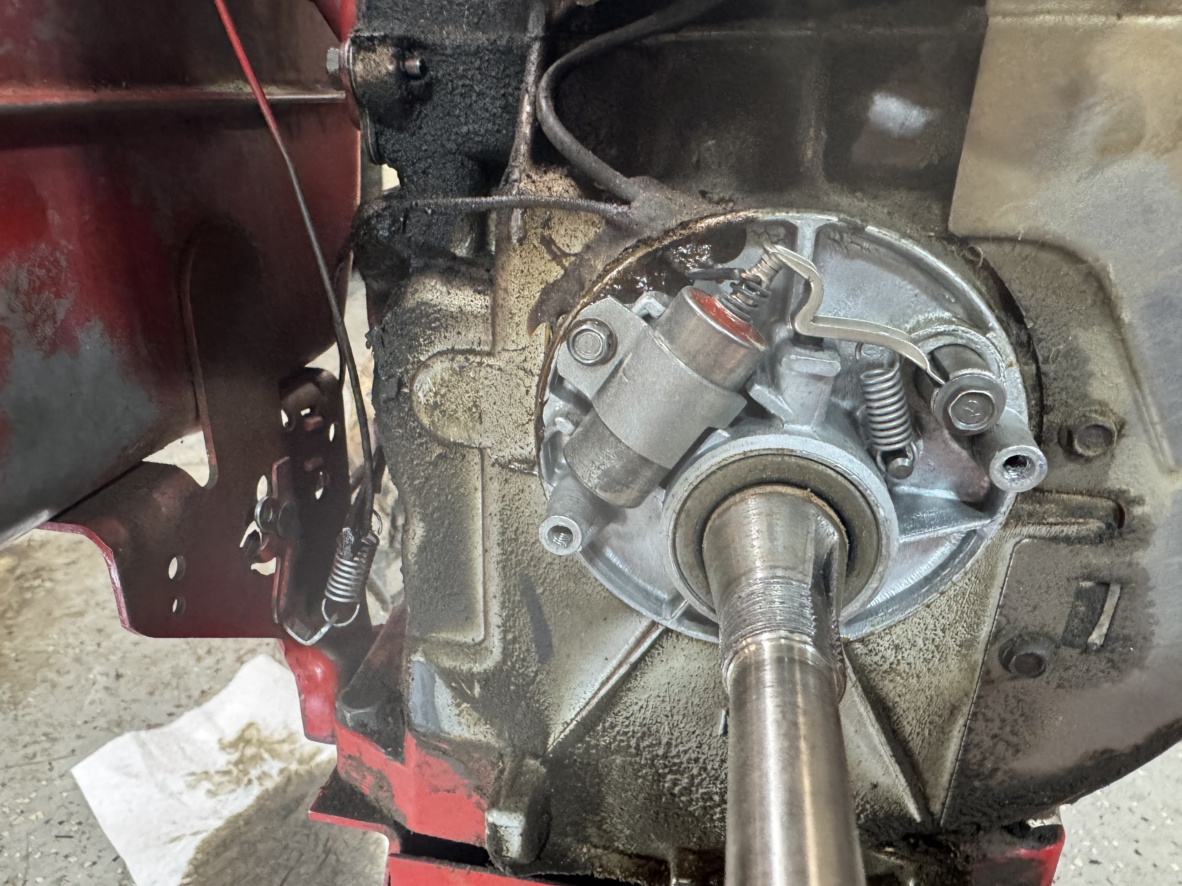

Oh, This is definately a points and condenser ignition, I've had the flywheel off many times over the years to clean the points.

I give up, I keep tearing into it deeper and just can’t find why it won’t run. I think it carb related but I still can’t make it run. I ran it on starting fluid but it won’t run on its own.
/ Small engine with points? #43
No head and no flywheel, no wonder it won't run! ;-)
When confronted with symptoms like you have, I put some gasoline in a squirt bottle , expose the carb air inlet, and see if I can get it to run and stay running "on the drip".
That separates the "Is it fuel, or is it ignition" question. Always check for spark as soon as the flywheel goes back on. A strand of lint in the points, and the spark is no-go.
Everything looks so clean, it's got to be something small.
I assume you pulled the fuel tank off the carb body to make sure the lift tube is intact.

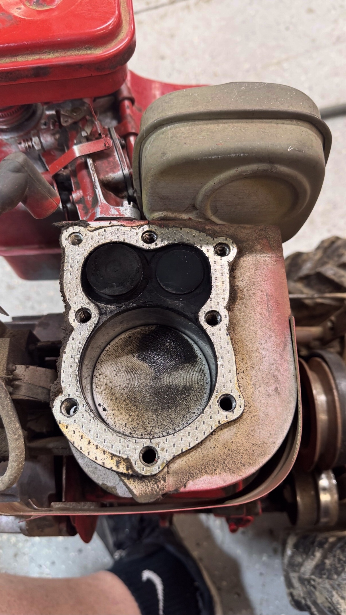

Since the intake valve is open put your thumb on top of the exhaust valve and see if it turns. And then turn the engine over to close the exhaust valve and then try to turn the intake valve. I will bet one or both will turn with just thumb or finger pressure, which means the valves are not sealing and you are loosing compression. Have worked on 3 in the past 2 weeks with this issue.

...the valves are not sealing and you are loosing compression.
This is one of the reasons I have never been a fan of the old flatheads. To get some clearance for the valves to seal, the OP will have to grind a bit off the ends of the valves.
I much prefer the OHV engines, where valve clearance is super easy to check and adjust. But these adjustments are needed way more often.

I have to ask, how does an engine that starts and runs on "direct injection" of gasoline have a valve problem?
I find it VERY difficult to blame the valve lash for an engine that starts.
If it ran for long enough time to heat the valves, lengthening the stems, that would be different.

Sometimes it isn't a valve lash issue. Sometimes the valve face wears to the point the surfaced don't make contact. Just worked on a Briggs 90102 a couple of weeks ago that had .005 IN and .007 Ex without touching the valves. Engine had 0 compression with a 80% bypass with leakdown tester. Found that both valves could be turned by the finger test.. After removing the carb/tank assembly could shine a light into the intake and see light around the intake valve.
That job required the use of my Neway valve face cutter and also the Neway valve seat cutter sets. And still had to hand lap the valves with grinding compound to get them to seat properly.
Symptoms of this engine was it would start on the first pull with choke but wouldn't rev up or continue to run even with full choke, but would pop off immediately on restart and do the same thing. The added fuel would create enough seal to ignite the fuel, but couldn't continue to build compression to continue to run.
No longer than it takes I pulled the head. Neither valve will spin when fully closed. I liked that idea but I don’t think that’s it.
I should also add that there is a small chamber under the short intake tube under the carb. That chamber is filling with gas on its own.
/ Small engine with points? #60
The valves appear to be sealing enough to not cause major issues. And that small well is supposed to fill with fuel. Basically the fuel pump diaphragm pumps the fuel from the tank into that well, and then vacuum created in the carb venturi caused fuel to flow up the short tube into the carb intake. Basically atmospheric pressure will only lift fuel something like 1-3/4 inch. Since the vacuum created can't lift fuel from the lower level of the tank.
