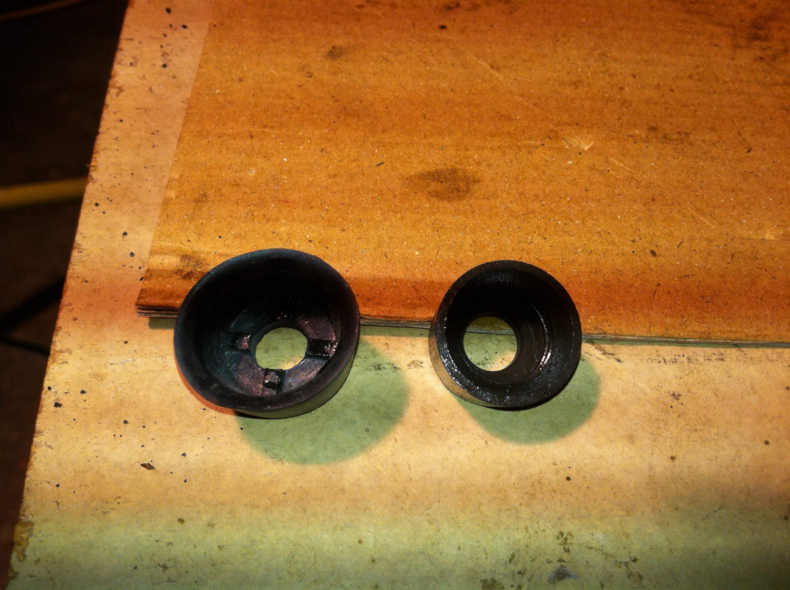

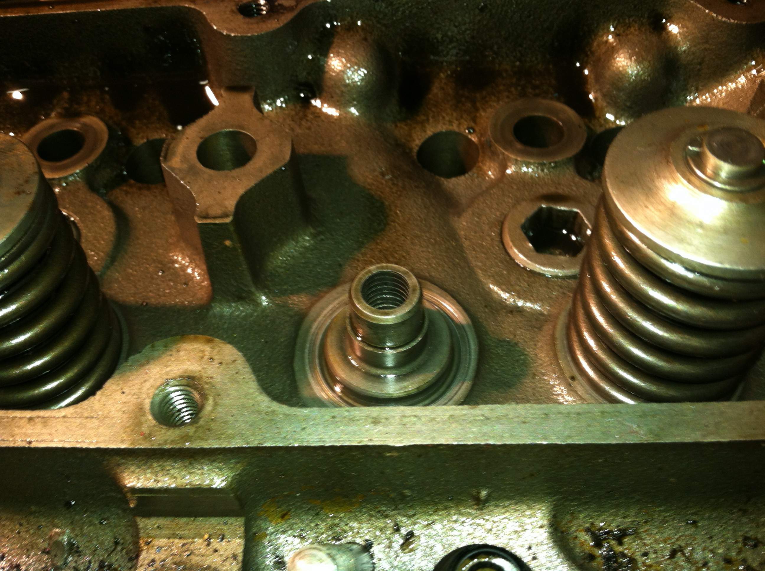

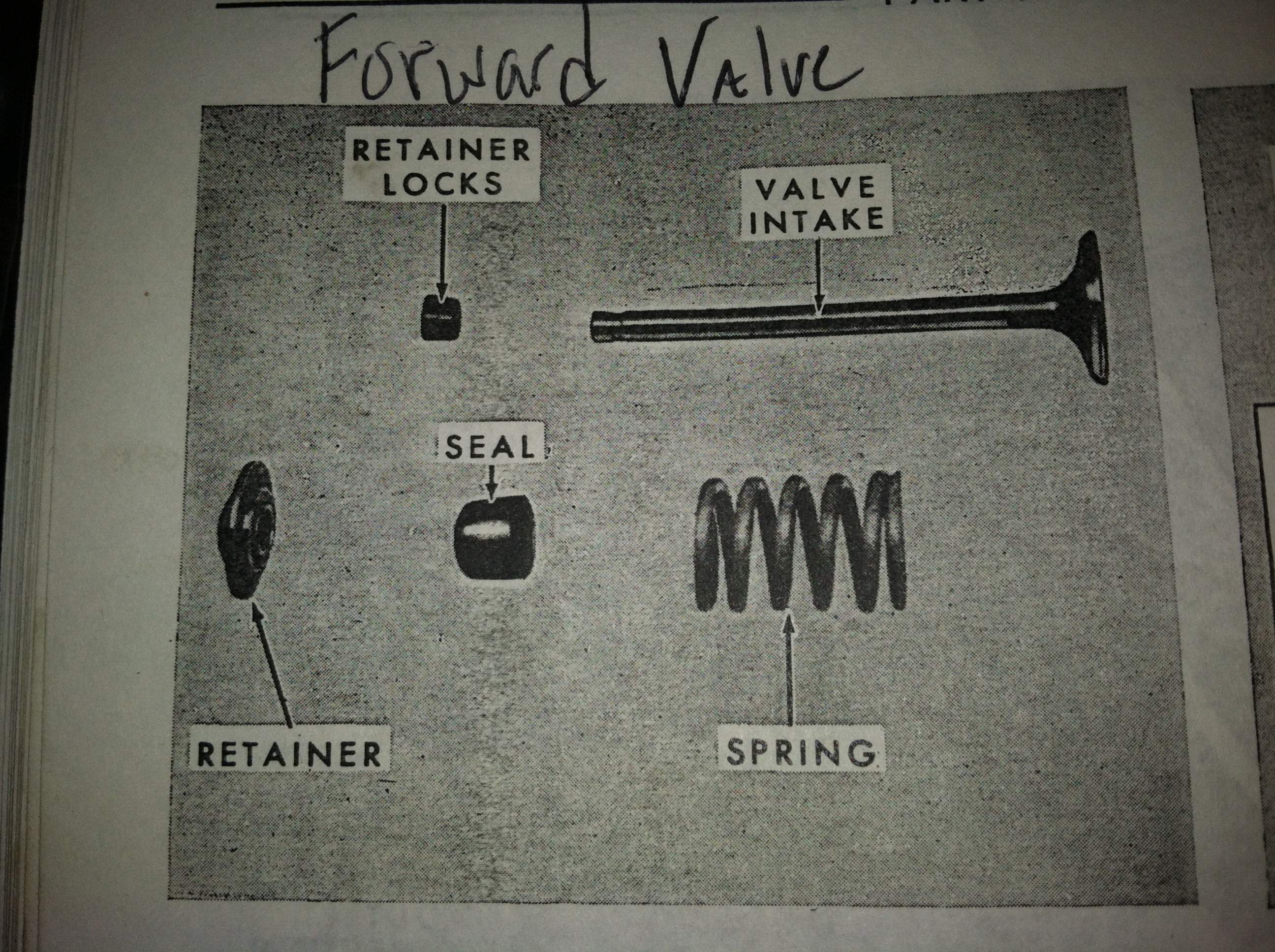

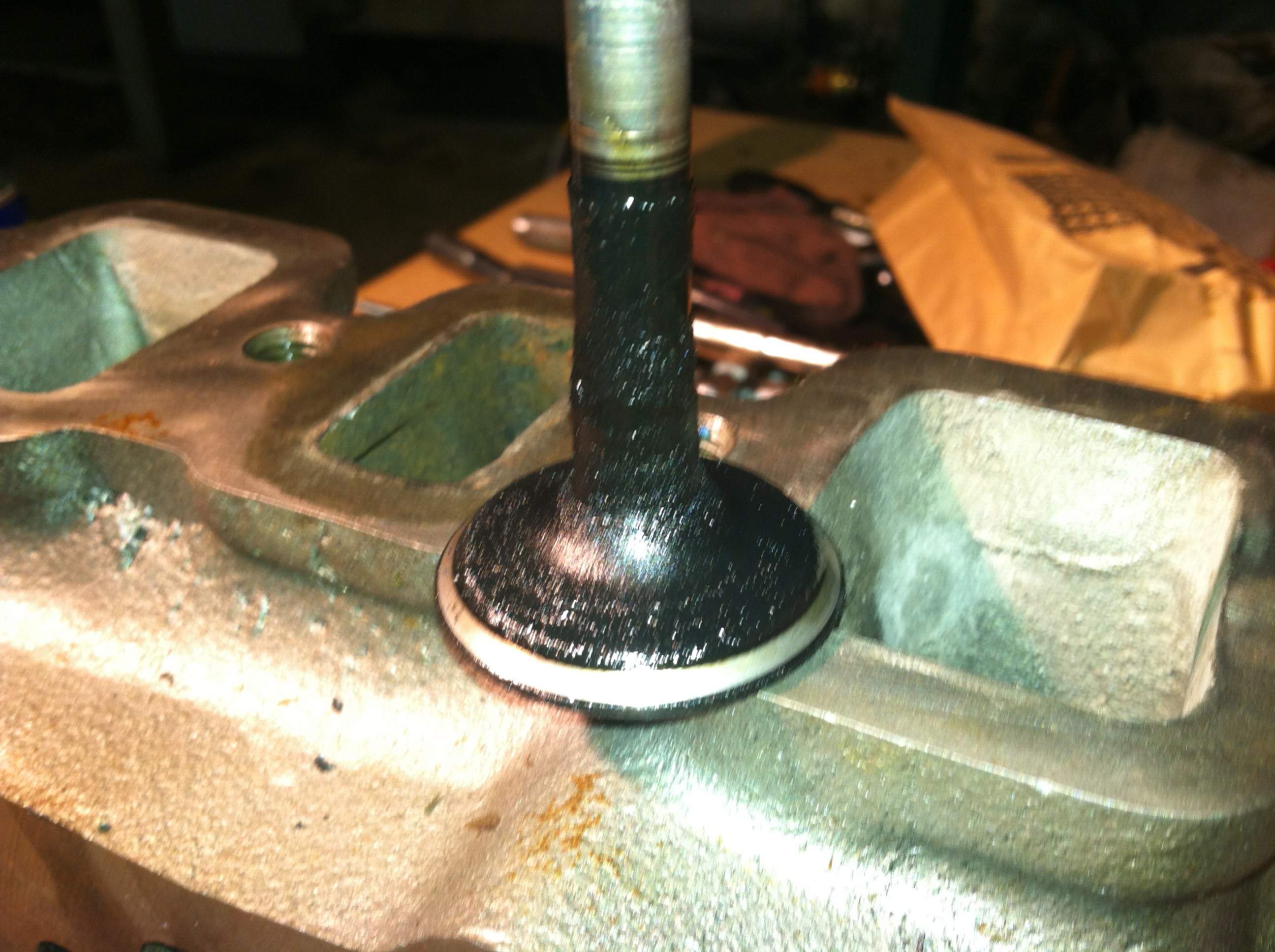

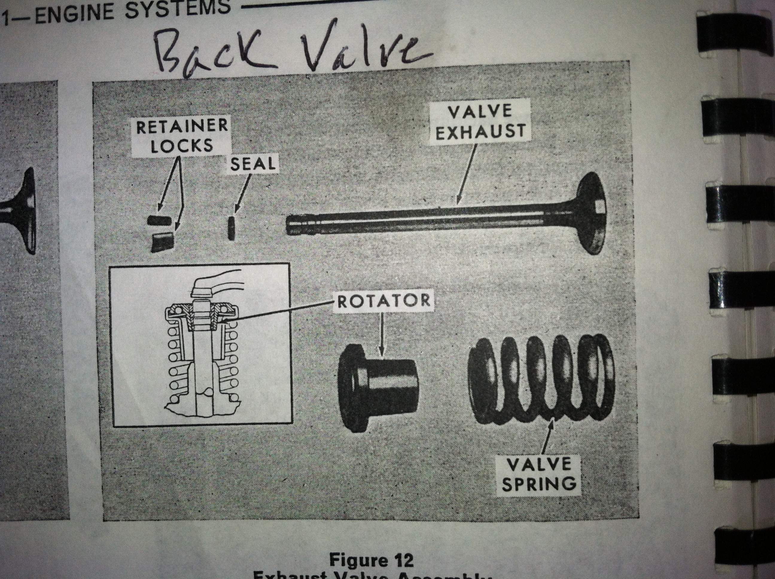

Hi guys. I took the valve springs off today and I'm a little more confused and reassured at the same time. The valves slide nicely in the guides and there is zero "wiggle" with the valve stem and guide. My confusion is the seals. I have new seals from the dealer and also from an after market tractor place that came with the rebuild kit. They are larger than the ones on the stems now. The manual shows a kind of umbrella type seal on the intake side and an O ring type seal on the exhaust side. I found the umbrella type on both sides and no O ring anywhere. The umbrella seals slide down over what I assume is the guide. The exhaust seal was quite hard to the extent that I was afraid I'd break it. The new ones are soft rubber. So I'm back to being not sure of what's wrong again. Here's the pics. Matt
This is what the manual shows.
this is the difference in seals. Right is old. Left is the new
Exhaust valve

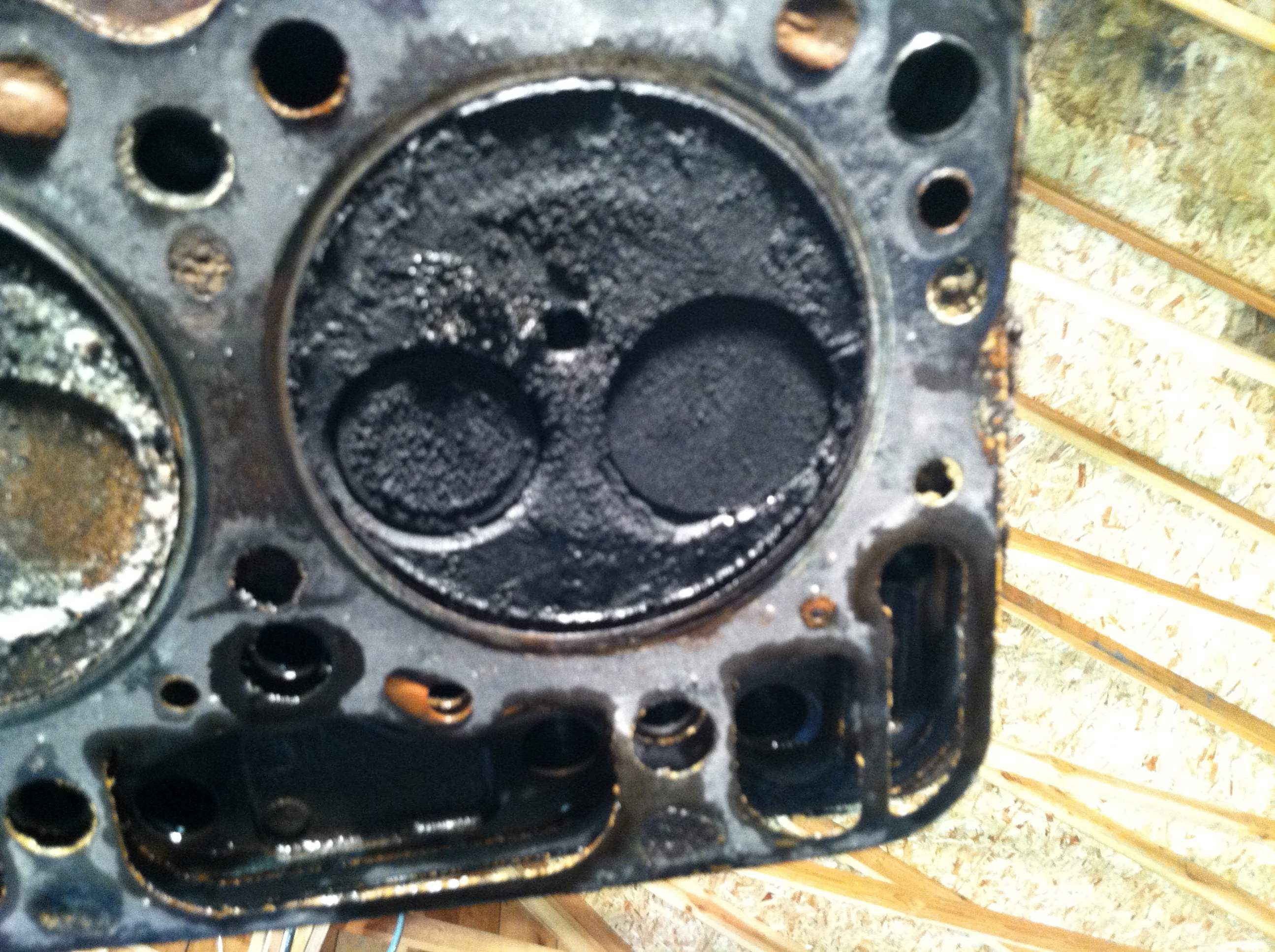

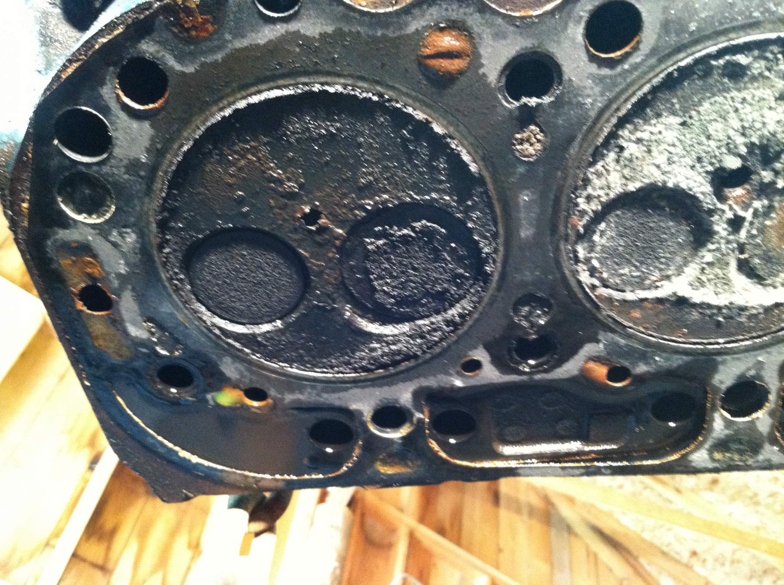

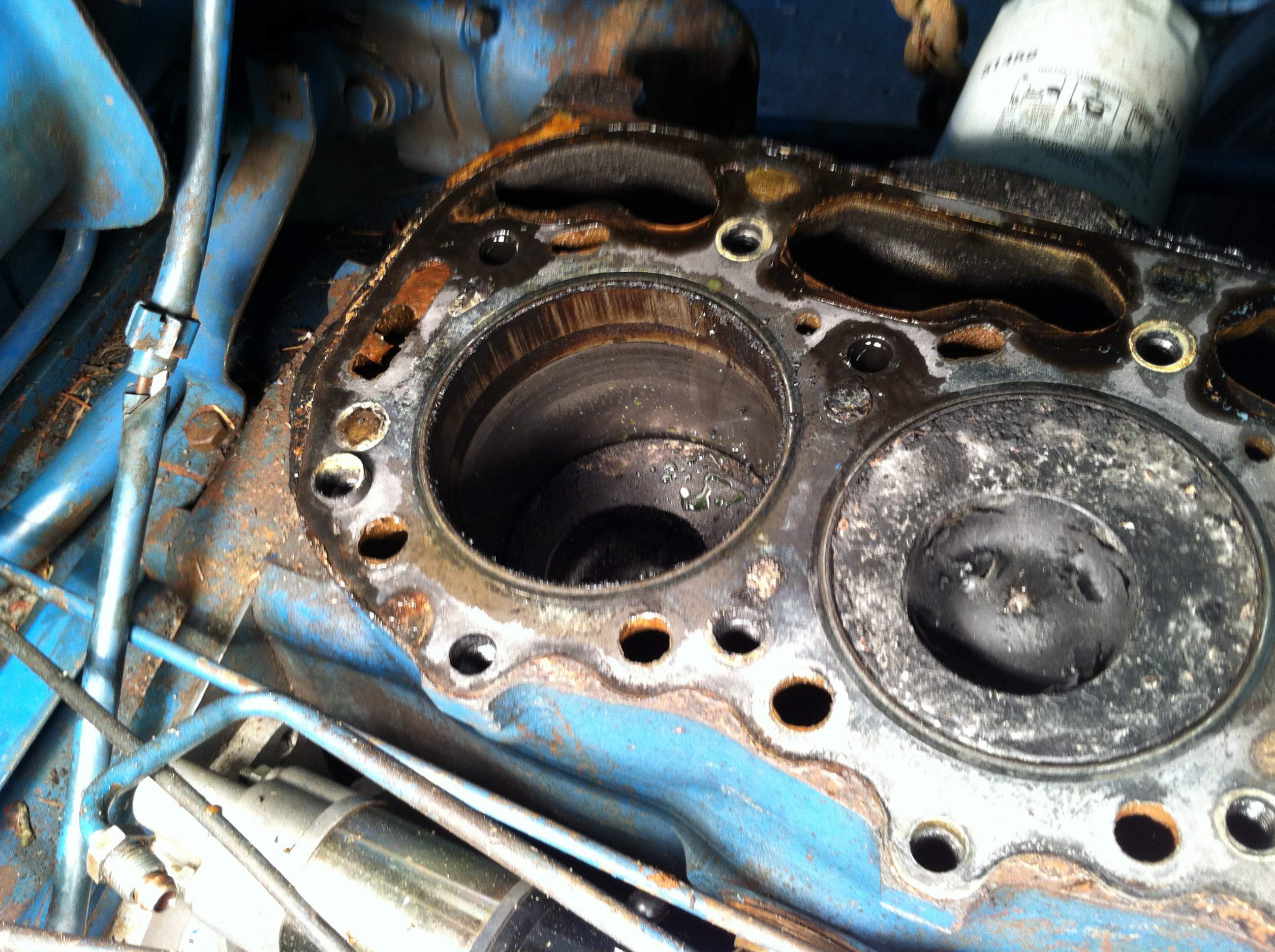

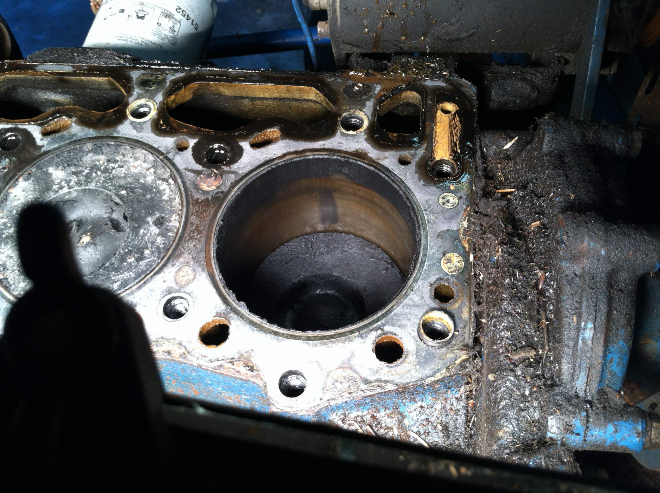

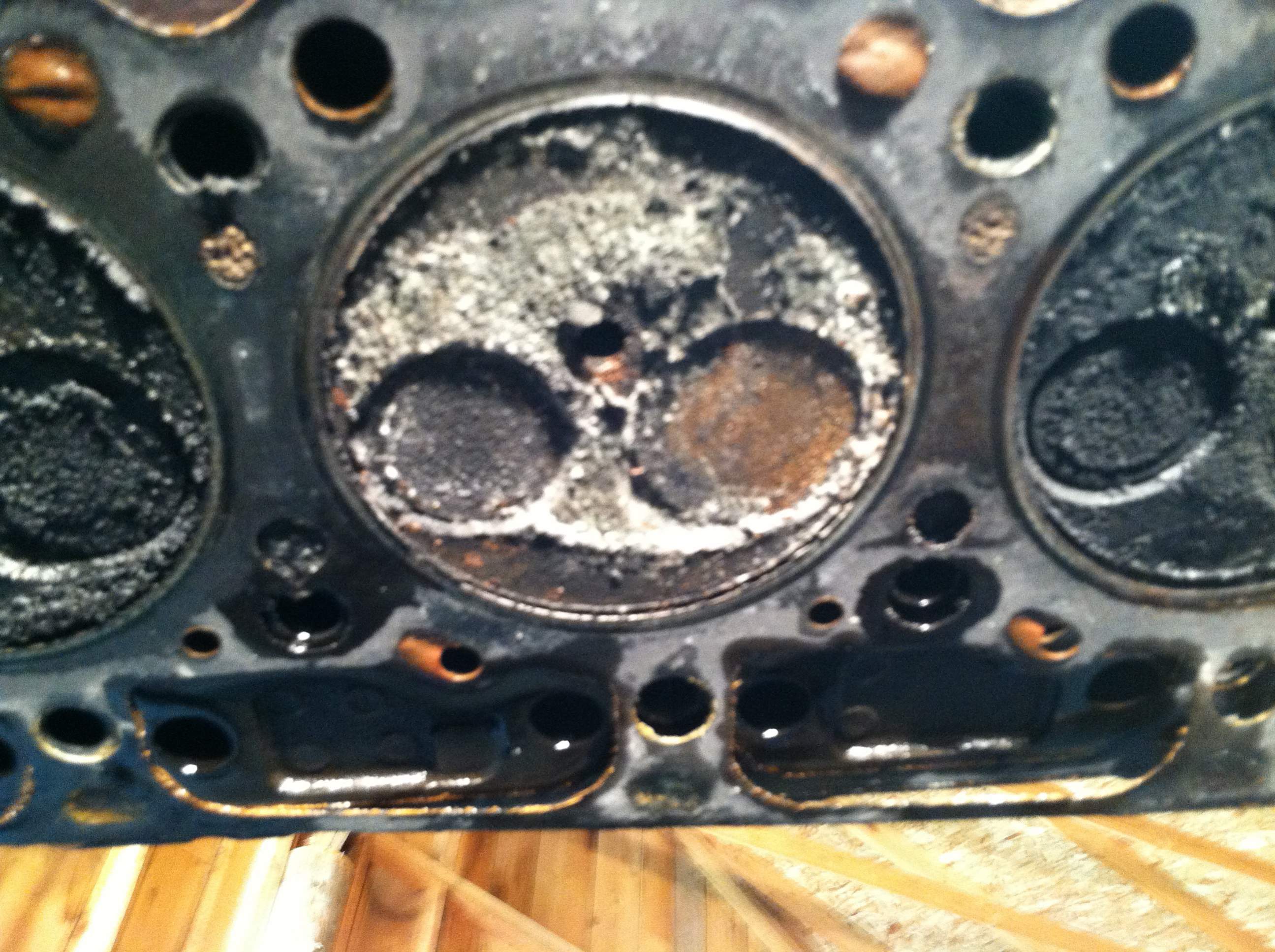

Hi cummins. Thanks again for replying. I didn't notice the oil ring not sticking out farther than the piston. but will double check that. Pulling another piston is a good idea. I'm fairly certain I got all the rings on correctly, but then again, my first try at this. The tractor was my fathers and when he passed it became mine. The reason I started this in the first place is it was getting harder and harder to cold start and it had a lot of smoke coming out the valve cover as well as the exhaust pipe. I heard that ether was not the best for the engine and it required it to start. Anyway pulled the head and the gasket had blown at some point. Visible coolant leak. there was only a couple of rings intact. Impressions from the rings on top of the piston, so it was passed time. Here's a few pics. Thanks again for your help. Matt
Block and old pistons
the head

Umbrella seals typically slide over the valve stem and move with the valve preventing the oil from running down the valve stem into the combustion chamber.
Exactly like a woman's umbrella works.
Not a true seal but a deflector.
The seals that attach to the valve guide are true seals preventing oil from getting into the guide.

Hi Cummins. The umbrella seals that are on both valve stems fit snugly over the guide that the stem goes threw. The new ones are tight on the stems but are no where near tight on the guide. Is that alright or OK? I still don't see where the o ring would go. I didn't see it on the exhaust valve stem. The intake valve stem has one machined groove at the top of the stem which the retainer locks ride in and the Exhaust has two grooves. Top one for the retainers, would the o ring go in that second groove? I don't see the benefit with an o ring there.
Here's the guide. The umbrella seals that are on now fit over the guide and butt up against the ridge on the guide. Is there something else that I haven't removed or am missing? Thanks again. Matt
