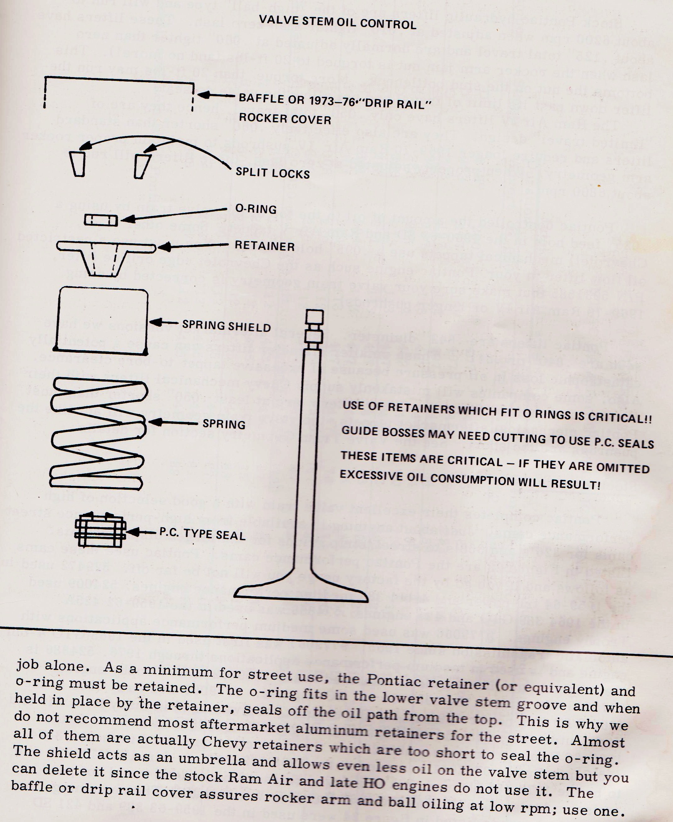

From the diagram it looks like that seal goes in the bottom groove of the valve ....towards the bottom of the rotator.... notice that the other valve does not have the additional groove.

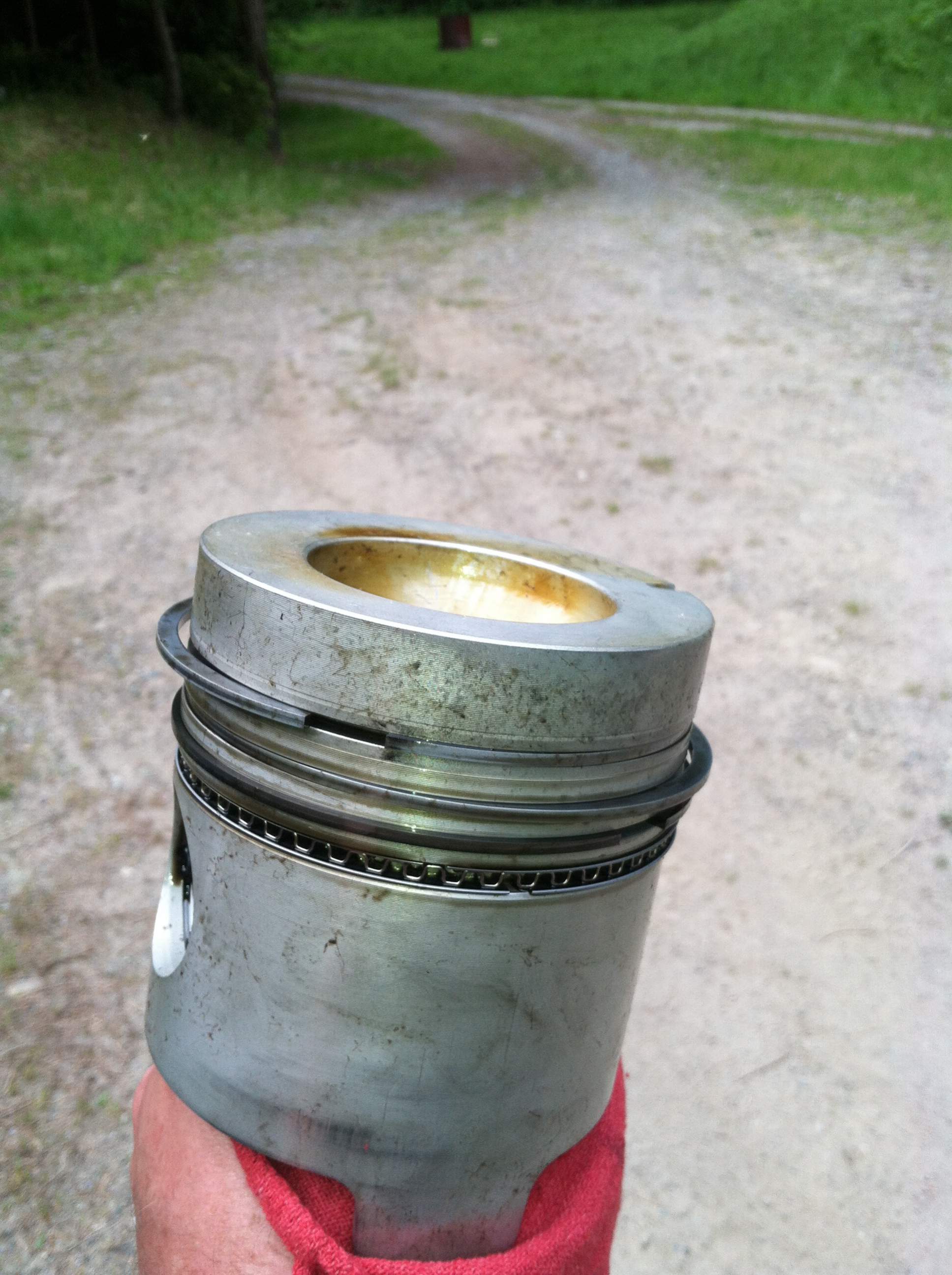

I also agree that the oil ring on that piston looks quite small for the size of the piston, even with a decent size gap showing. I wonder if it's possible that it's the wrong size oil ring ....did it install in a similar manner to the others? Or was it more difficult? If you don't remember ...it probably means it was not more difficult :)

After looking at those pictures , I would pull the oil burning cylinders rings off the piston and check the compression rings end gap and either of the oil control scraper rings also . You can use the piston - turned upside down to get them in square to the bore (one at at a time ) and then check the end gap with a feeler gauge...
.004 per inch of bore is a good average #, so 4.2" x .004 = about .017" end gap for the comp rings... anything under about .060 for the oil scraper rings is possible.. You can compare the #s with the other normal cylinders, all that being said if this check doesn't show something WAY out of normal , I would have the head magnafluxed and checked for a crack or sand cast flaw in the oil burning cylinders intake port my :2cents:
that picture of the intake looks suspicious I can't help but wonder if that port has access to engine oil somehow??? oh one more thing about the valve o ring seal this is from a pontiac hi performance blueprint assembly but the information maybe helpful valve seal 001.jpg the part at the bottom explains why the o ring is important -the retainer and lower groove and o ring positively seal the oil from running down the valve stem... but the amount of oil your engine is burning is well beyond it...

SD455, off the top of your head, what engines/years is that pontiac valve info applicable to? I've got a 68 GTO apart, engine will be going back together in a year or so, always looking for info and pointers :)

The rings looked good also. Not sure how "seated" rings should look. They were loose like I had just put them on the piston. Not sure where to go from. Matt here View attachment 317168
I read all the posts, but they keep coming in, so if I said what others may have, just regard at-will.
Did you move the oil rings when you pulled the piston, or were they orientated in the bore as shown in the above picture? because they should be further away from each-other. Also, it's hard to see in the picture, but it looks like the expander ring gap is just above the lower oil ring.
Are all the rings orientation correct? Did your ring installation instructions tell you which ring goes in which ring grove? Some compression/fire rings have a taper edge on them and if installed improperly, the ring will scrape oil from the cylinder wall on the up-stroke and feed it into the combustion chamber and try to burn it. And of course there could be issues with improper ring gaps, ring to piston gap and cylinder bore taper issues.

That should apply to your engine. But, keep in mind that the valve guide bosses might need to be machined down to accept a PC (Perfect Seal™) because 1.)they may not stay on the guide, and 2.) they will most likely hit the valve spring dampener (inner spring) and spring retainer and self destruct leaving all that rubber floating around in the engine. All in all, the PC is a good way to go for dry guides. IMHO!

Going back and looking at post #1, it looks like the piston has a lot of piston to wall clearance. Does anyone else see that or is it just me. I wonder what the bore is and what piston size was purchased. Kinda looks like it's undersized to me. <shrug>

Thanks for joining in. When I put the rings on I followed the instructions as far as rotating the gaps. The picture show results of me handling and cleaning the oil off the see what's what. That may have moved the rings. The ring sets came in a fold out holder with labels for order and location. I'm not saying I got it right but I thought I did. Learning as I go kinda scenario. Costly and frustrating. I'm waiting on a bore gauge to check the cylinder and the go from there. At this point I'm not sure of what went wrong so Kinda going back to the beginning.
