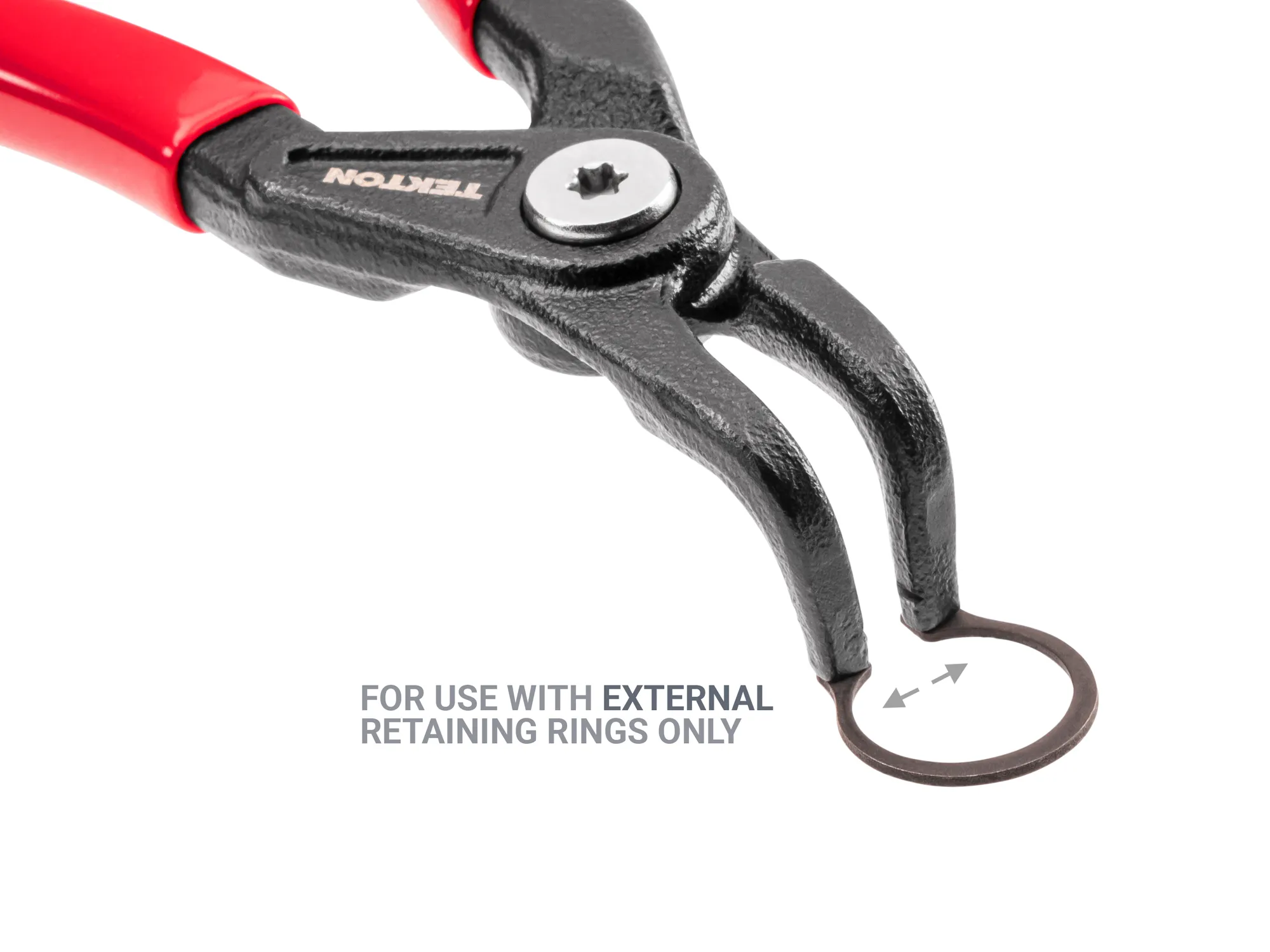

Tekton has a variety.
5 Inch 90-Degree External Retaining Ring Pliers (0.047 in.) | TEKTON

I have all of these and probably a few duplicates. None will work in the confines I have.
There isnt much room between the shaft and the coil. I need a 90 degree pair with at least 1 5/16” tip reach.
It looks like I am going to unbolt the compressor. Not an easy task to reach the bolts. And hope there is enough play in the connections to allow me to use a straight pair.

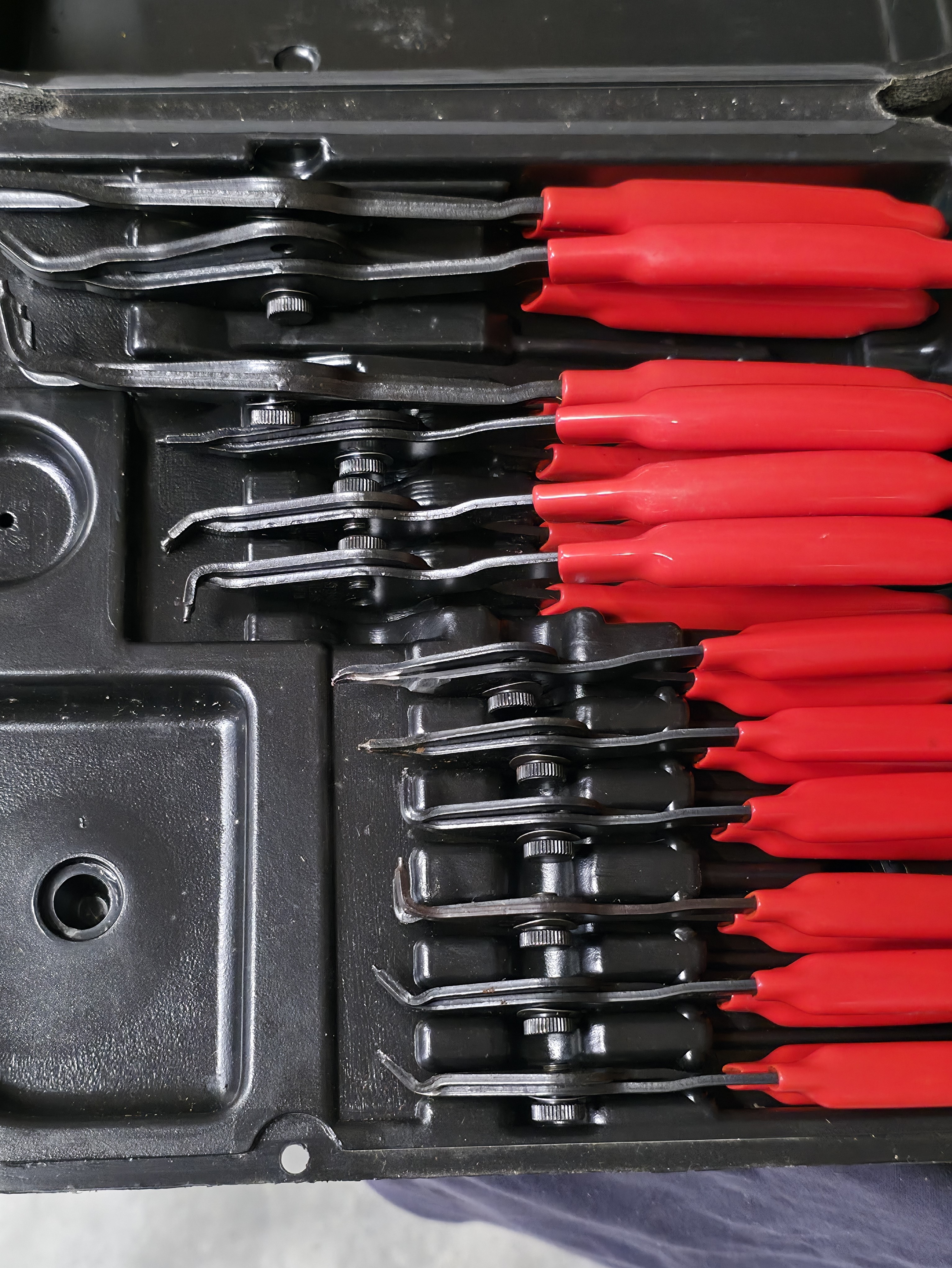

I bought this K&D/Napa set years ago. They don't have the "deep" jaws that you need.

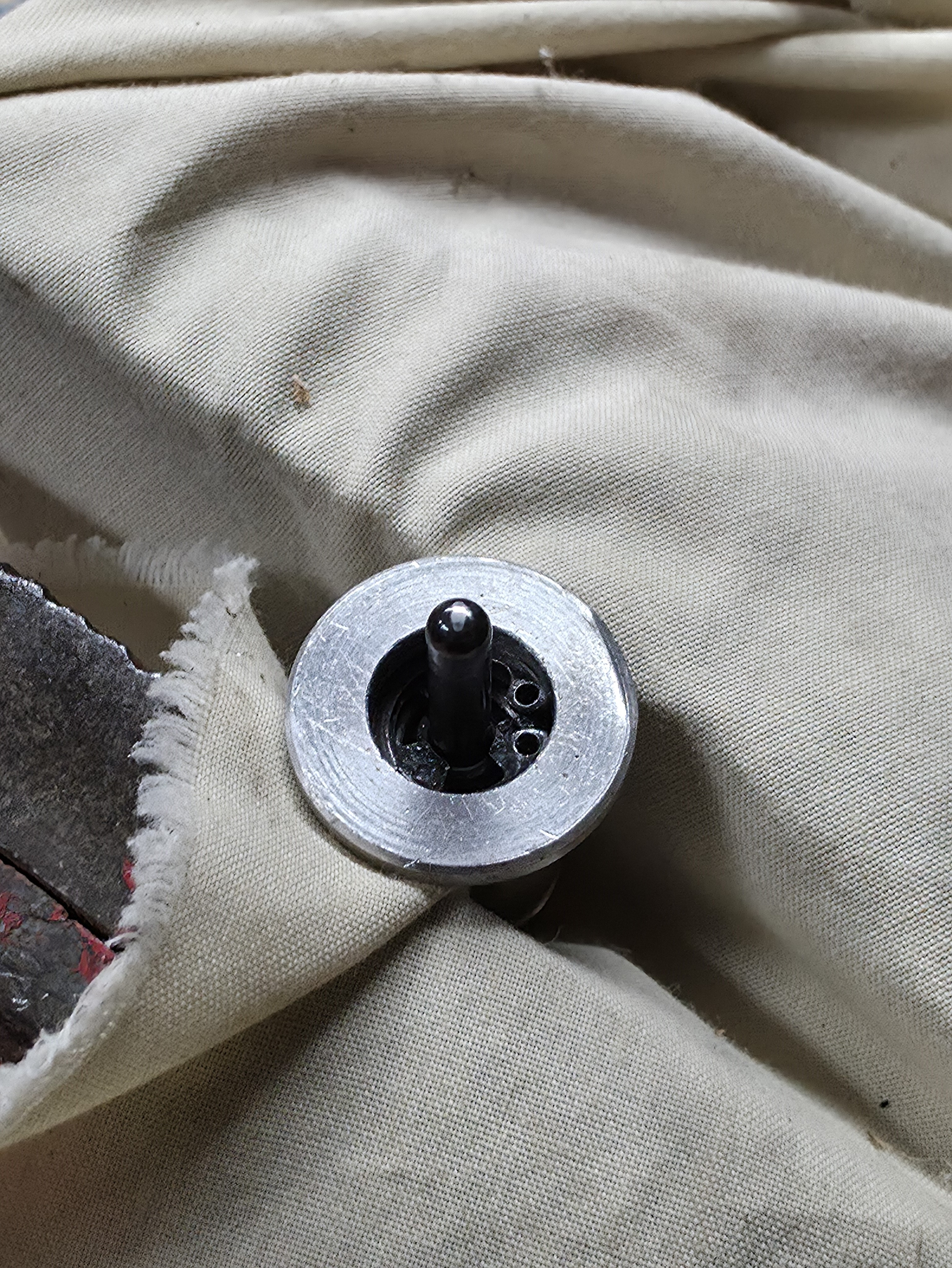

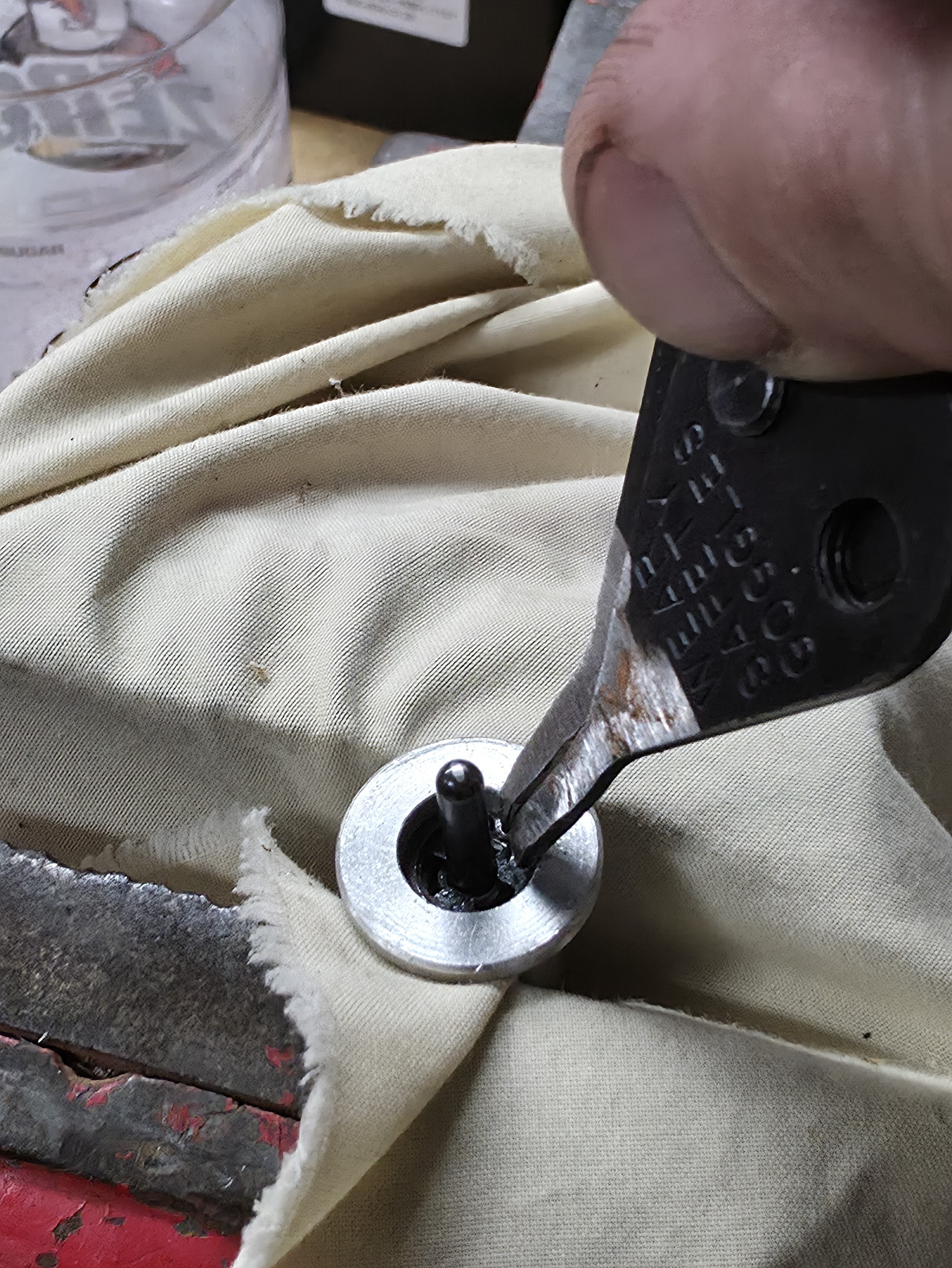

Twelve pliers and I still had to "hack" one up. I was rebuilding my Duofast CN350 framing nailer that I bought back in 1992. At around 16lbs, I ought to sell it as an antique. Anyway, the valve for the trigger had this tiny lock ring that I kept slipping on. It took me an hour of grinding/filing/bending but I finally got it out. Best part, the gun actually works and has no air leaks!

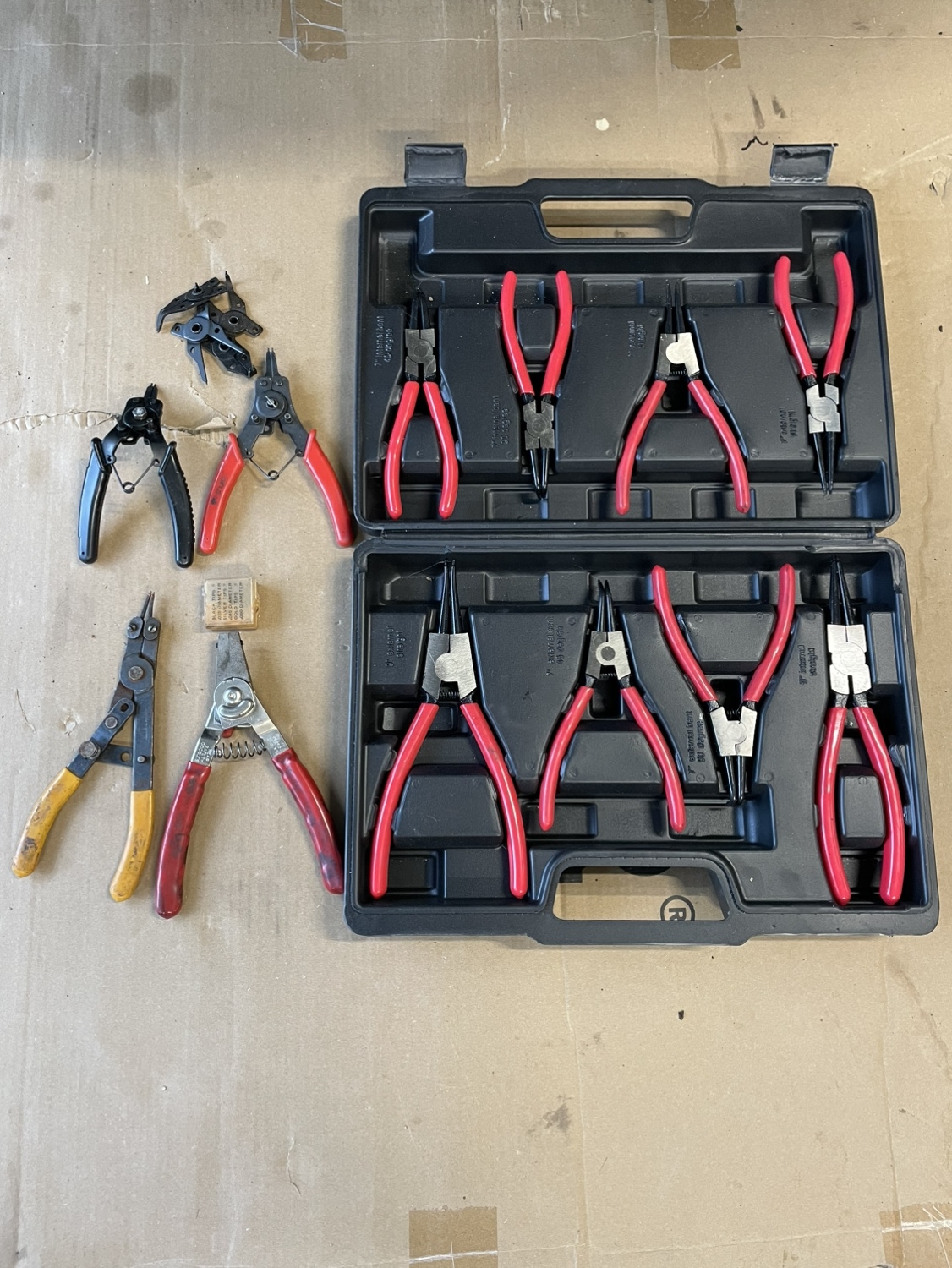

View attachment 3843459Twelve pliers and I still had to "hack" one up. I was rebuilding my Duofast CN350 framing nailer that I bought back in 1992. At around 16lbs, I ought to sell it as an antique. Anyway, the valve for the trigger had this tiny lock ring that I kept slipping on. It took me an hour of grinding/filing/bending but I finally got it out. Best part, the gun actually works and has no air leaks!
Thats a nice set but I found that no matter how many tools ya got it aint the right one.
I also have a lot of modified to make it work tools.
