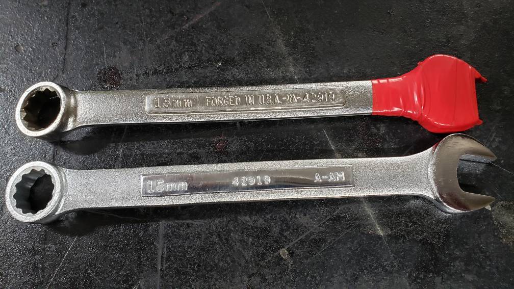

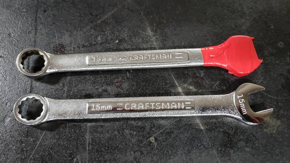

I got my new non USA 15mm Craftsman combination wrench today. I hate to say it, but the box end is thicker, the handle is thicker and feel is heavier than my old forged in the USA 15mm. 20190214_150117.jpeg20190214_150128.jpeg
