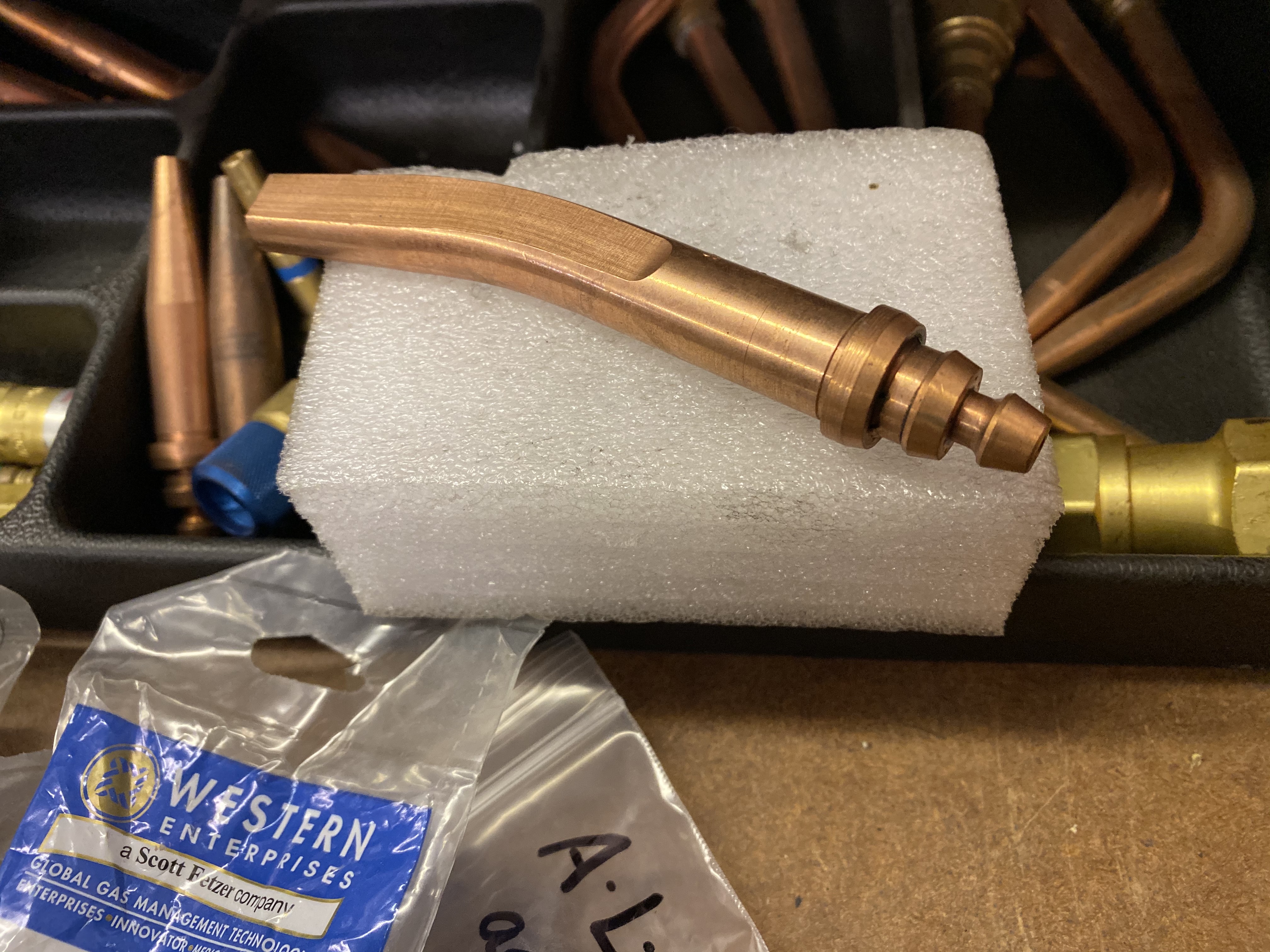

You can do a pretty surgical weld removal with oxy-fuel. Just run a small tip with low pressures and shave the welds down a little at a time. If you try to take the whole weld with 1 pass it will for sure be messy. Good luck !
   / Snapped excavator bucket tooth shank #27
For “shaving” cuts I like to pivot the torch on the nut that secures the cutting tip resting on the work. In this case the edge of the bucket.
   / Snapped excavator bucket tooth shank #28
Pick up a gouging tip for your oxy acetylene torch makes it a little easier to control
   / Snapped excavator bucket tooth shank #29
Another good option.
I’m usually too lazy to swap out the tip though ...
