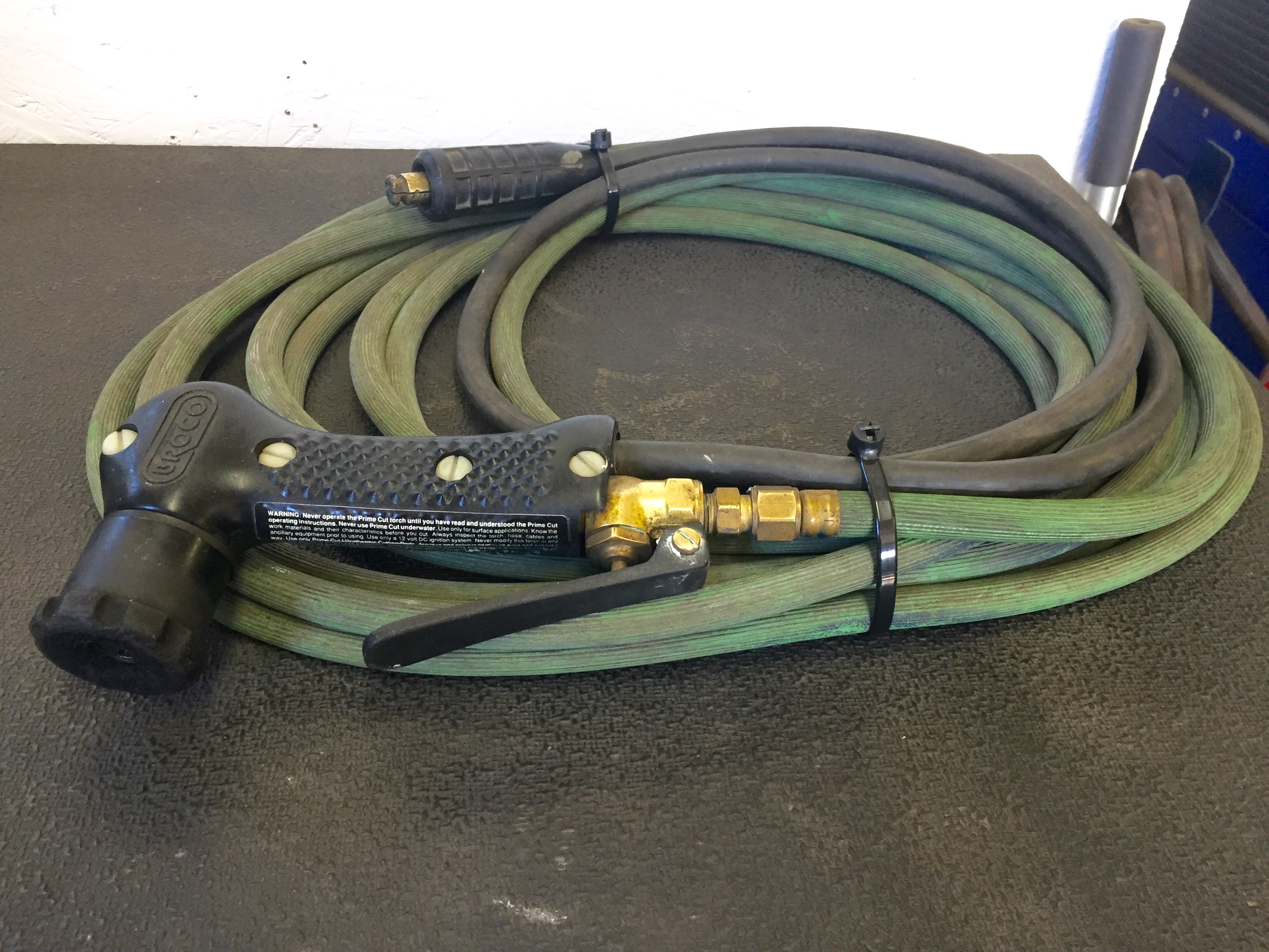

I just came across this thread. You’ve already received good advise and prolly already have it fixed!
I’ll add exothermic lance to options for cutting it off though.
I used to sell Arcair Slice Exothermic. ( still have one ) Fun product and crazy destructive.. Once we pierced holes in a huge boulder and hit it with sledge hammers to bust it up. Worked perfectly.
I have the SLICE too. Do you say “It’s been a slice” when you’re completed the cut like I do ????
Great for those pesky bank vault doors.
*not really. In actuality a lot of the loot would be on fire. Don’t believe everything you see in bank heist movies.
