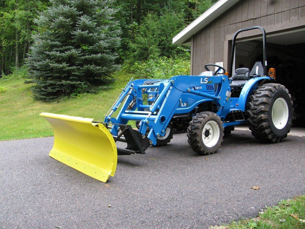

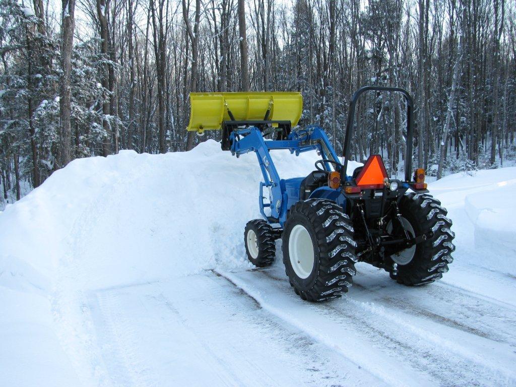

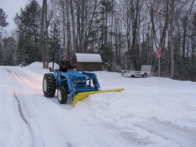

I use a 6'6'' blade on the the loader arms, works like a charm, you can scrape with it, and stack it as high as the arms can reach
What brand of tractor is that, the only blue I've seen is ford and that tractor looks new.
I like the angle function of that blade.
   / snow depth limit for my tractor #44
Wade the tractor is a LS, formerly the montana brand, LS has gone into making the tractors under their own name, yes its new 26 hours so far. It has the skid steer type mount on the arms for the bucket, so I bought a skid steer mount, had a friend that had an old pickup blade, all I did was shorten the a arms on the push brackets of the plow, add some minor reinforcing on the push arms and the skid steer bracket and put it to work. I have to angle it by hand but it not a pain, the nice thing is by curling it forward some I can scrape the driveway, (blacktop) when I carry the snow from the edge of the blacktop to stack it I curl the blade back as I'm going to let the blade rest on the shoes so it doesn't dig in. Danny

Wade, another thing that you can do if you can locate an old pickup plow blade is just weld a set of ears in the back or the bucket, pin the plow blade to the ears in the bucket and use the bucket along with the loader arms to lift the blade, that way you have the option of angleing the blade if you don't have a quick disconnect skid steer arrangement to mount the a arms to. Pull two pins and the blade is off. Danny

It looks like it works good and seems to be sturdy. I've thought about adapting a truck blade for my tractor. Could you post a pic of the mounting arrangement? If you don't mind I may outright copy it or adapt it for my smaller tractor(over the summer).

Wade, I'll take a few pictures tomorrow and post them. Danny

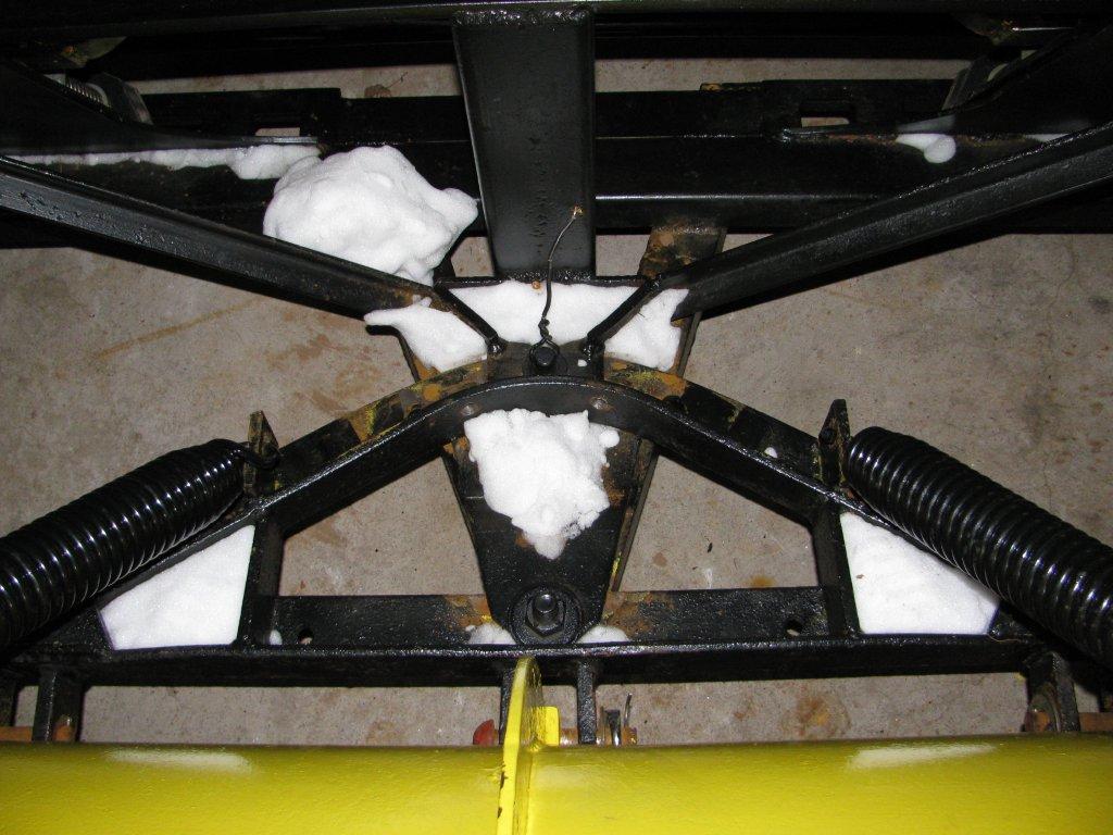

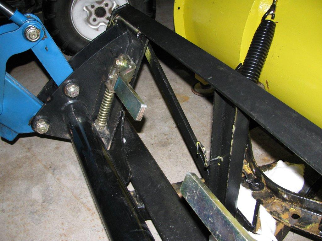

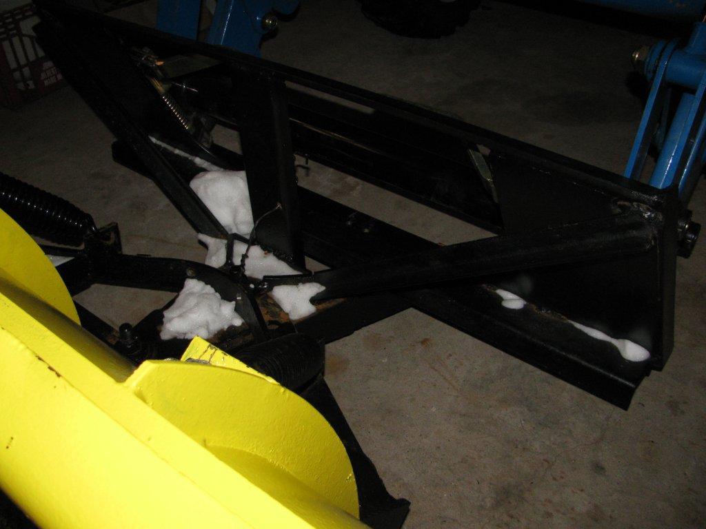

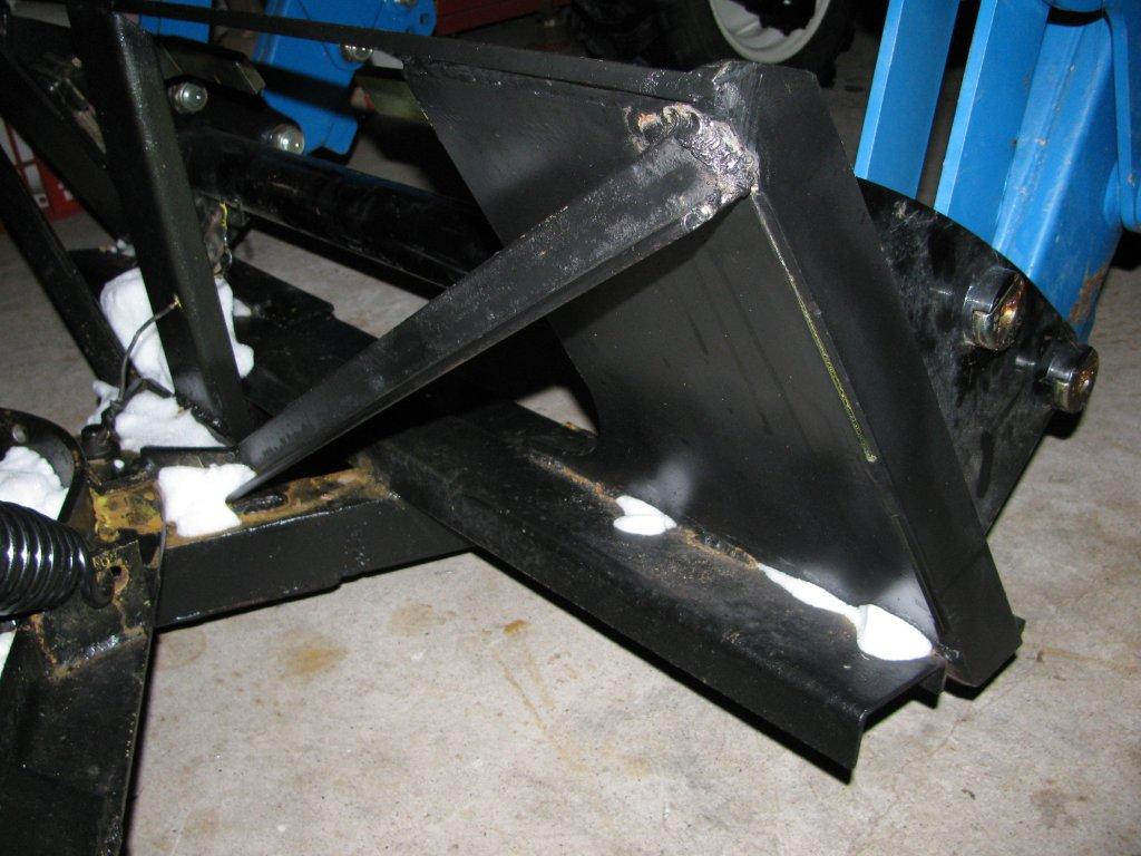

   / snow depth limit for my tractor #50
Wade, here are the pictures of the plow mount. from the basic mount we added a channel along the bottom, a channel verticle, and two angle irons from the plow A frame to the rapid attach plate just for insurance and to help distribute the load. I have a set of heavy springs on the blade for roll incase of hitting something. If you plan on using it as a dozer blade also, remove the springs and use a couple of rods or something to prevent the blade from rotating. The guy I got the blade from had a set of rods made up for this function but he couldn't find them as he was in the process of selling his place and had gotten rid of a bunch of stuff already. Danny
