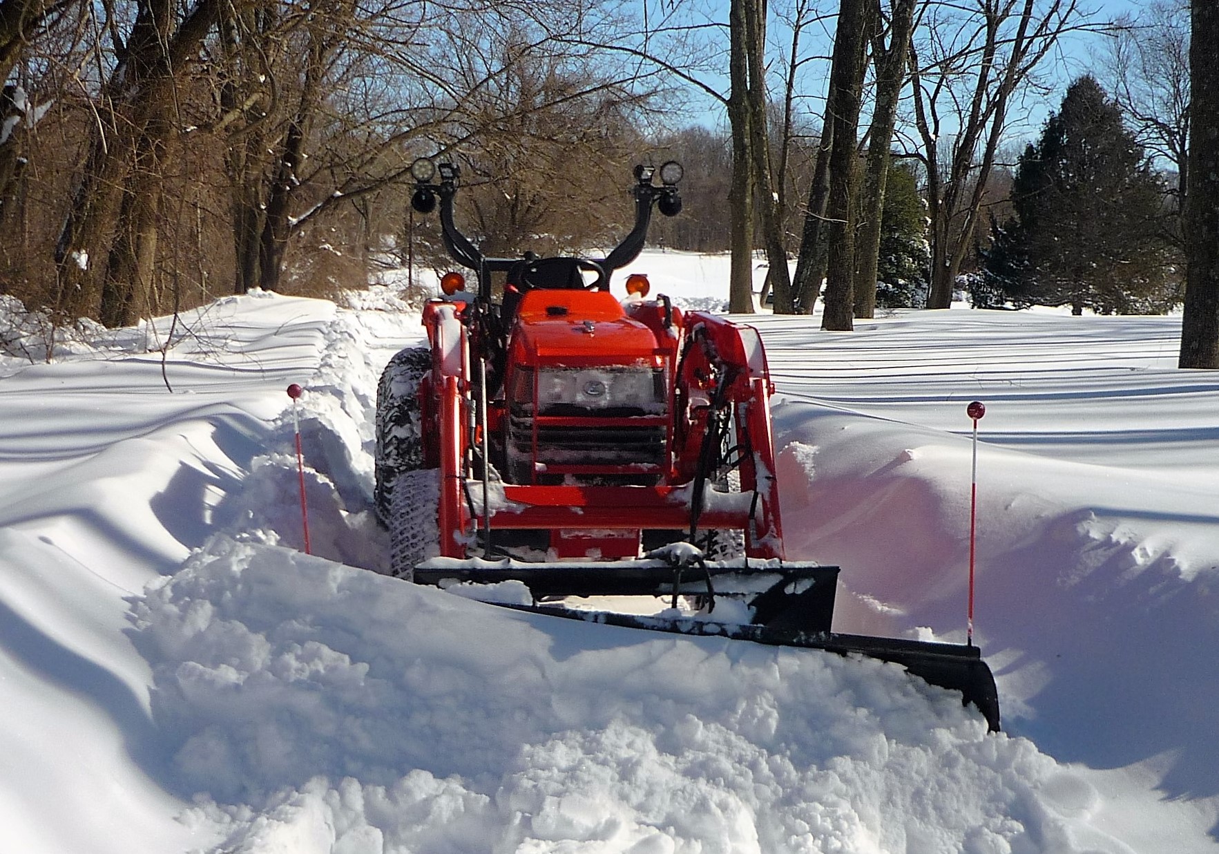

I've used turfs and R-4s, both with buckets and rear blades and more recently a front snow blade. I have found turfs work fine (L3400 tractor- not too heavy or too light) unless you have ice below the snow, and then chains would be required with any tire, unless you had studded tires. I use rear chains, but I have fronts, also, which aid in maintaining the desired direction, since heavy snow and a large blade tend to push the tractor off away from the angled blade, unless you have a massive machine. Some years I am lazy, and don't even bother with the chains. In my larger "avatar" photo below, because the snow was pretty deep, I had the rear chains on.

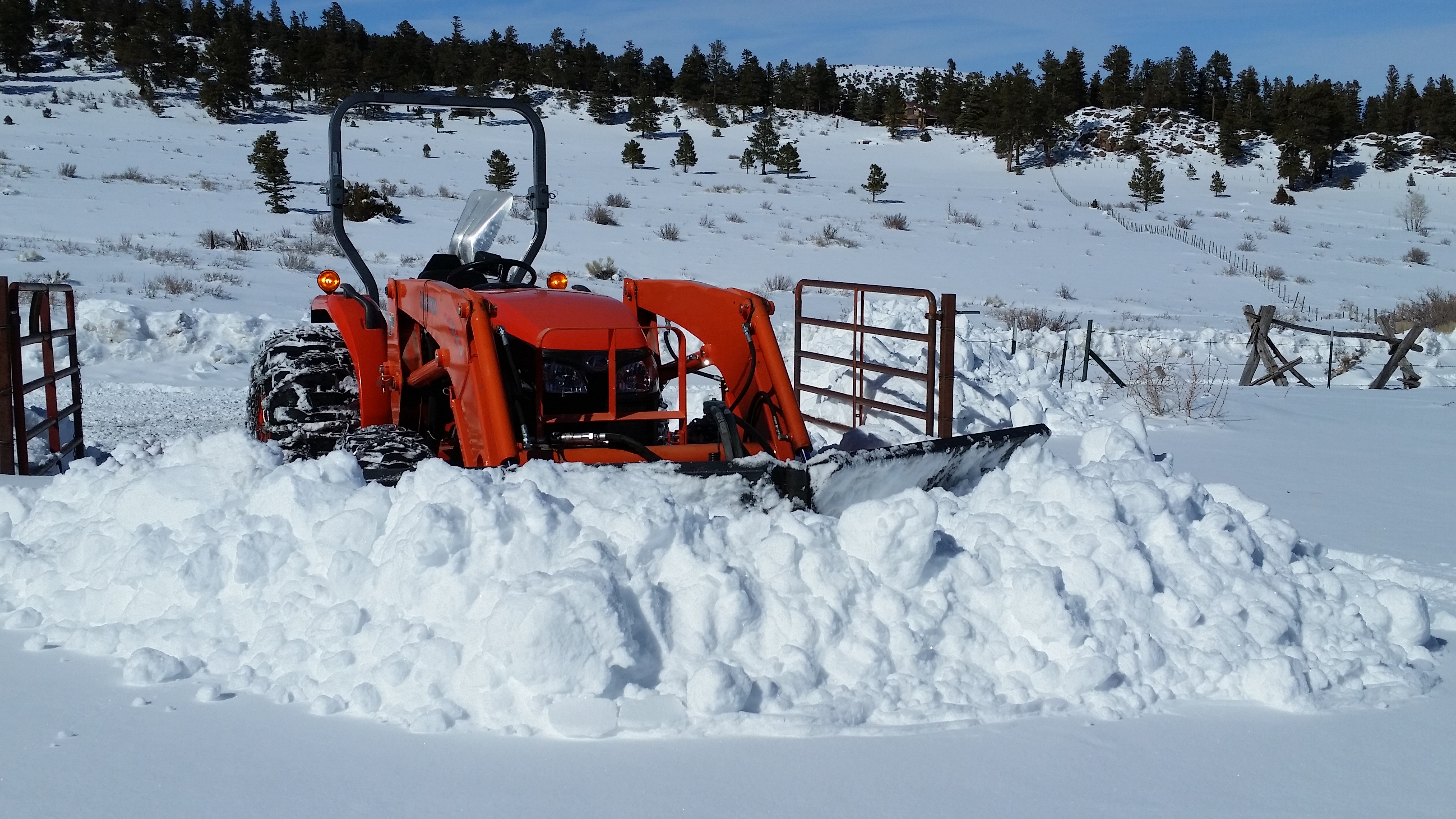

When people in these forums say that you need ballast and chains to work in snow it makes me wonder what kind of conditions they have to warrant making those statements. I had chains for my 955. I never used them.
Situation like this, plowing 14" of stiffened snow. This gate is about 4 feet above the level of the road, and sits back maybe 20 or 25 feet from the road. So its not particularly steep, but still working against gravity to get up through the gate. Without chains I could blow it, or I could bucket it out of there (which would take forever), but for plowing "tire chains required".

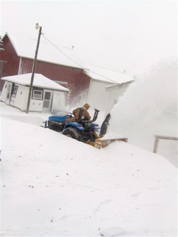

Just like with truck tires, big fat lugs are not good on ice. Ice tires have lots of grooves and sipes to grip the surface. There are plenty of threads talking about using a grooving tool to add grip to r4 tires. I have been using unloaded turfs for many years and have not had a issue plowing or blowing snow. Here is a picture blowing deep drifts so solid you could almost walk on them. I did not have a traction problem, just a size problem!
