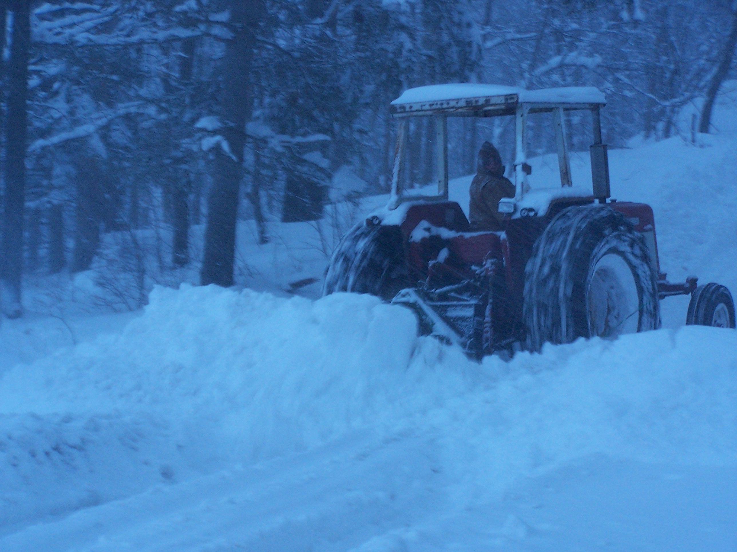

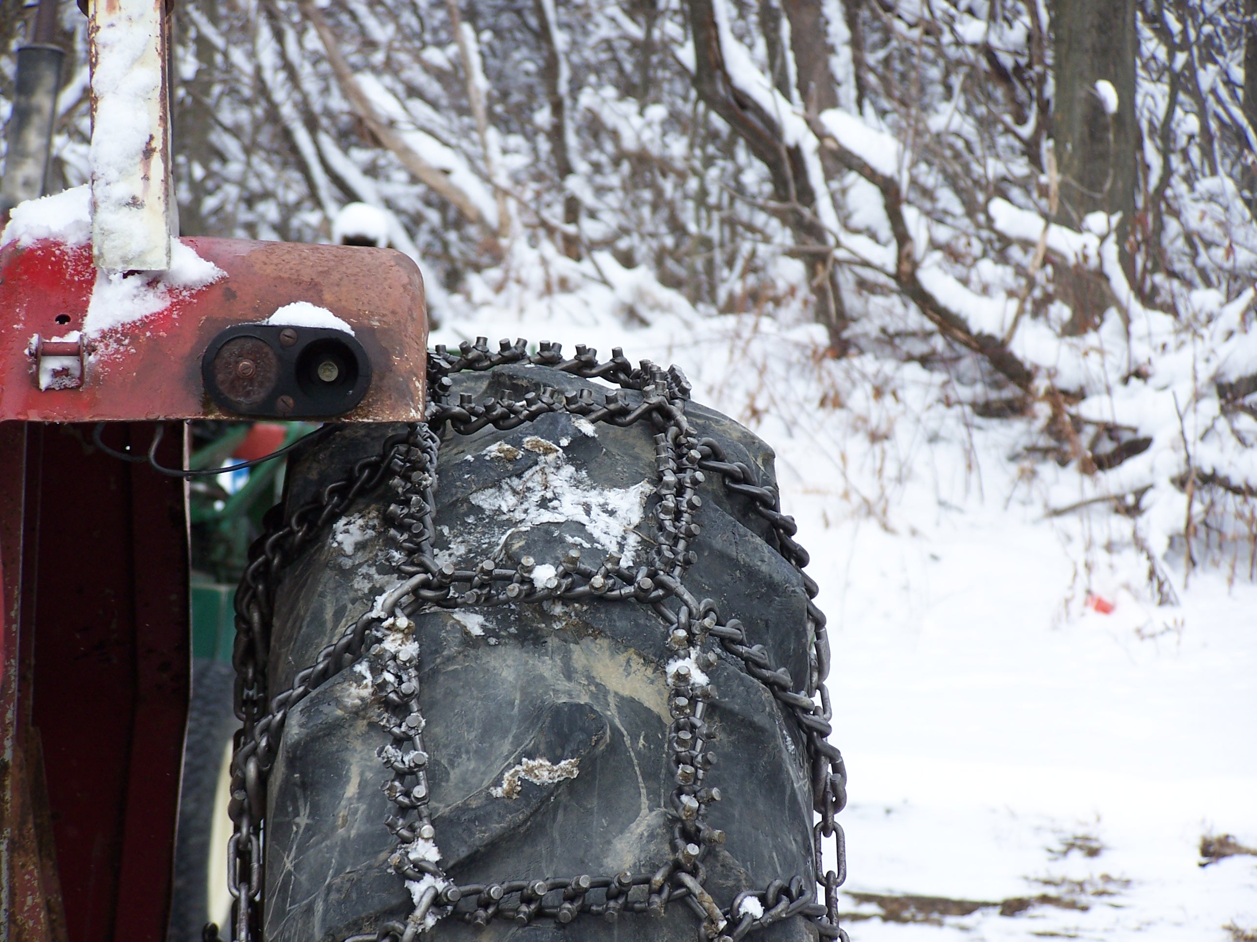

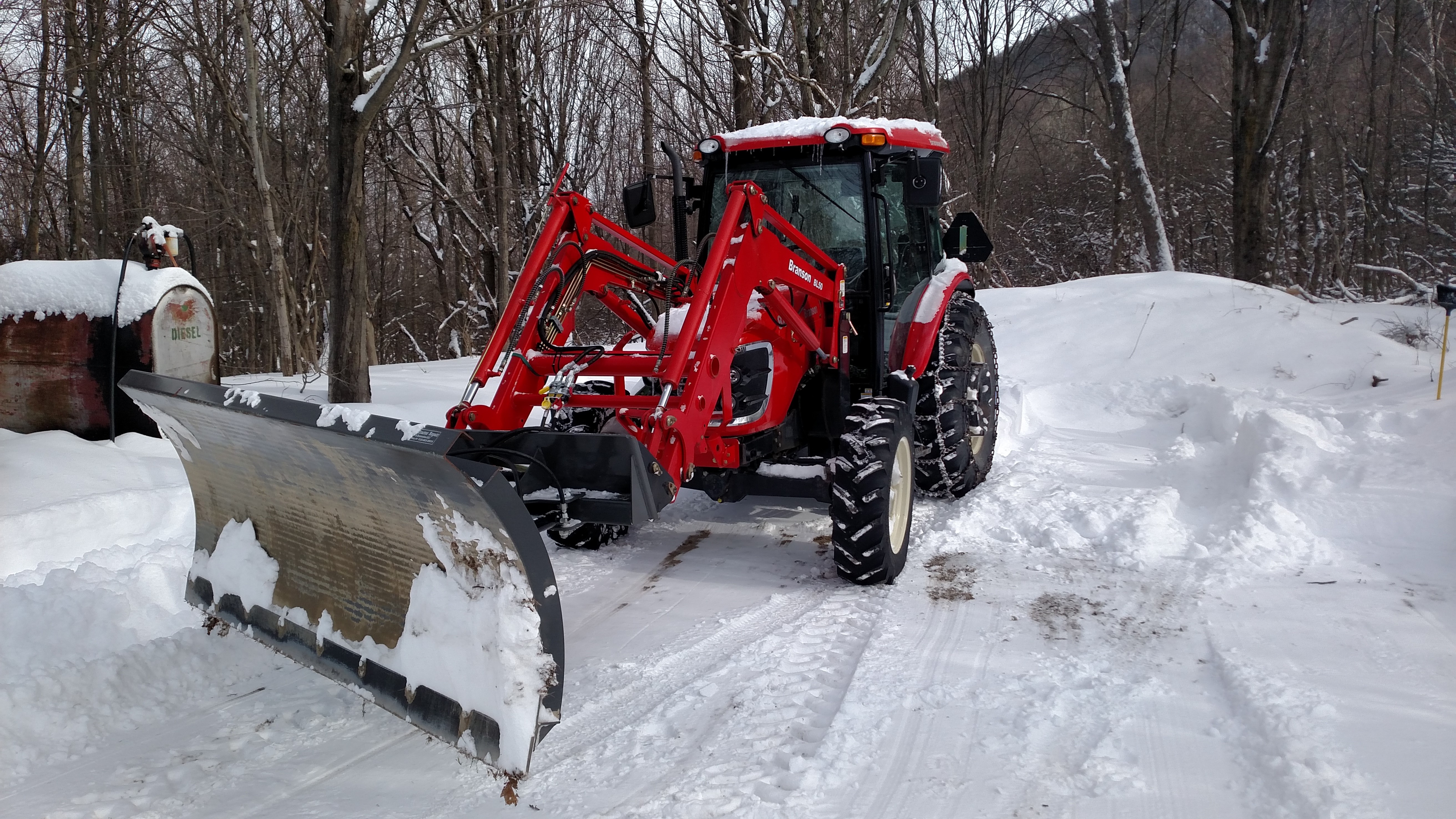

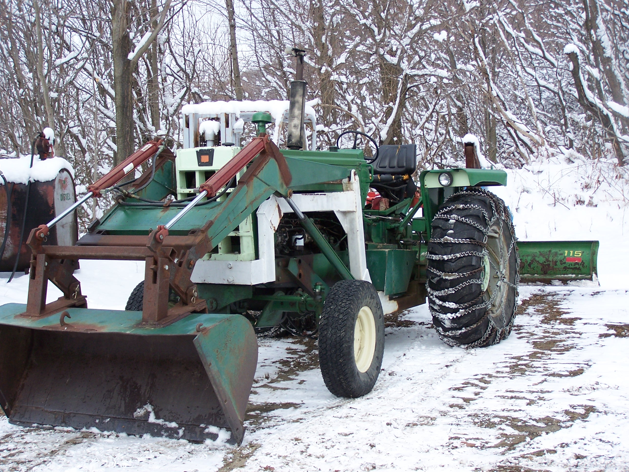

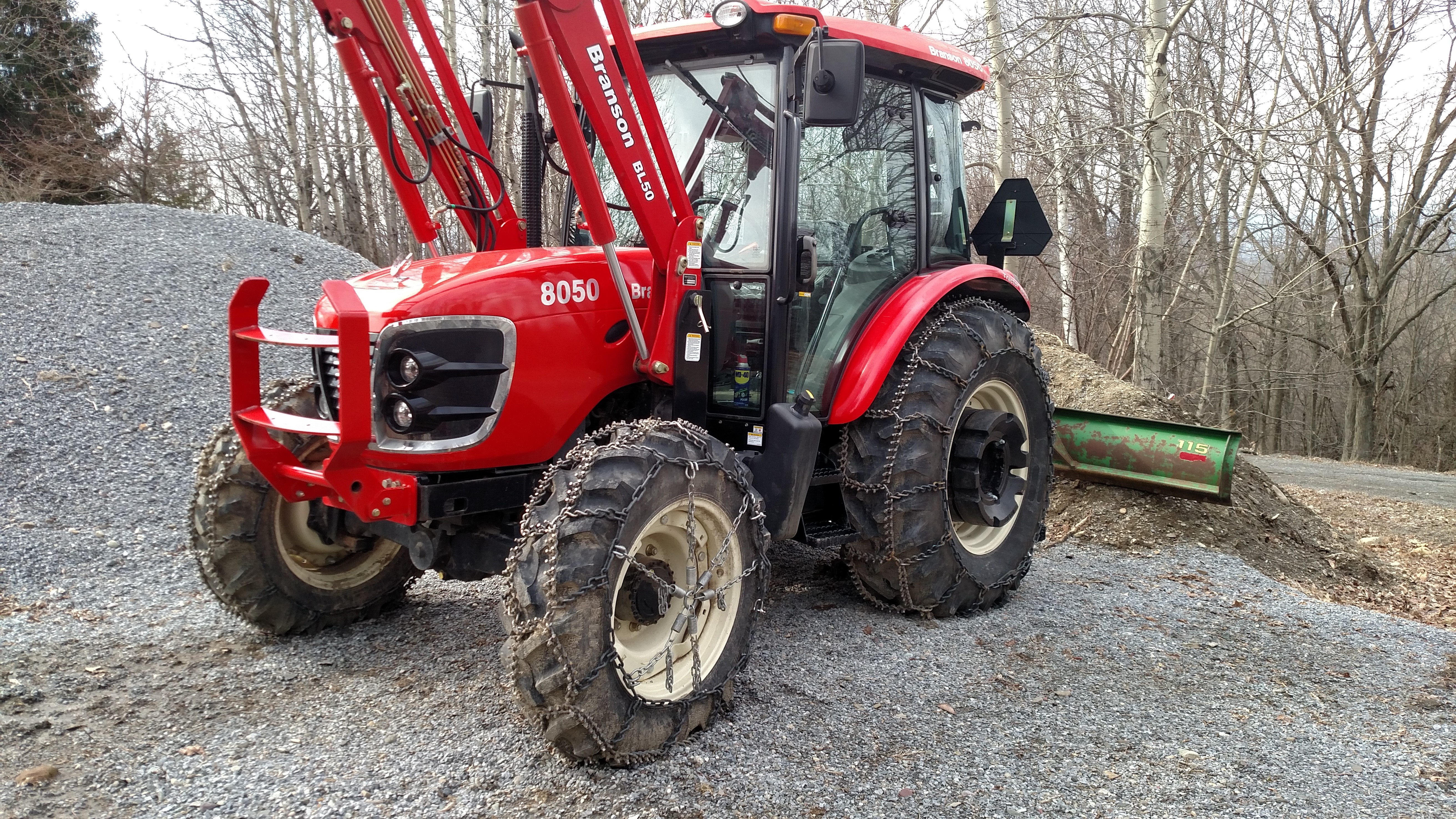

I have a 1/4 mile unpaved driveway, it is steep enough that if you put a plow vehicle in neutral with the blade down in 8-10 inches of heavy snow you have to use the brakes all the way down and I have always had to use chains, you would not make it up without studded tires or chains.
I have had and tried numerous sets of chains over the years from double ring and duo-grip to the newer studded types, I have been surprisedan d pleased with the damage that the newer studded ones don't do to the paved roads.
Because of the need for chains my tires are some what unimportant, without chains everything that uses my driveway in thew inter uses studded tires, I have had to let cars down with a chain that made it up with out studs.
