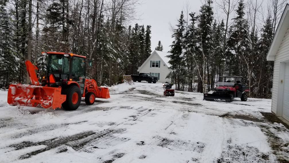

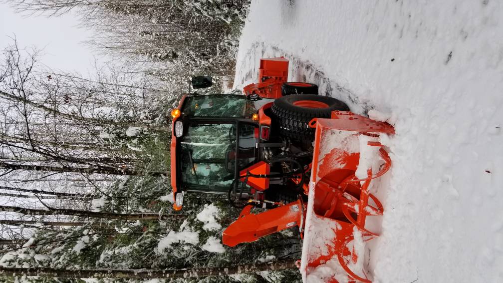

^ Yes! We ended up with around 6" of brutal wet snow. Ugh
All my plans for using the plow to start the winter off went out the window. Got about 5 feet and it was so wet and heavy the blade dug in and stopped the Ranger dead in its tracks!
After reading all the horror stories about using the blower at the start of the season had me petrified, but I was out of options. It was either that, or the walk behind blower (for the 1000' driveway lol)
To my surprise, with the skids all the way down, and liftin/lowering as needed to not spray gravel everywhere, I managed to do it. No shear pins were broken either. Just took it really slow and easy.

Until the ground freezes I keep my top link shortened up so the blower is tilted so as not to dig so bad. Seems to help I think. It becomes enjoyable once the ground freezes.
   / Snow moving. Not as easy as I thought #89
That's a good idea too!
This last storm we had on Thursday was another weird one. Not sure where you are, we're just west of Moncton, and we ended up with around 6 to 8 inches of white stuff, which got immediately soaked with the rain that followed.
The next morning, it was just mush. I waited till it got below freezing again before hitting it with the blower. Surprisingly, it went quite well. I was worried about blowing it then freezing to a nice skating rink finish, but the skiff of snow left on top did it's job, and just ended up with a few icy patches.

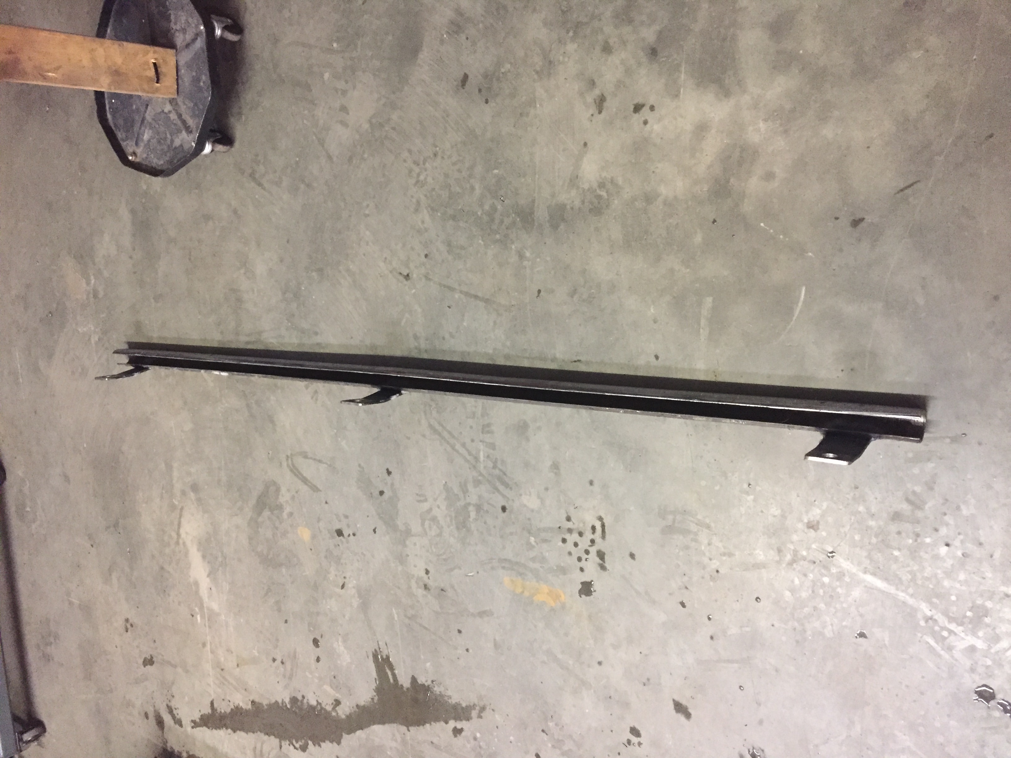

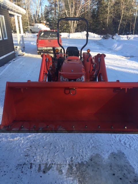

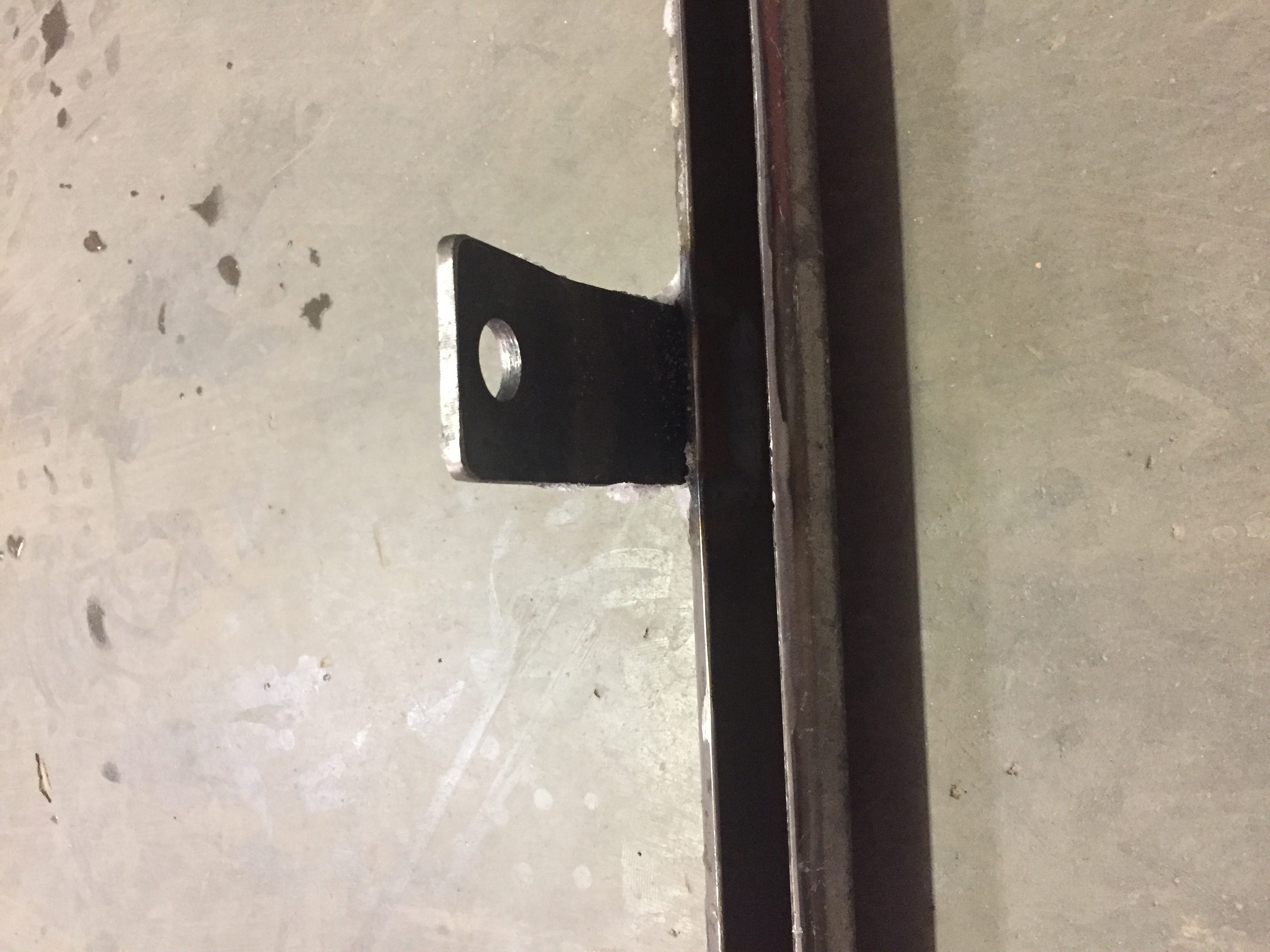

Just thought I would do a follow up on my DIY cutting edge tamer that I built for my tractor. It was the reason for this whole thread. It has been working amazing and I couldn't be happier with it. We have had about 2 plus feet of snow this year and I have been plowing quite regularly. I know that isn't much for some of the areas, some get that in one storm, but it's good for around here. I have tried to give my 3 PH blower an honest try but absolutley hate it. I can move more snow faster with the loader and I'm not covered with snow when I'm done. I just have short distances where I have to move the snow so the FEL works great. I literaly havent scooped one shovel full of snow this year. I love it. Heres some pictures of the great job the loader does with the DIY edge tamer.
EDIT:
Why do my pictures load sideways. When I expand them they are the right way but as thumbnails they are sideways. Would it have something to do with them being taken with my iphone?
