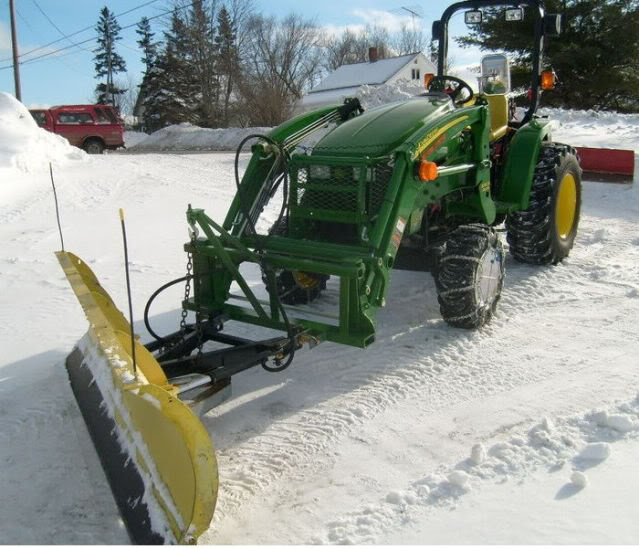

Due to mechanical problems on the old plow truck that are beyond what I care to repair, I've decided use the old plow I have vs. fabricating a new one. This will make things a lot easier and will play into the dissension to go with a hinged plow vs. a solid mount. I've also read some of the other posts and I'm going to figure out a way to support the plow without the chain. I still want to allow the plow to free travel up and down a liitle but I also want the option for down pressure for things like back dragging. I have a couple ideas I'm mulling over, the weight of the plow is what is going to be a factor, its a really heavy bugger.....
I have a chain that allows a lot of travel, and the plow is still heavy enough for any back dragging too. You might start with the full chain idea first, and then you can have more time to come up with a semi-solid link idea if needed. I know for mine, I am much better off with the full travel provided by the chain than I would be with partial float and solid down pressure.

After one look see at the Deere, To be or not to be isn't the biggest issue I noticed, first thing I'd do is move that plow back 2 ft. so it's not sticking out there a mile, then if down pressure is needed swap the chain out for a piece of round/square stock. Then there shouldn't be any worry's of scratching the car, banging into the house, hitting the garage door, knocking down the clothes line, and tipping over the dog house.
Yes, move the plow as close to the tractors as you can considering the Hydraulics. (Use short cylinders) Leave the pivot wit some slop, and reinforce heavily the skid steer plate you are using to stiffen it up. it takes a beating.
Mine is welded solid. I use on gravel roads, but I hate plowing our neighbor's crappy excuse for a rad up to their riding arena. A decent gravel driveway is no problem once it freezes.
