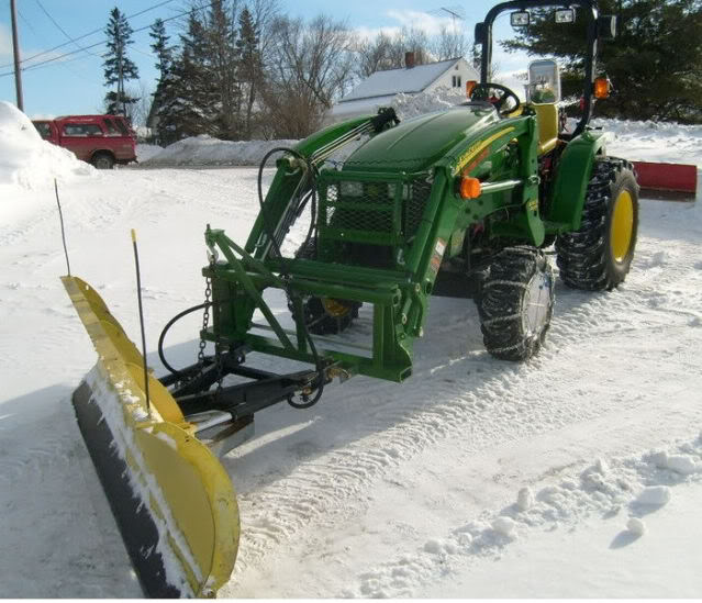

   / Snow plow fabrication #38
After one look see at the Deere, To be or not to be isn't the biggest issue I noticed, first thing I'd do is move that plow back 2 ft. so it's not sticking out there a mile, then if down pressure is needed swap the chain out for a piece of round/square stock. Then there shouldn't be any worry's of scratching the car, banging into the house, hitting the garage door, knocking down the clothes line, and tipping over the dog house.
Yes, move the plow as close to the tractors as you can considering the Hydraulics. (Use short cylinders) Leave the pivot wit some slop, and reinforce heavily the skid steer plate you are using to stiffen it up. it takes a beating.
Mine is welded solid. I use on gravel roads, but I hate plowing our neighbor's crappy excuse for a rad up to their riding arena. A decent gravel driveway is no problem once it freezes.
