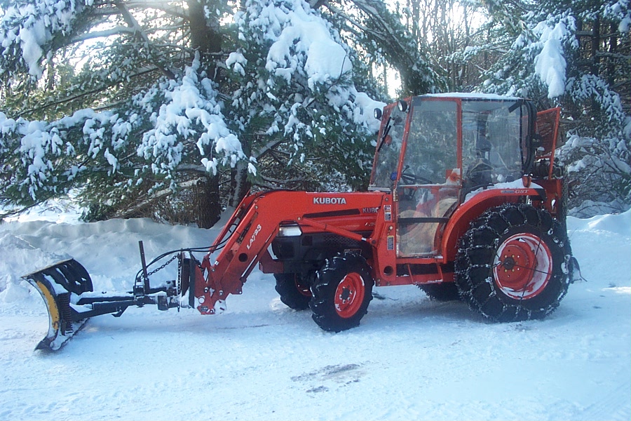

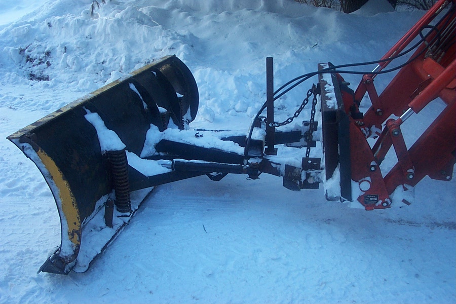

I can push the snow up to about 10 ft high, Been using this outfit for 14 years. First on a JD now the Bota.

/ Snow Plow Suggestions? #13
I've got the quick attach bucket on mine too, I questioned the the previous owner why didn't do a setup like yours? He said that the was afraid that with the blade out that far it would push the tractor around too much (possibly bending the loader arms)? Do you have any problems with that? I know that even with mine real close to the tractor, if I have the blade angled and I catch the ground it pushes me off to the side....

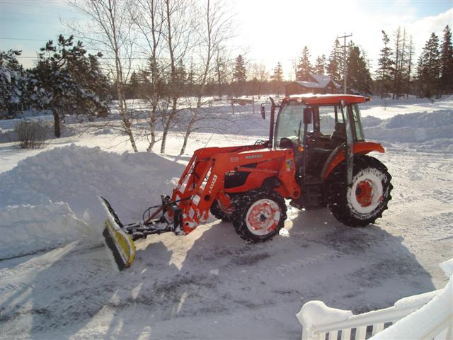

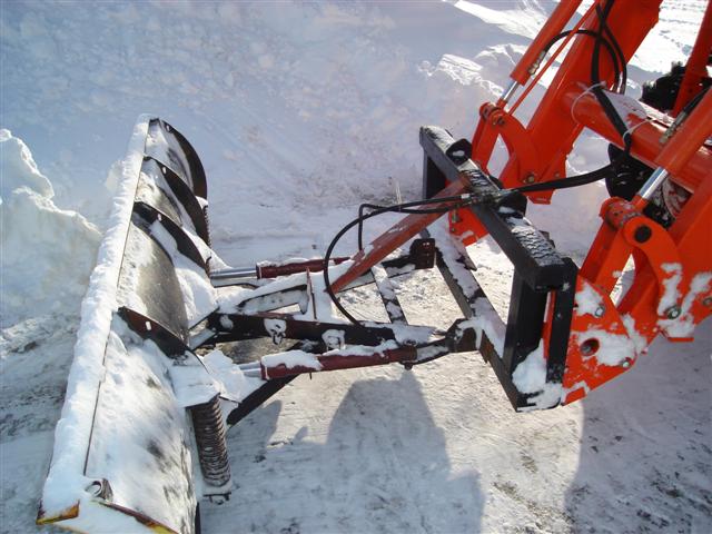

my 5040 I put a 7'6' Fisher quick switch plow on. Here are a few pictures.

/ Snow Plow Suggestions? #15
Scott
Yes, when angled and if I hit something solid it will push the tractor sideways. It will even do that on a full size 4x4 pickup. You can go with a smaller blde lenght. Remember this that if your tractor goes sideways something is NOT got to break. When plowing your own property you should know when all the obstacles are.
/ Snow Plow Suggestions? #16
Is that an L or M tractor? With that solid link you must have to float your bucket all the time. I had my like that for a bit but change it so that I did not have all the weight of the FEL on the blade.

/ Snow Plow Suggestions? #20
blueberryman said:
deerlope, Mine's an M5040 150 hrs on it. I do float the plow sometimes
Rick
I think that if you take that soilid link out and use a chain you will like it better. True you will not be able to apply any down pressure but after things get frozen really good take the plow shoes off.
