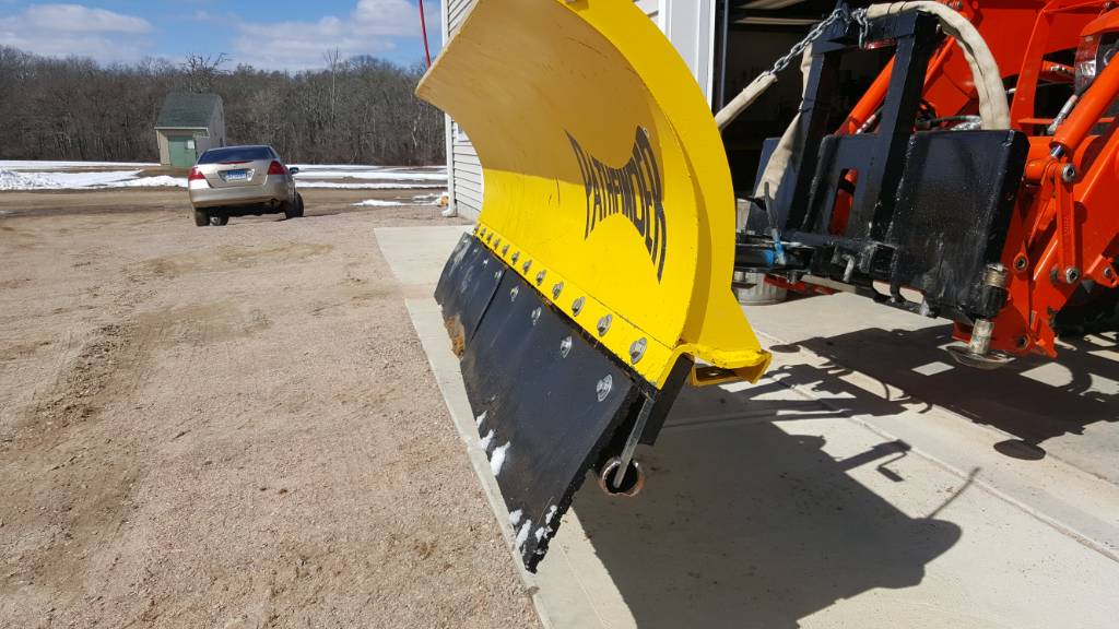

Ok.... What is the best (easiest) way to split a pipe to put on the cutting edge of the blade?
I got a short strip of thin wall cut & mounted but it didn't last.
PVC is broken & gone before I get to the end of the drive on my first pass.
In my experience ABS pipe lasts most of the season on my ATV blade, PVC broke the first plowing. I guess PVC doesn't like the cold. I use the ATV until the ground freezes, it takes a little longer to plow with it but my gravel doesn't end up in the berms. I've been meaning to try ABS on my tractor blade.

I plow a very large commercial area that is all dirt and can be very soft before it's frozen. Slotted pipe worked just okay. Plow was heavy enough to still dig a little. Also, the pipe seemed like it was wearing pretty quick in the abrasive dirt - even though it was very heavy walled pipe.
Stall mat bolted over the cutting edge was my solution. About twice as tall as cutting edge. bolt it on so half hangs beneath the edge. When you plow, it folds under and the blade rides on the stall mat like a flying carpet. Not perfect, but works really good - much better than the pipe.
I really like the angle iron idea. I may have to try that!
