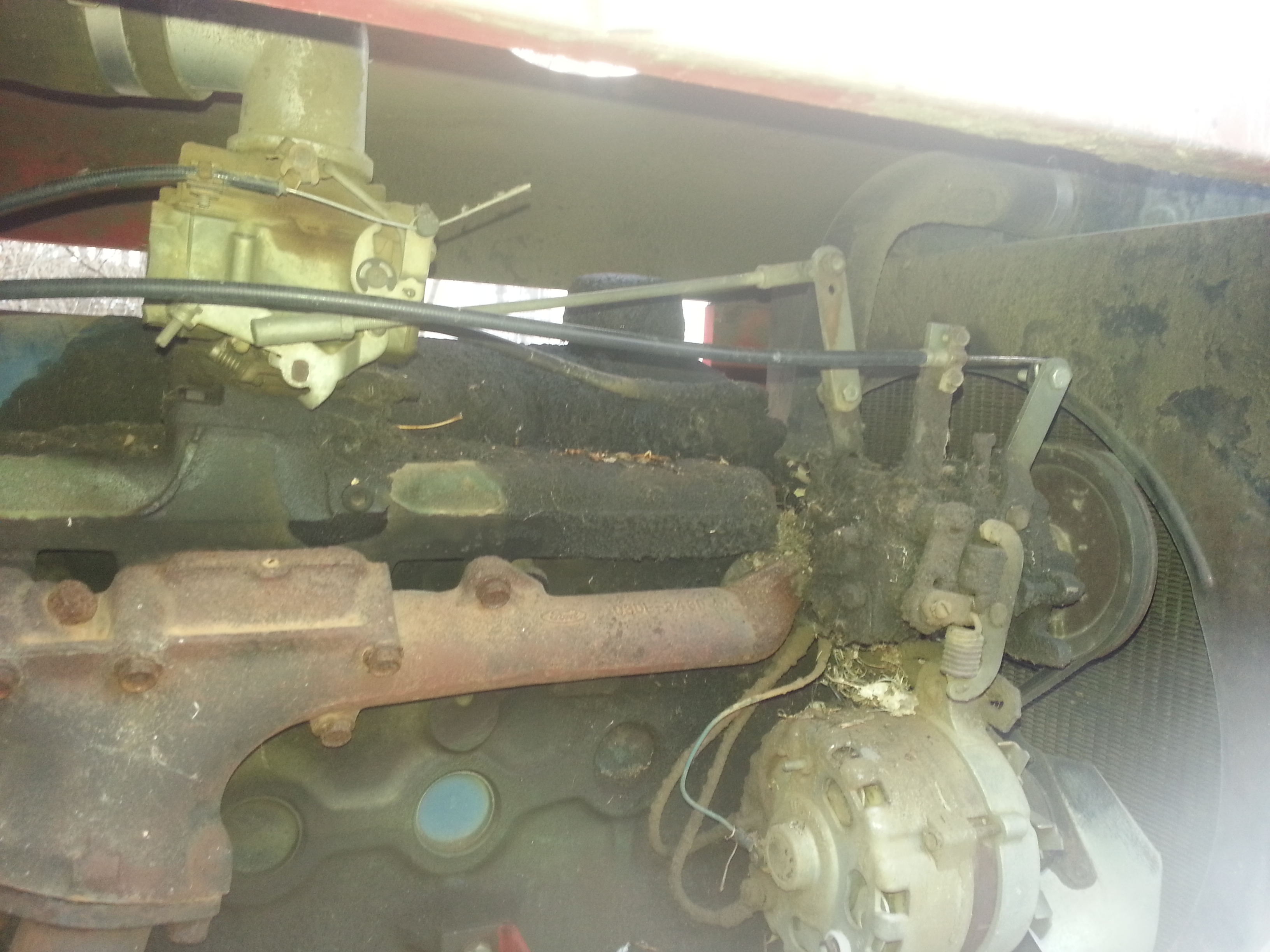

This would be another way of adding a governor. I'm pretty sure that this is what one of the previous posters had in mind.
The external governor is above the alternator in the picture. The throttle cable is attached to the governor and then there is a rod from the governor to the carburetor.
This is on a Versatile swather with a Ford 200 engine.
/ Snow PUMP #150
The old gravely's had a setup like that also. It takes some fiddling to get them to run right if they are messed up.
