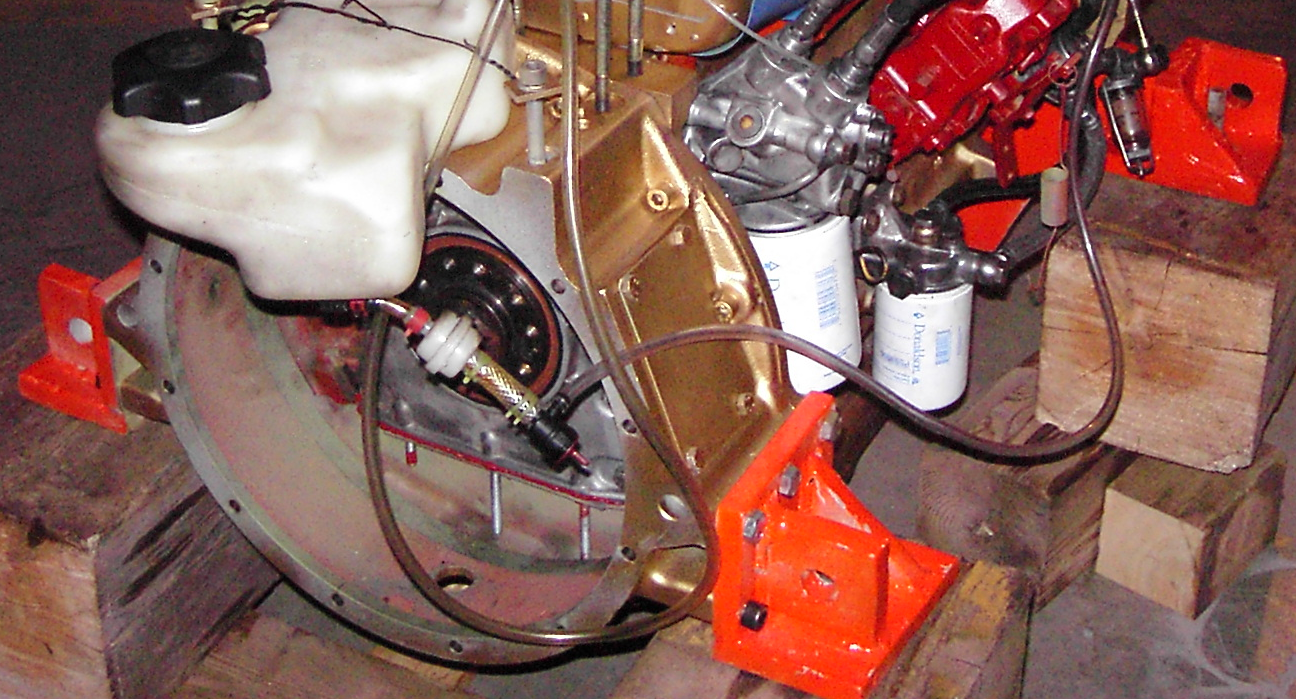

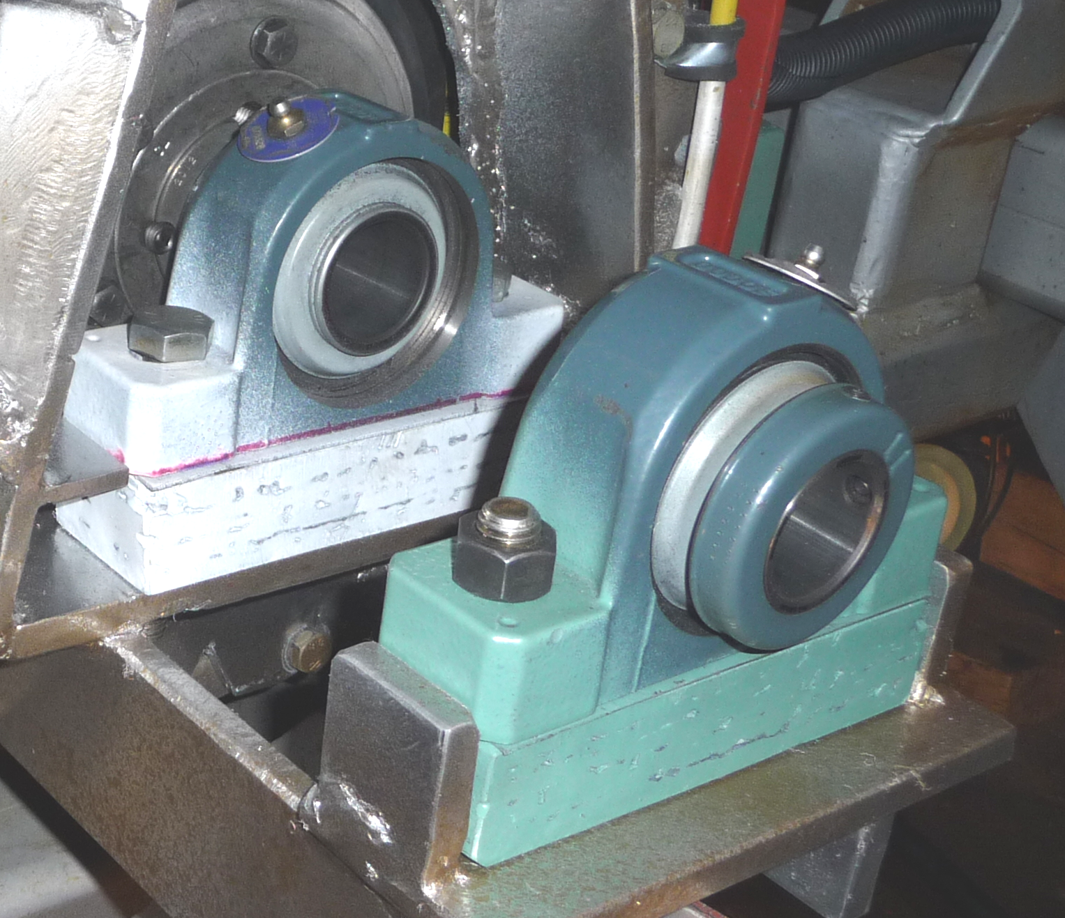

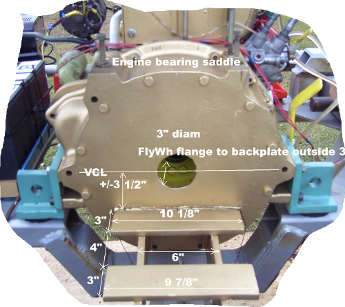

As I said my knowledge of engine-adapters is a subzero abyss even on the kelvin scale :laughing: I am slowly learning however, for example these flywheel plates are called "flywheel-housings", and with that covered if I read you right then I might even already have exactly what I would need in such a scenario. It's something I'll have to clarify in due time. Meanwhile I found out that the part # for a housing like the one in your #108 is probably 3925223.
Here a few pix including one I just took and some from 2008 of the side-mounting deutz flywheel housing
2017-02-28-uper-bearing-saddle.jpgbellplate-bearings-3456-crop.pngrear-saddle-500.pngredone-rear-01-crop.png
Meanwhile I've turned my 6bt with the starter and heard no catastrophic noises. It'll take me another week and a half to have the stand ready for the first a start attempt.
