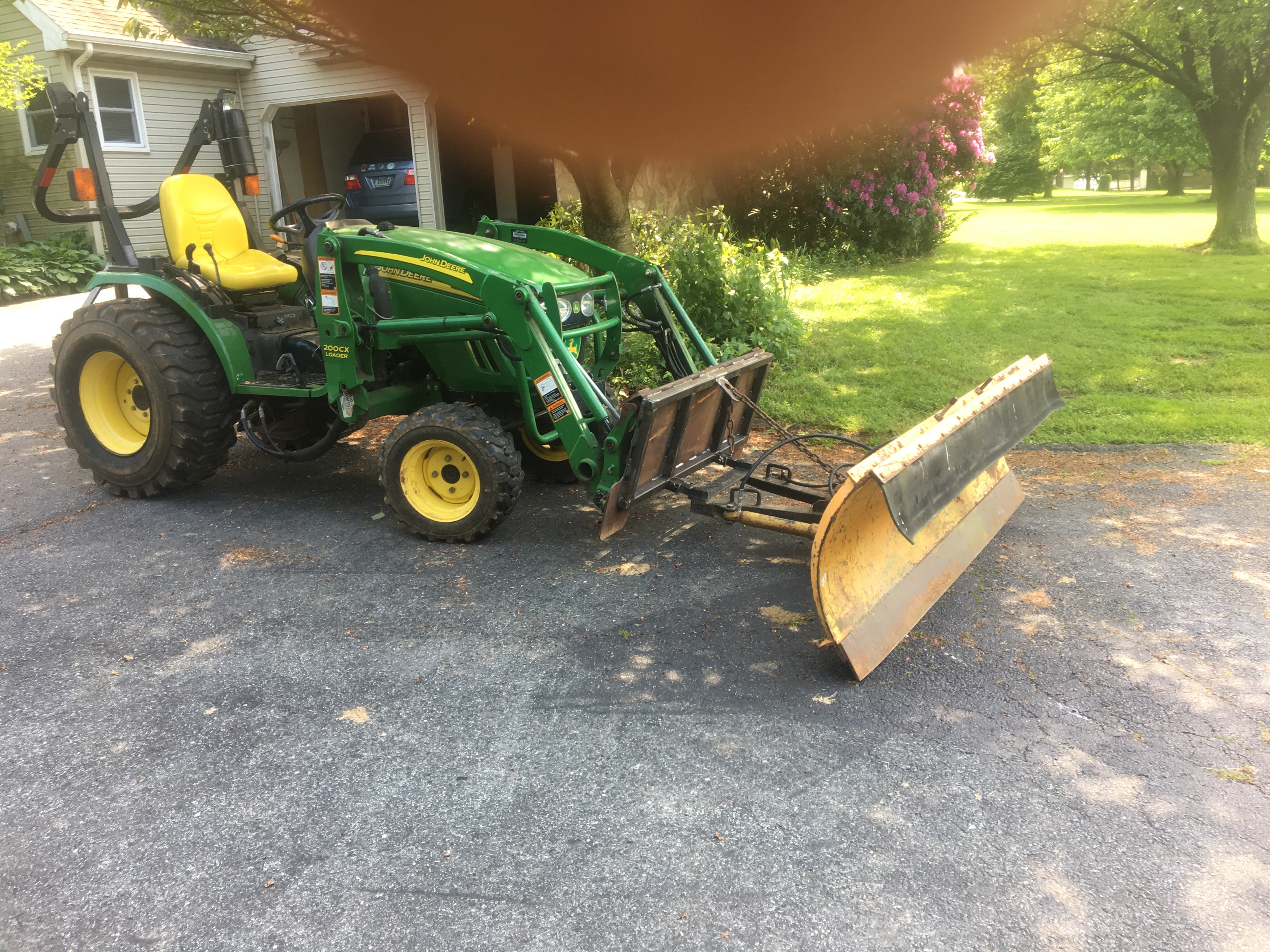

I have been accused of overthinking my snow removal equipment for this location. My solution is a 6.5’ plow adapted the jd quick attach loader on my 2520 tractor. A strip of rubber horsestall mat (tsc) and hydraulics off the loader remotes for power angle completed the project. Your tractor should handle a lot more plow! Good luck. View attachment 635920

Like I said in my earlier post that you quoted, we do not have to plow all that many snowfalls each year. Probably an average of 4 per year and I usually do my own and a couple of neighbors. Figure 12 drives at about 200’ each per year. The 6” strip I used for my back blade was still on it and usable when I sold it after 7 years of use. When I fabbed up the front plow I used 6” strips from the original mat. After 2 years they are still good as new.
YMMV!
Frank

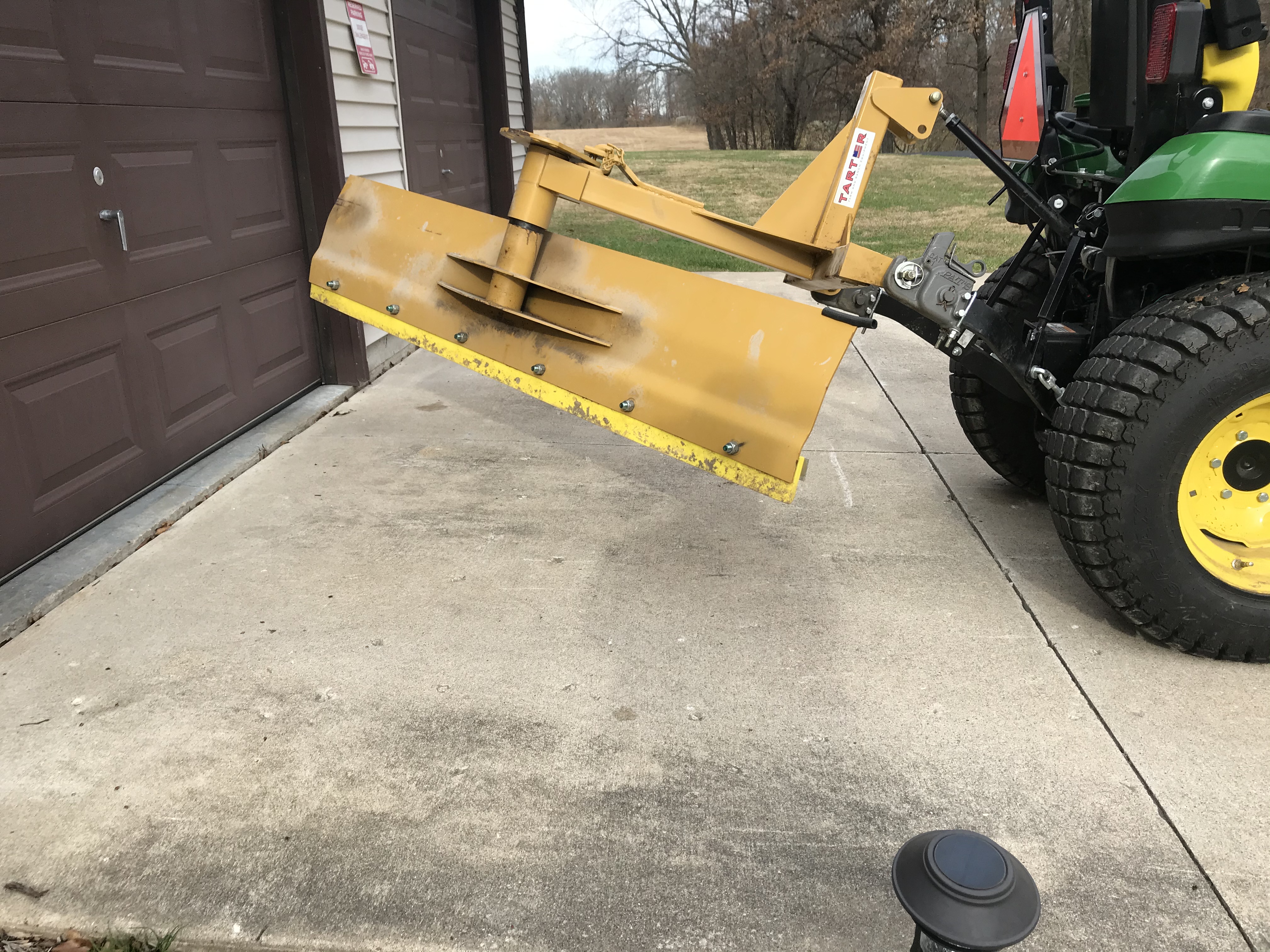

I think I got my edge off of Amazon. Here is a pic that sort of shows it. I took off the cutting edge and mounted this.
/ Snow pusher #24
Have a look at the thread”Rear blade rubber cutting edge” here in Snow Removal. Used tire tread will last longer than you will.
