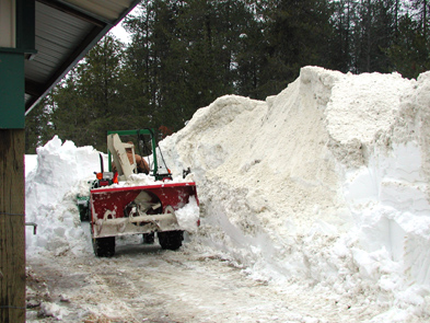

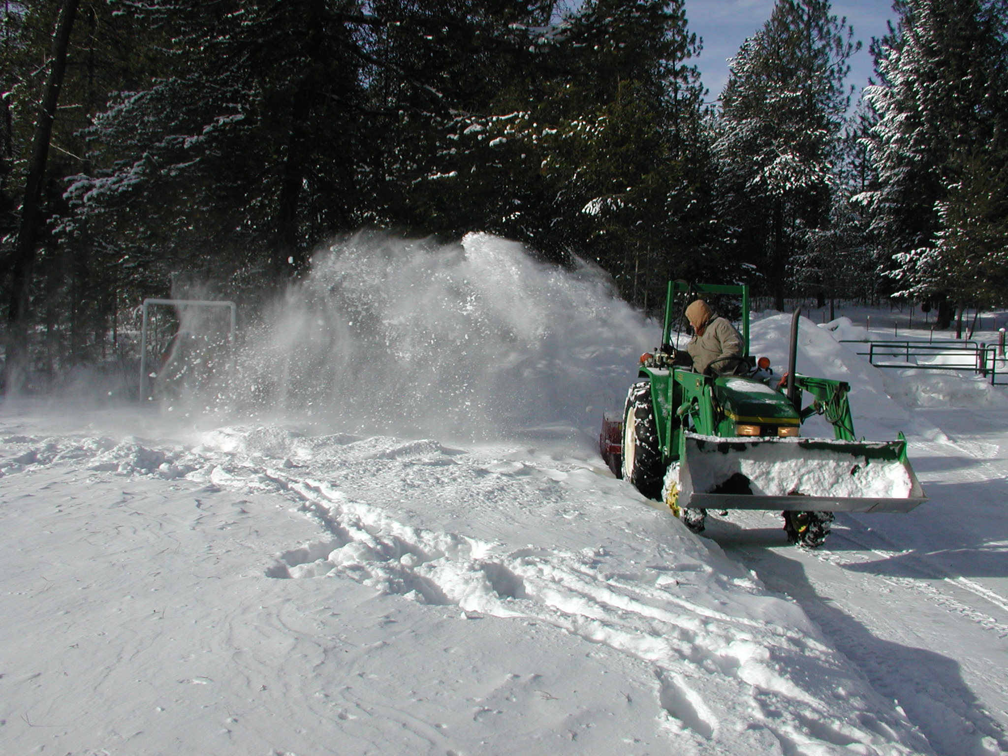

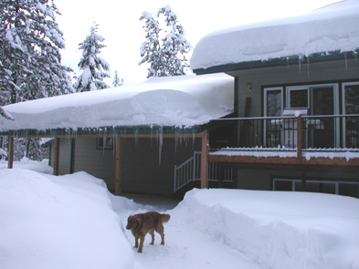

I'm not sure why anyone would say a blower wont work in 3" of snow. Mine work thru 2 feet of fresh snow. I have also watched alot of people using loader mounted plows over the years, and no one has ever bent a loader arm that i have met. I have a new loader mounted plow for my rig. Heres a pic of the snow i move regularly with my blower. Also, all my roads are gravel roads. Just get rid of any large rocks. Small pea gravel and slightly larger gravel poses NO problems with a blower unit. Best to add hardened shoes to the unit to leave about 1" of snow on the ground, as this will help prevent gravel uptake by blower.
