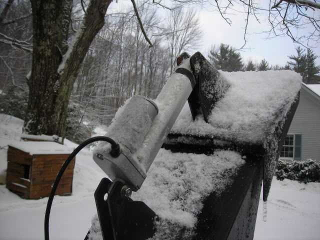

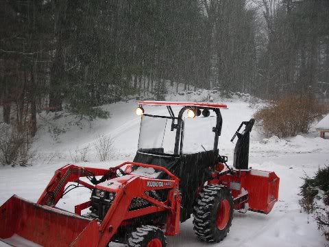

This is how I did my electric rotator. (Next come the deflector.)

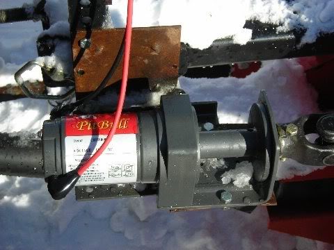

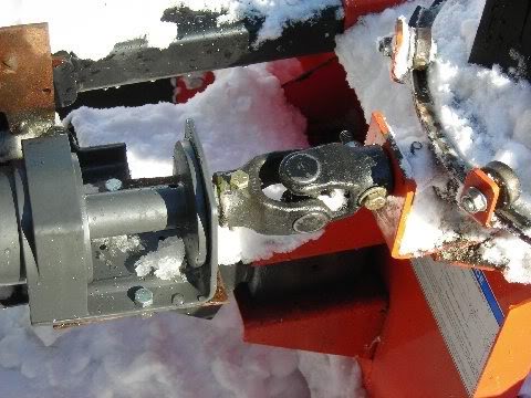

My past snowblower was a woods ss-60 and I added a chute rotator using a Harbor Freight winch and mounted a shaft to the end of the winch that connected up the the chute U-joint. This work great for me and I also added a linear actuator for controlling the deflector too.
I had a 4 linear actuator that I used but thing a 3 travel one would work better. As for the winch hook up it is straight 12 VDC operation and I used the controller that came with the winch. One problem with that is the controller is not weather proof and the first one got wet inside and the controller was history.
Much to my surprise HF had repair parts available and shipped one out quickly.
The Woods snowblower worked fine for a number of years and I ended up selling it to a friend who is still using it with both add on items. I now have a front mounted snowblower and will be adding a linear actuator and a hydraulic chute rotator.
This will permit me to use the FEL control to do the rotating and lifting of the snowblower.
Wayne
