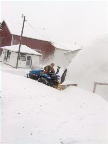

snowblower1.jpgForce feeding my Lorenz blower.

I saw a used woods blower before I bought my lorenz and noticed the impeller was about the same diameter but the blades were not very wide. My blades are 2 to 3 times wider(deep).
The Lorenz can blow snow great but it really eats HP too so you have to be careful on how fast you feed it.

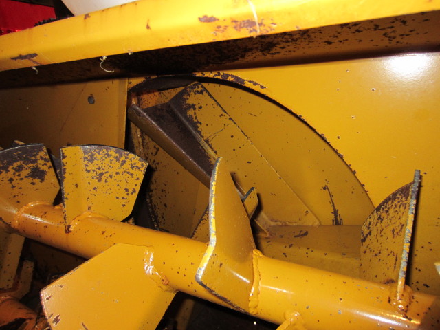

I looked at this closer today. I think the owner really chewed this thing through rock because I got one fin totally flipped the wrong direction and a couple other one are fairly flat instead of cupped in the direction of throwing snow. Out of four fins one is properly positioned.
I guess this explains a lot and also give me an item to really look at if I find a used one to purchase.

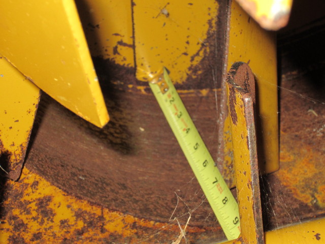

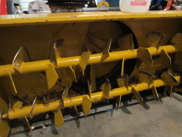

My impeller is about 25" dia and the 3 blades are 6.25" deep.

Since you stated that it looks like your neighbor has been through plenty of rocks/gravel I can pretty much guarantee the lack of performance is from the fan blade tips being worn down causing the gap between the fan blades and the housing to be too great and allowing snow to pass through.
My 64" Ber Vac has the same issue. I solved it with this kit. SNOWBLOWER IMPELLER KIT

If it wont pick up a dime on the up stroke of the fan? Then the impeller wear is the problem. Only fix is to have it rebuilt and balanced. Or some guys will bolt on 3/8 thick rubber pieces to individual fan blades in order to compensate for the wear. That ones a cheaper fix, and, will probably have to be replaced yearly.
