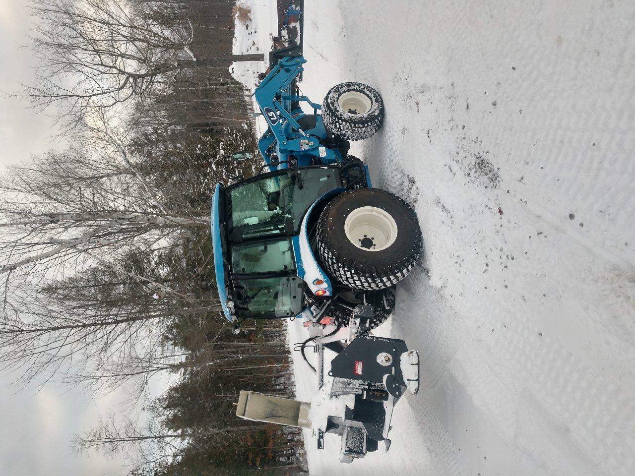

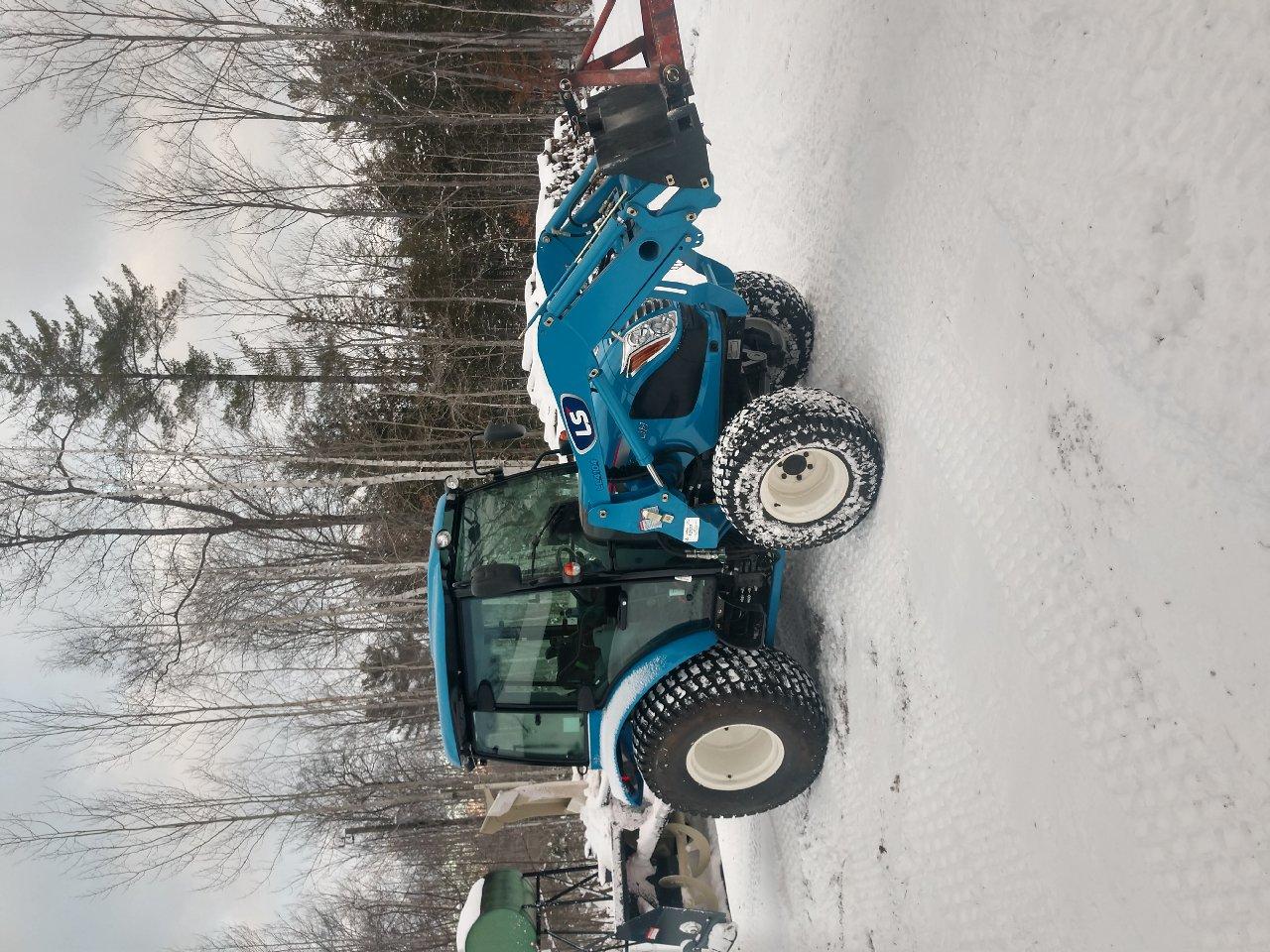

Thanks Yooper.

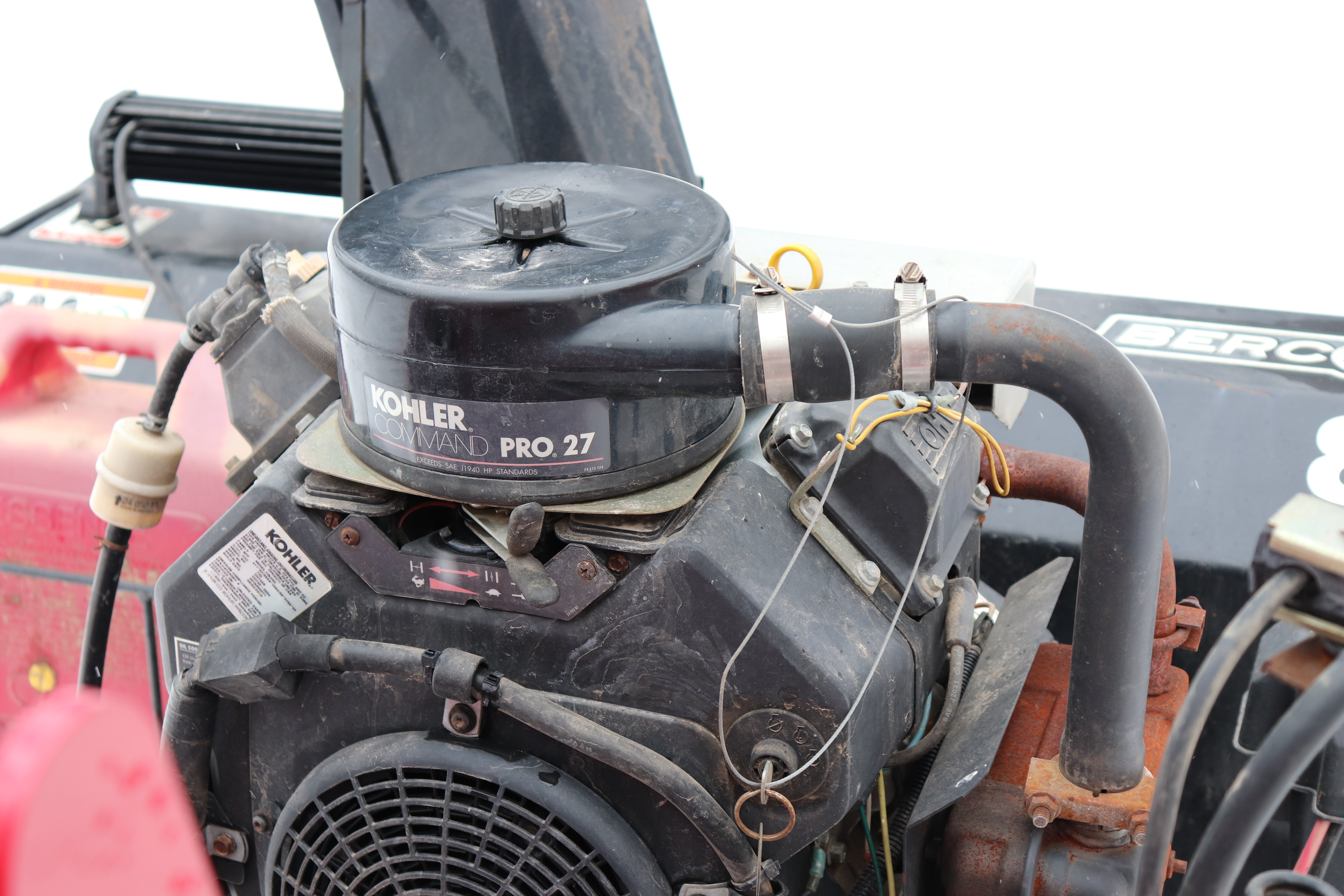

Self powered blower? Is that a Kohler engine? What hp? Not out of the question but I haven't seen anything like that for sale. What brand is that, can't make out the name on top of the blower in pic #2. I get up your way two or three times a year, not usually in the winter though. If I should head your way in the next month or two I'll contact you here.
Thanks, John.
John. It is made by Bercomac in Canada. It is the 66" blower, they make a 72" blower also. Mine has a 27hp. Kohler on it. This thing really works great and has been pretty much trouble free for the last 3 years I have been using it.View attachment IMG_0666.JPG

What kind of clutch does the Berco use?
   / Snowblowers: FEL Mount vs Rear Pull #26
It uses an electric belt tensioner that is controlled form the control box in my cab. Works great have never had any problems with mine and my belt is 3 years old. I replaced the belt 3 years ago when I do my yearly preventive maintenance in the fall. The old belt looked good but I changed it anyway.

Belt tensioner like an actuator pushing or pulling on an idler? Must be a substantial belt.
