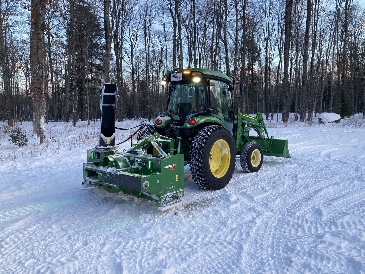

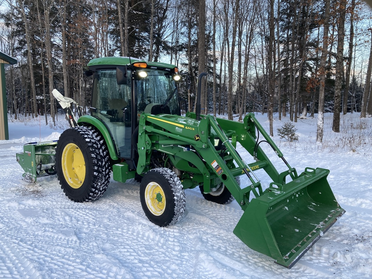

Well we got our first real snowfall of the season, not huge numbers here about 8 inches fell yesterday and into this morning. NW winds to 25 mph with gusts to 40 mph created drifts along the length of the drive way.
The prior light snows amounted to about 3 inches, which I drove over and packed down a couple of days ago so it would freeze and not have the snowblower blasting gravel all over the place. I also added 1.25 inch blocks of poly to the bottom of the skid shoes, which keeps the scraper blade about 1.5 inches off the ground with the skid shoes all the way down. Didn't fling any gravel today.
But all I can say is this machine is frickin' awesome! Made quick work of clearing my drive and the neighbor across the street. The traction of the Nokian tires is impressive too - and they're not loaded.
Other additions include swapping out the stock Deere work lights for the Larson 665's. Put a pair of 40 degree beams in front and 80's in the rear. Dang what a difference! They really light up the night. Pricey, but worth every penny in my book. Also swapped out the stock halogen headlight bulbs for the JDM Astar bulbs the gent on Good Works Tractors suggested. Not a real focused beam, but certainly more visible to on-coming traffic when you're out on the road. I installed four Feniex Fusion amber strobes on the cab and two of their green strobes on the back of the snowblower. While I had the roof off installing the Feniex strobes I also ran a back up camera to the bracket on the back of the cab, as well as a custom switch box. Works real nice to keep an eye on the blower without having to turn around constantly.
Really nice rig. If I had to go up, that is what I would have.
